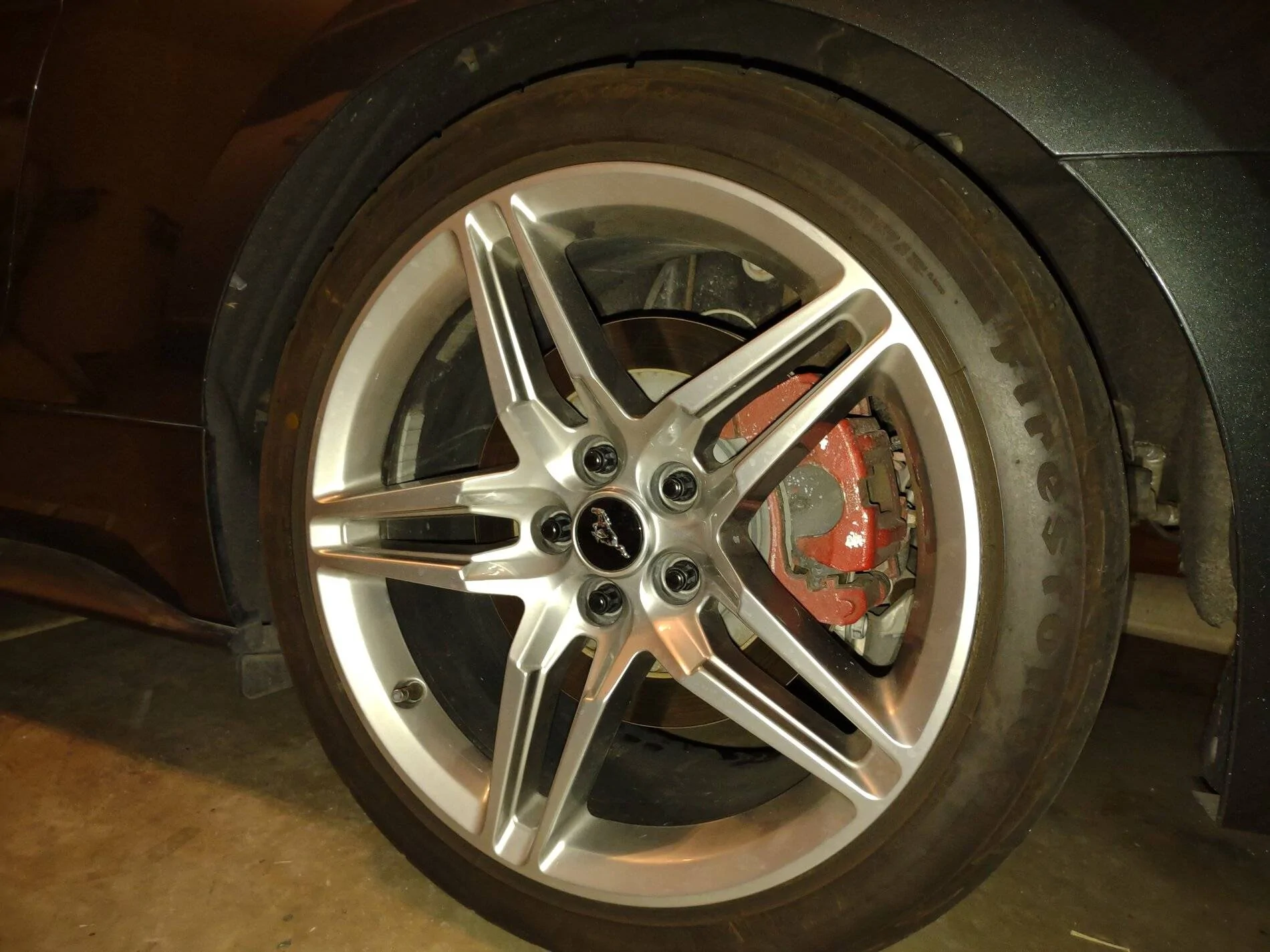

Never really got a straight answer as to when I should make the change from Fire Hawk Indy 500s or what to change to.
Regardless, where do you guys read good reviews? I'm tired of the "took the car to 7/11 and it rode good" type of comments.
I've seen people at the track swap perfectly good tires just to try changing steering bias. I wanna pick those guy's brains and see how you come up with so much tire knowledge.
