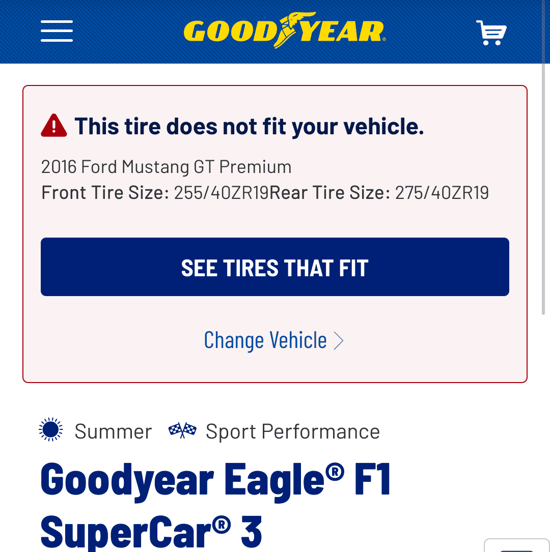

Goodyear Super Car 3 does not fit Mustang 2016.
What size(s) are you looking for? 3's come in PP sizes as well as other sizes that are 285 or wider.
If you're talking about the 3R's, you'd be on the hook for wheels as well, but it'd still be do-able.
Yes, they absolutely do. As long as you buy the right sizes, literally any tire will fit. I have them in 305/30/19 as my track tire right now with no issues. They are the OEM tire for Camaros and the two cars are pretty darn similar.
Also, I did not include Indy 500's and Michelin PS4S as neither are viable track tires. The PS4S are OK for a complete beginner but they really don't have much lateral grip and get greasy fast. The Indy 500's have even less grip than PS4S
The Goodyear website said it doesn't fit me and the same goes for the tire shop in Costco. Firestone said they can get their hands on any tire for me.

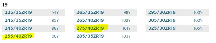

These are the sizes in 19" for the Supercar 3, straight from Tire Rack. These are the exact OEM PP tire sizes........use common sense and logic rather than believing what other people tell you.
