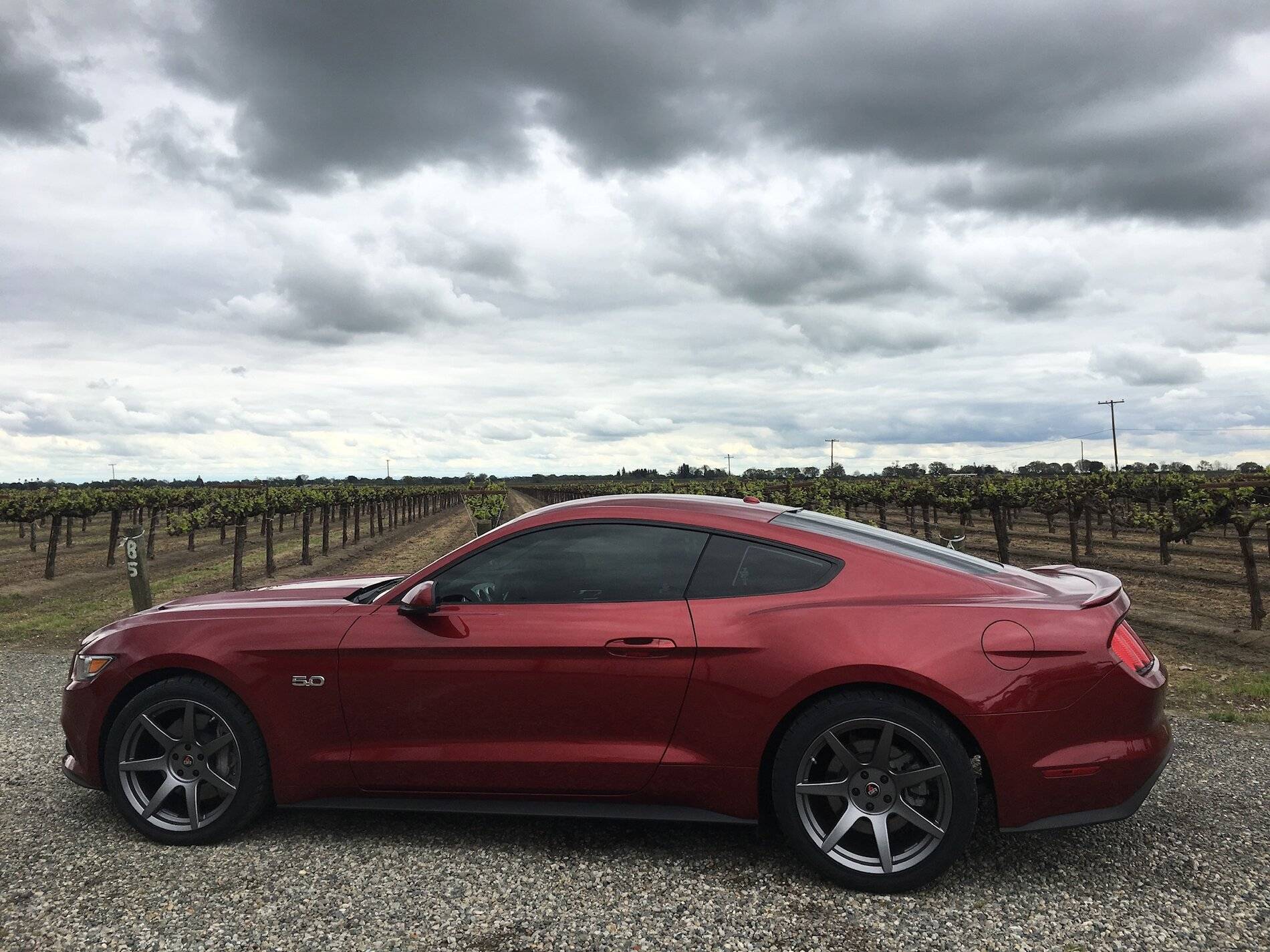

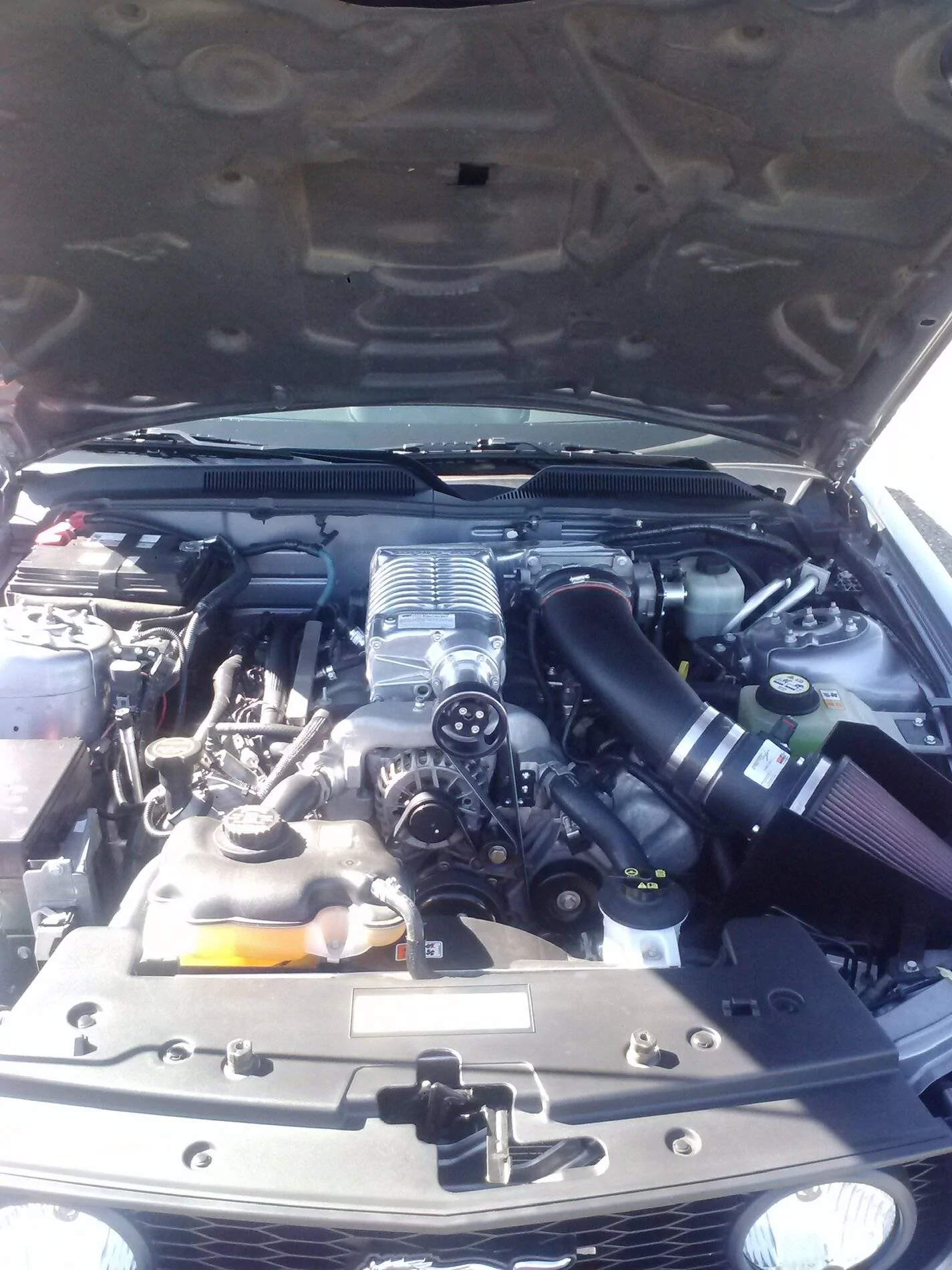

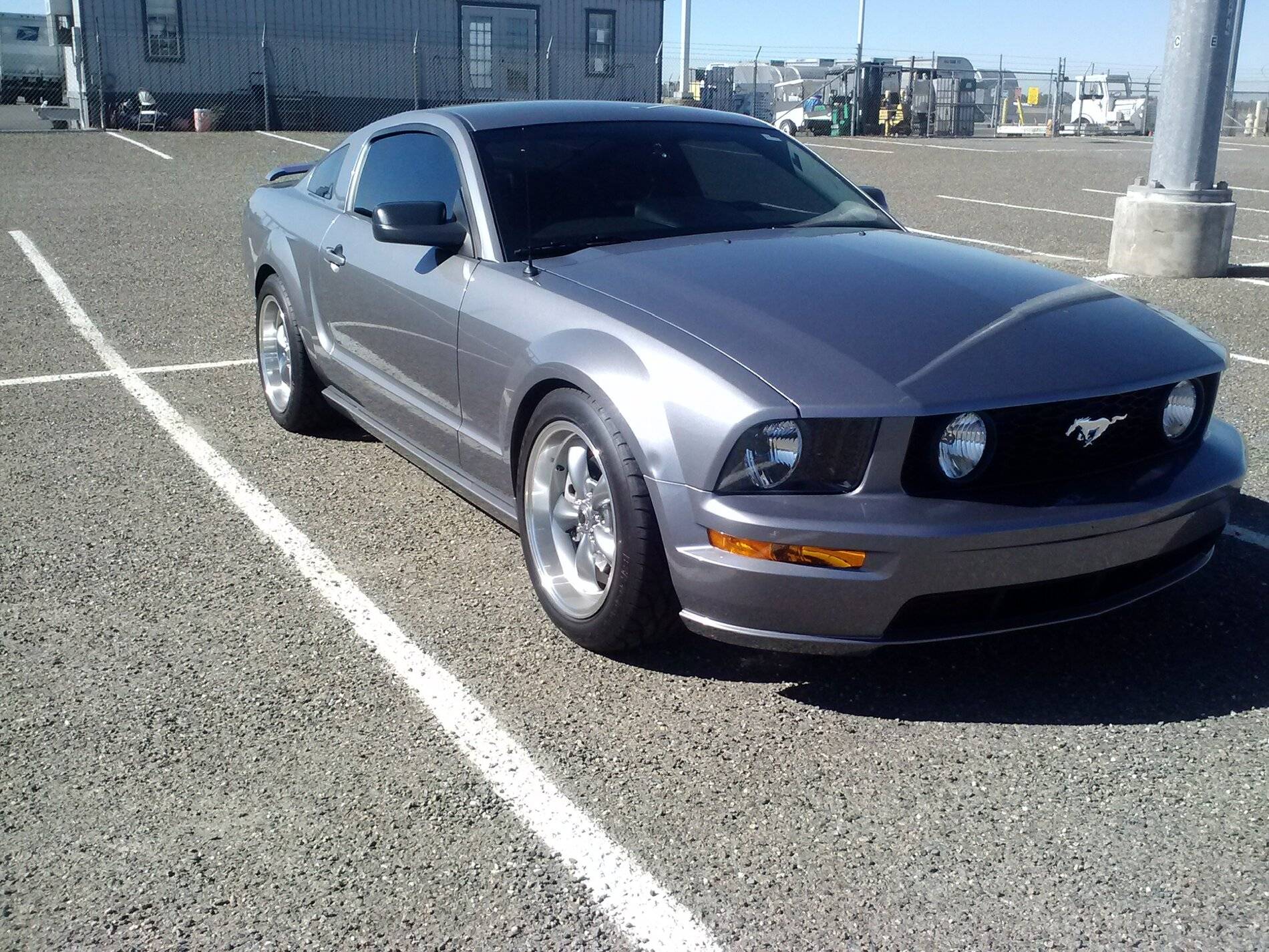

I’m not looking for max HP , I would be happy with 600ish whp, just something fun / reliable to drive. The mustang is not a daily. I’m not worried about really cold weather living in Sacramento. Although it does get hot so would definitely like to keep the car on the cooler side. Here is a picture of the 2017 and the 2006.

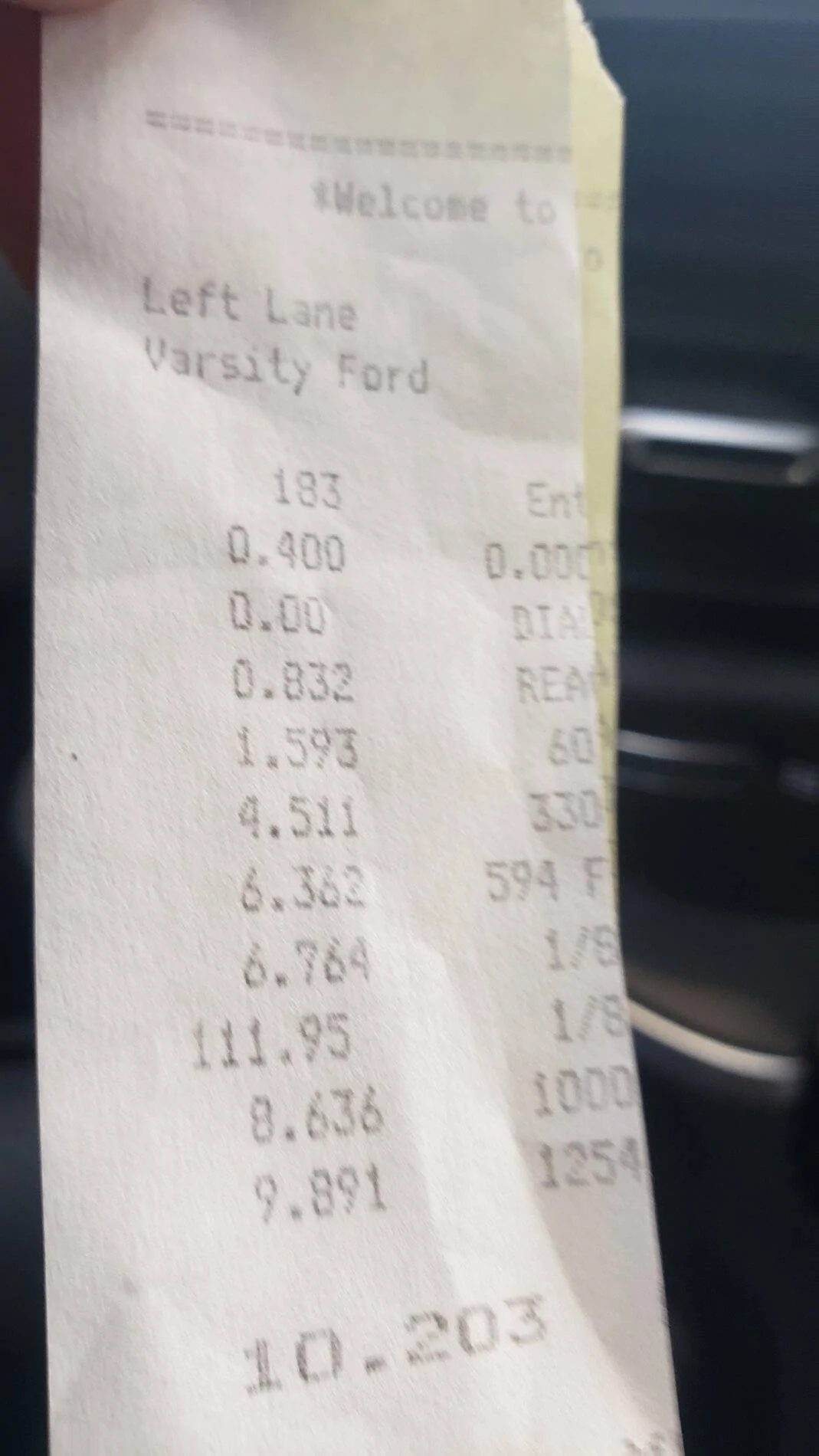

I had Paxton’s on my 2011 & 2015 GTs. Good solid kit. If I had to pick one thing I don’t like about the kit. It was that the overflow bottle mounts right over the left bank of spark plugs. As for how fast they are. I never lost to anyone with another brands kit on their car.:wink:
BL fabrications makes a catch can/over flow tank that mounts on the drivers side. It's really nice and cleans the engine bay up. I have one for sale for the Paxton/Vortech kits..The Paxton cannot be beat for price and performance. Heck of a bang for the buck. Easily take the car bottom 9's

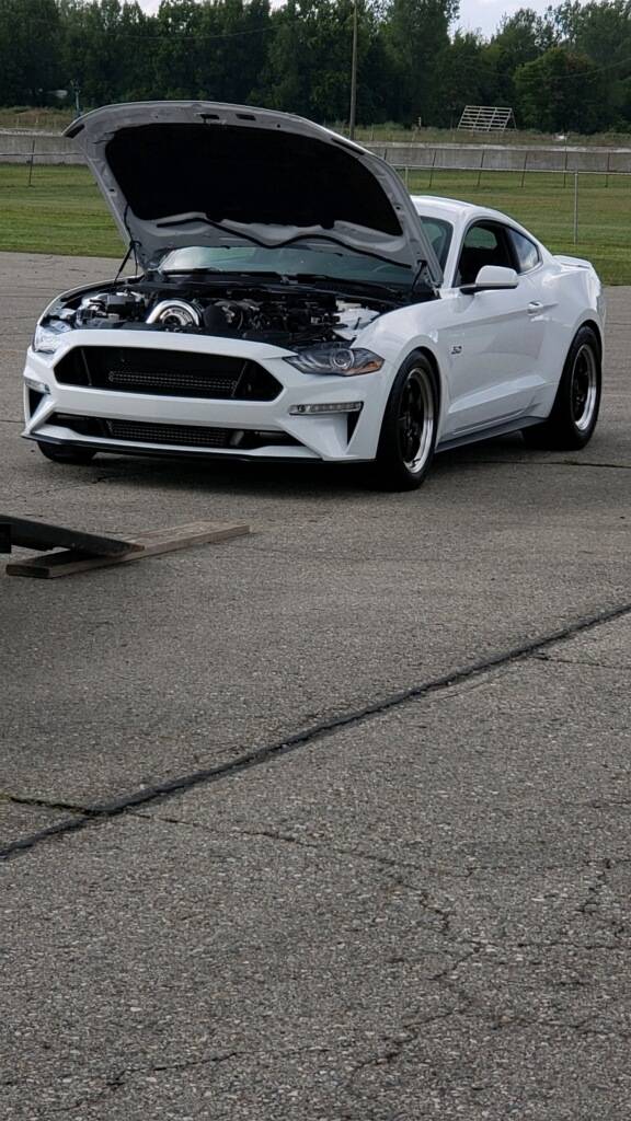

I installed a paxton 2200sl on my brothers 2019 and a Vortech v3sl on my 2019. Both being the exact same and were definitely not "Hard". Truthfully moving the radiator bracket and trimming the radiator closeout was the only real "fab" work. I would say everything else is basically the same effort as the procharger - but I have never installed a PC either. Also, truth is you would have to remove the supercharger to change belts BUT, Schrader Performance sells a cheap and easy bolt kit that allows the vortech/paxton users to change belts very easily. I used the kit and can change belts/pulleys just as easy as the PC guys. The AC lines don't need to be "bent", just slightly repositioned. Again all very easy and certainly nothing to stop me from using a Vortech or Paxton again. I have zero experience with a PC or other SC but I am very happy with my vortech. It breaks a lot of hearts on the streets.
