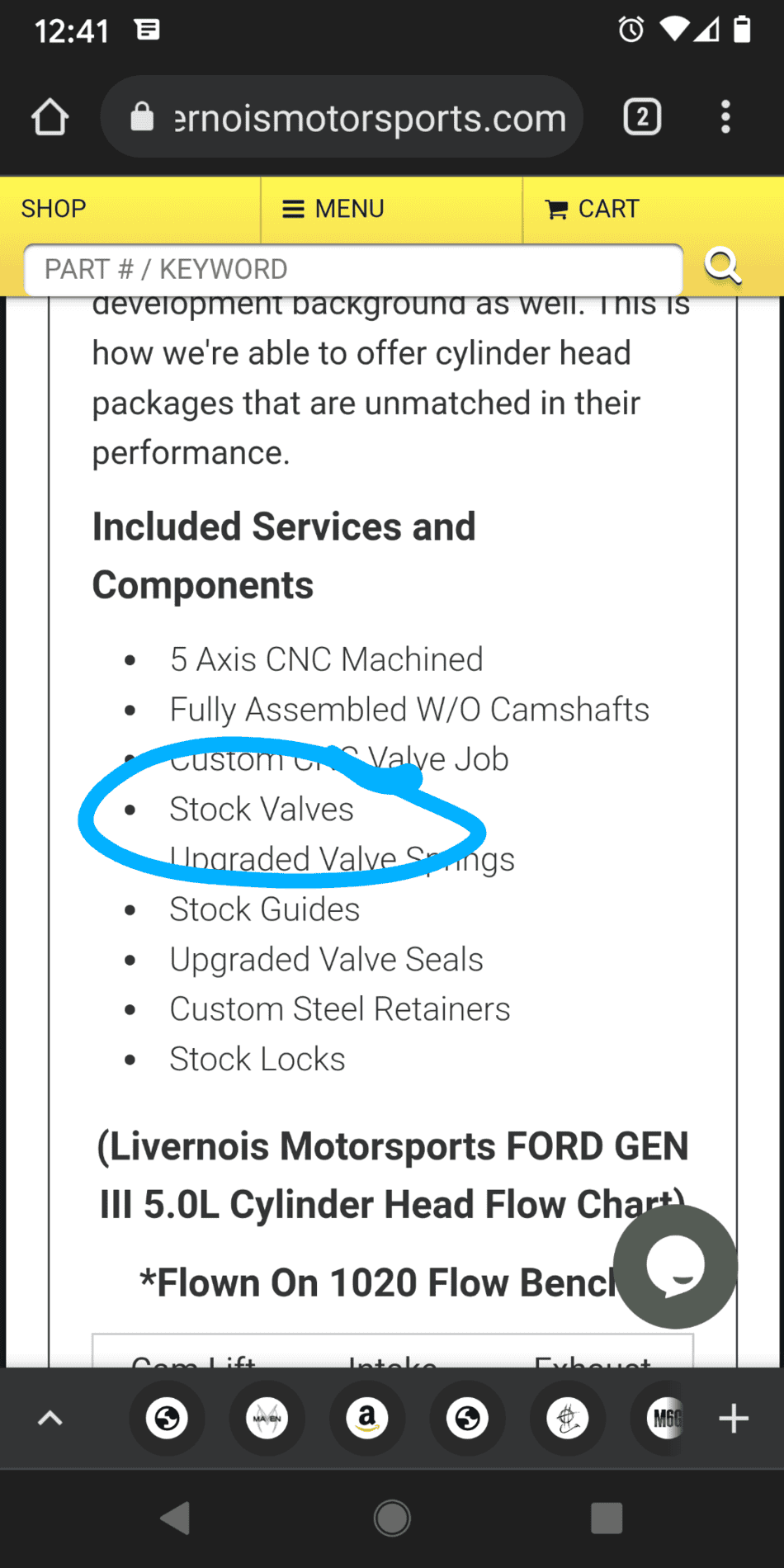

therein lies the dilemma..I was considering a better intake, maybe a better intercooler, valves for sure.
The link that you posted earlier included stock valves. The additional cost for aftermarket valves is substantial. Factoring in the cost for valves, new guides, valve seats etc. The additional cost for porting at that point is minimal.
In a situation where you are buying heads as outlined in that link that utilize stock valves, you are paying an absolute premium for the porting....
Yes they did, probably why they are cheaper than some of the other options I've seen. In the little research I've done on here (FI section), it does seem most recommend better valves.
From the link in your original post...
