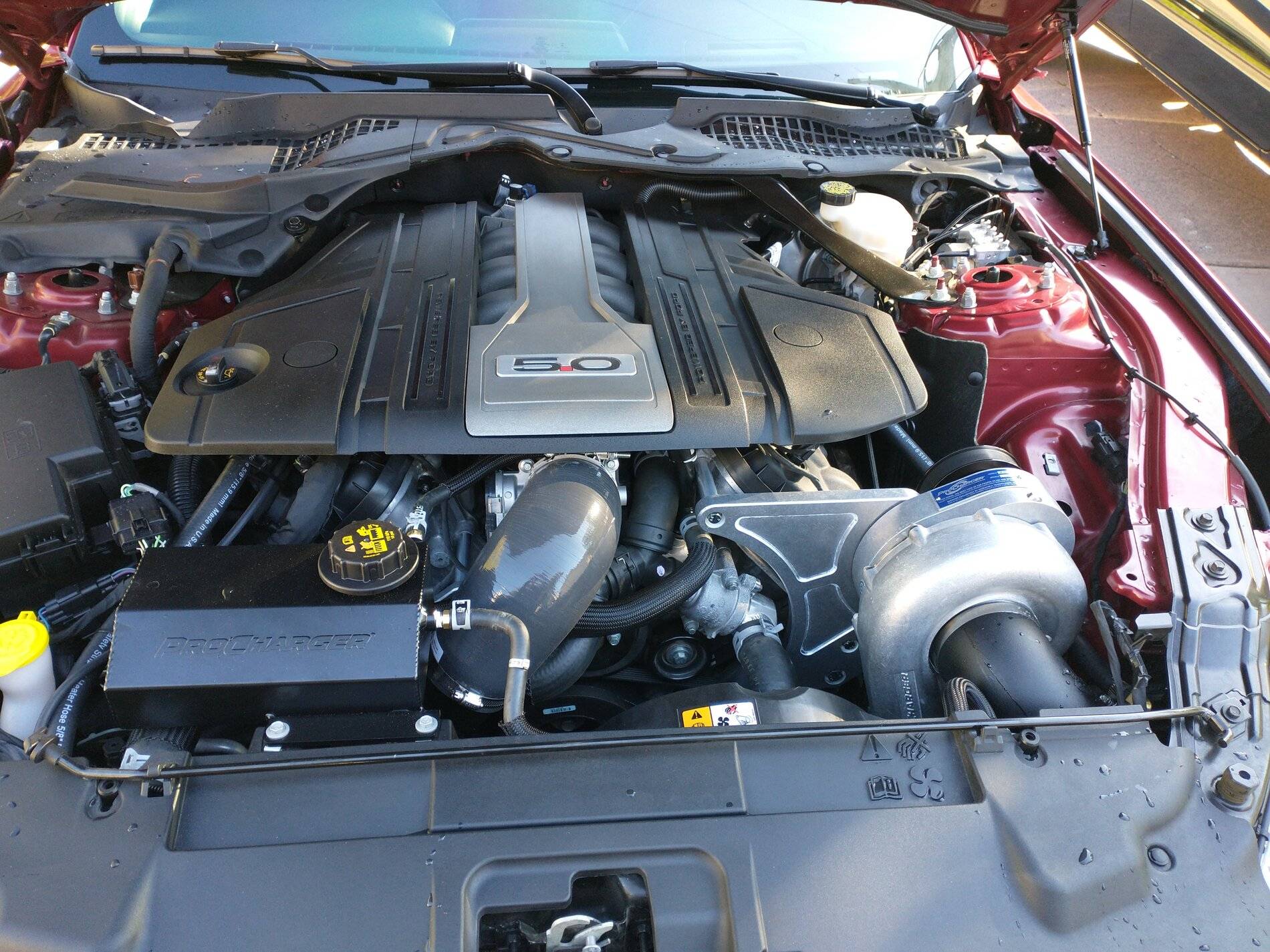

Here is the ProCharger. It sucks air from the fender well area and then forces it through the air to air intercooler into the engine. In regular driving the iats are about 6f more than the ambient temperature. After several full throttle runs never more than 15f warmer than ambient. I don't know about Paxton or Vortech as I did not have it on a gauge then. But much cooler than my Whipple or Roush. Note the belt/pulley location. Super easy to get to.
