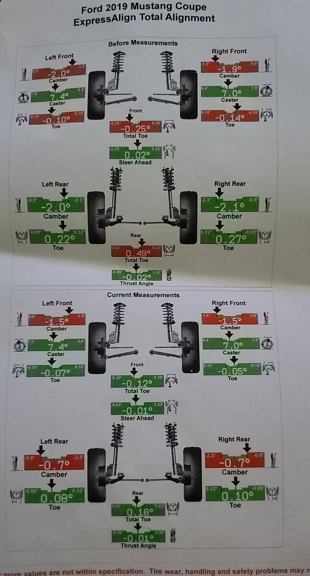

Had my car dropped an inch with steeda springs. Had shocks/ struts changed, camber plates added, etc..
The place I went to is well known around here. He said he likes to max out the rears for better traction. Said as long as I'm not racing taking corners going 100 what he gave me is good for street and what he recommends.
Only problem is now I have some wheel poke with my spacers, but am getting new wheels and plan to ditch the spacers.
The before specs were off course after I had the suspension changed so my fronts were definitely off.
I don't even know what steedas recommended specs are.

Unless this is a drag focused car, I'd get another 0.7 deg of rear camber added. The rest looks fine.
Iirc there is a reason we want more negative camber or at least the same as the front with an irs. I can't recall why though. Thought it was something with high speed stability like if a sudden lane change or turn had to be made etc.

When the car rolls, the tire loses more camber than it gains via the length and angle of the suspension member-determined geometry. This means that you need to have a decent amount of static negative camber to avoid going into positive camber during roll. If you don't have at least -1 deg (-1.2-1.4 better) you'll get into positive camber just in somewhat spirited driving. The consequence of that is usually much more unpredictable handling as you're rolling onto the tire sidewall.
For handling applications with grippy tires, -1.8-2.0 deg is often typical, as the level of grip and body roll is higher, in addition to the fact that tires produce more lateral grip when they have some negative camber angle with respect to the road rather than zero.

For street driving
As brian said
Little more camber in the rear.
Note
Toe is what kills tires.
I would reduce overall toe if is street use only

Thanks everyone. I ended up having to take my car to Steeda because of a faulty camber plate. They did a realignment alignment there for the front.
