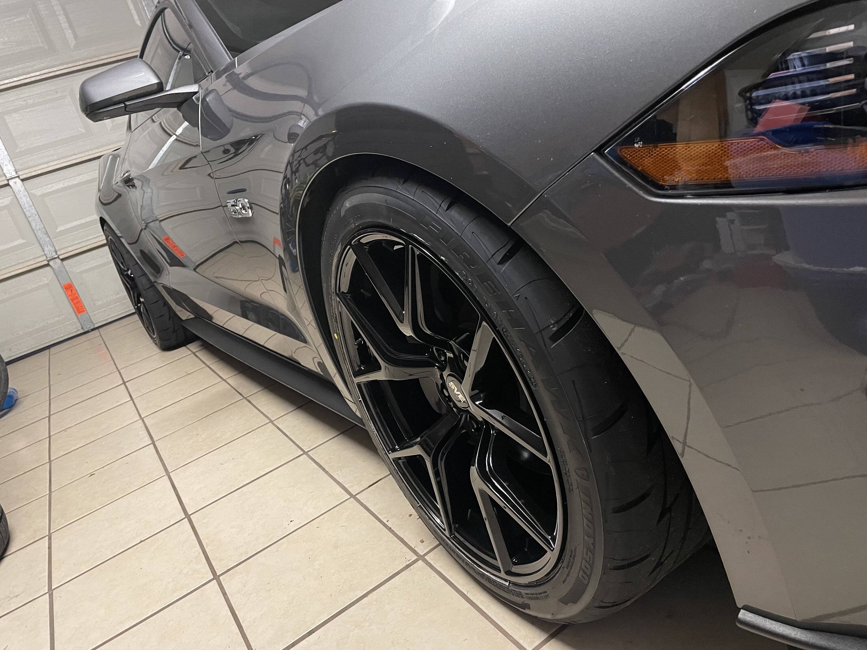

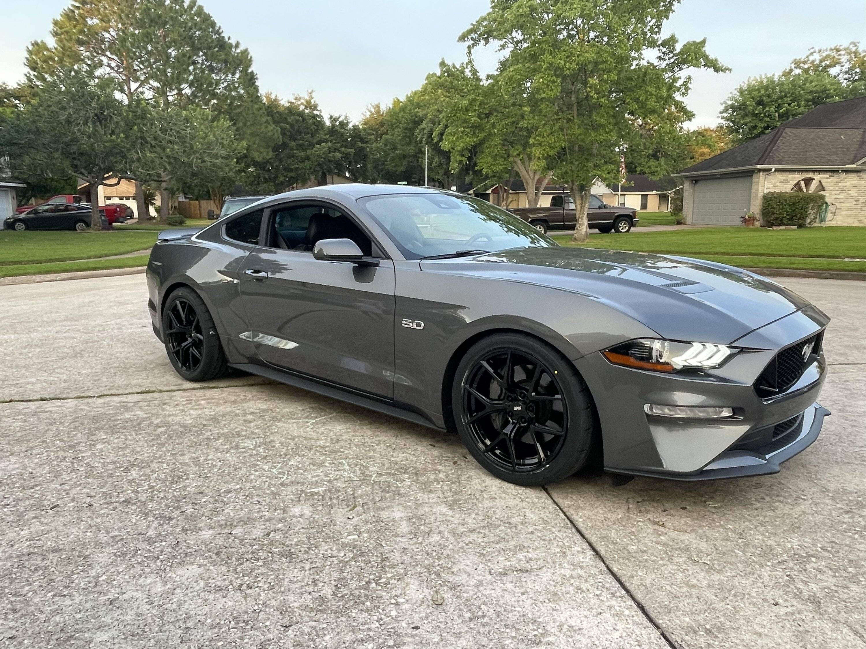

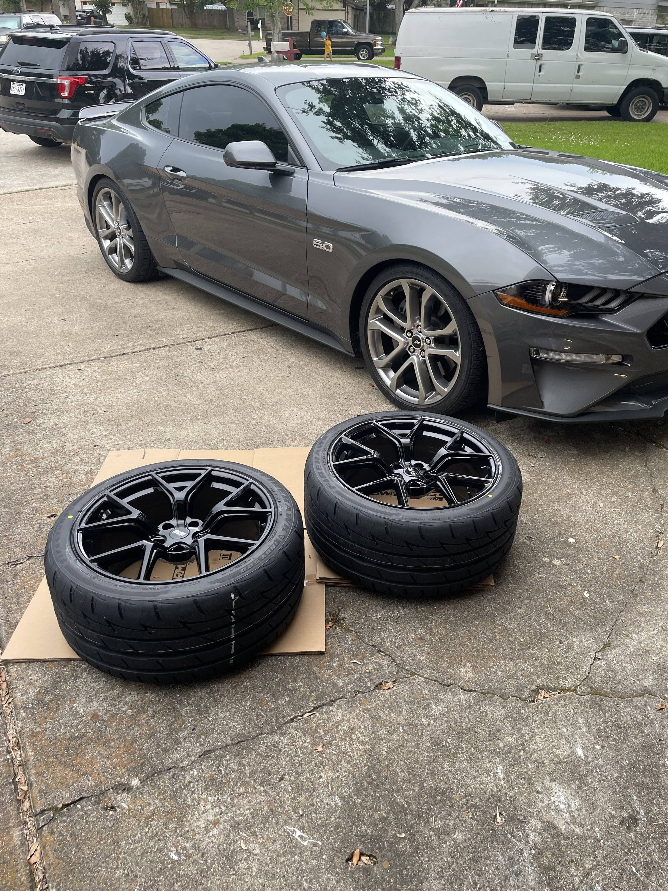

I did the Steeda progressive springs back in April and it affected the camber. I took it to the alignment shop yesterday and before they started the fronts were at -1.8/-1.9 and the rear was at -2.2. They were able to get the rears to -1.5 but couldn’t do anything with the front. My SVE PP2’s also came in yesterday, so I put those on.
I’m fine with a bit of camber as this isn’t a daily driver and will probably only see about 6,000miles a year unless I get some long trips in.
The question is, at -1.8/-1.9 will this wear out the inside of the tires to quickly? Will I be able to get 10-15,000 miles out of a set of tires or should I get some camber plates?
