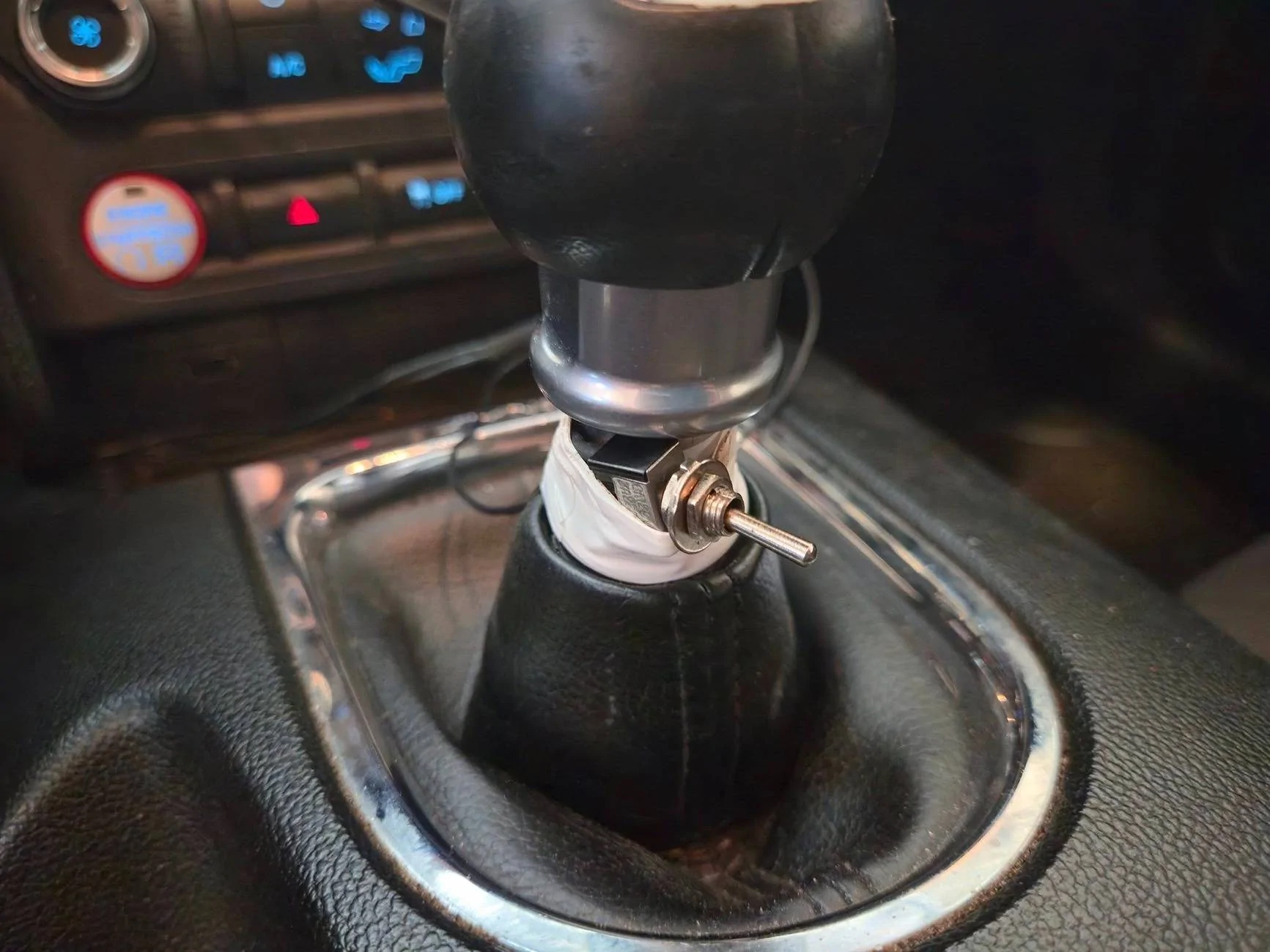

If I had an auto, I'd go fancy like that. But since I have a manual, I'll just mount it wherever it's most convenient.
Most convenient :

Haha. That’s a bit to easy to get too. I’d accidentally hit it and go full crowd mode. I would need it in a covered toggle switch

Really ? Interesting. I heard that was the only way to disable clutch protection. Hence the switch I made.
