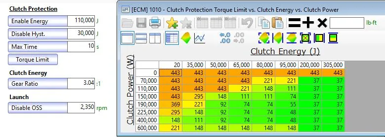

Really ? Interesting. I heard that was the only way to disable clutch protection. Hence the switch I made.
I can't imagine why the clutch protection would be managed by anything outside of the PCM. HPT summarizes them nicely but I'm sure there are dozens more in PCMTec.
The entire PCM architecture is based on torque control and has been for many years, so there is no getting rid of it completely.
The TC/AT are managed outside of the PCM in one of the many other modules, and that part is what the "dyno plug" disables.
That said, there is a "dyno mode" built into the PCM that you can switch on. No idea what it does, though.
