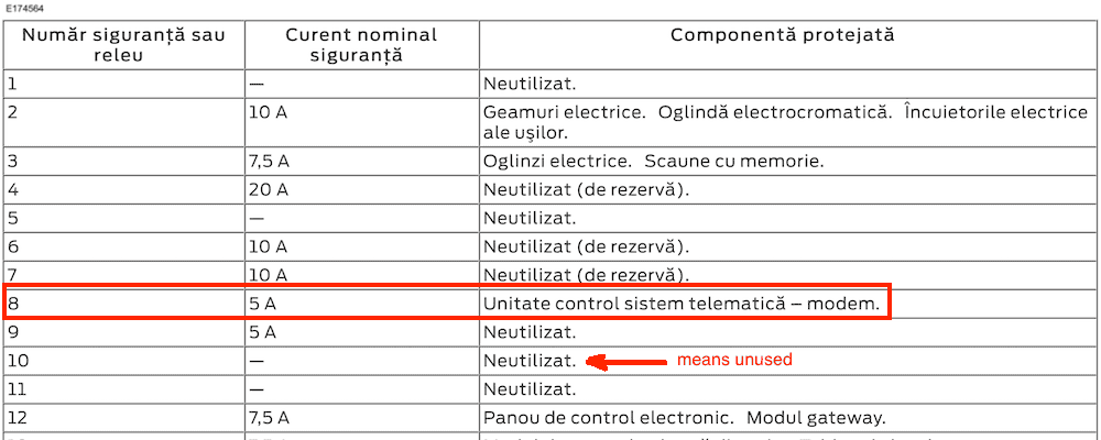

The 2020 GT/EB manual shows telematics at no. 8. You may want to check that, too.
The 2019 Mustang Owners Manual says Fuse 10.
Passenger Compartment Fuse Panel
Fuse or Relay Number - 10
Fuse Rating - 5A
Protected Component - Telematics.

Yes. It used to be no. 10, and in 2020 it was apparently moved to no. 8.
But we don't know when exactly they made the change. It may not necessarily have happened right on January 1st, so I guess it's not impossible to find cars made in late 2019 which have the new layout.
In a 2020, there is no fuse in number 8 and in a 2019 there is no fuse in number 10.

Come to think of it, the change must have happened when they started using the new antenna, which was in early 2020. That would make most sense, considering that the new antenna also incorporates wi-fi and 4G, which the old one didn't, so that looks like the most likely moment for a change to the modem fuse to take place.
So my assumption was likely incorrect - there are probably no cars built in 2019 with the new fuse layout.

I just looked at the 07/19/2020 (1st edition) Mustang Owners Manual and the fuse information is the same as the latest manual. No difference between Job 1 and Job 2.

This is what the manual on the Ford website shows for my VIN. It's in Romanian, but the idea is clear.
I don't have the car yet. Hopefully I'll have it sometime this month. I will come back here and confirm whether the fuse is indeed at no. 8.
