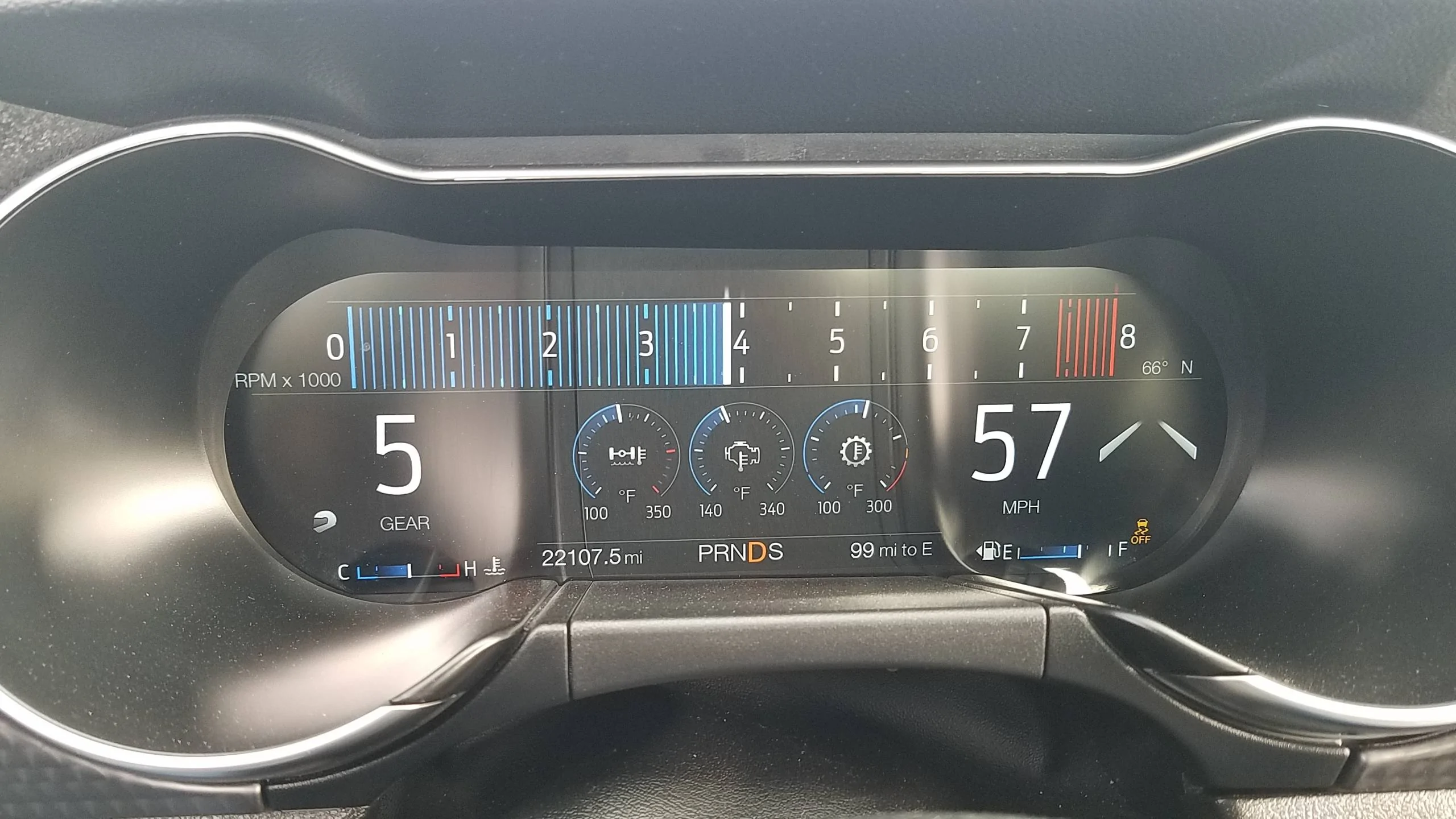

Is your A10 trans getting up to 250? That's pretty hot, and about the temp that is at the colored warning on the gauge in my photo in post #21 above.
But 250F is also the CHT that will change the A10 behavior in order to keep CHT in check. At this temp, you cannot use lower gears because the higher rpm drives the CHT back up. As you have noticed, downshifting causes the gear indicator to flash to tell you it won't let you downshift. High CHT is the situation that most of us encounter first (whether A10 or M6 trans) and so we put in the extra engine oil cooler first.
You can double the A10 cooling by adding a second OEM cooler for under $150. I have not posted a write-up of how I did this yet. My trans temp dropped by 15-20F after this mod.
