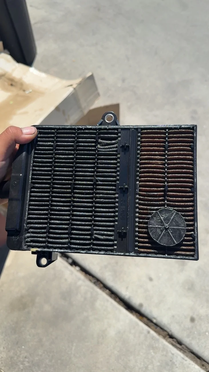

Hello I have a 2019 gt 10 speed with 70k miles I have this weird hesitation on a cold start drive I let it warm up and still does it around 4-5 gear I believe it does like a rev and then it won’t go and take a sec and then catch the gear I only have long tube header and I change the transmission fluid at 60k right when I got the car

What is the transmission fluid temperature when this happens? The A10 can be temperamental until it's up to temperature ☺

Clear the learns on the transmission and go through the learn process.

70 k is very good for longevity, did you check the fluid level per Fords recommendation after changing. Other 2 posts are suggestions to try

Hey, I don't own a 10R80, but i have heard from anecdotal evidence that the clutch packs wear out on these. Since you got yours used, check what the symptoms are for worn out clutch packs. They seem to match what your are experiencing.

this was at 60k miles I got a Lund tune but I feel like the shifts are worst then before

How does my filter look
