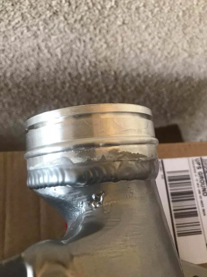

We're developing a few Mustang intercoolers (race and street are coming soon!) and have worked closely this past year or so with a large, well-known manufacturer who focuses on other vehicle platforms. We've seen quite a few examples, but here are some I've seen first-hand:
This one flies around the BMW forums a lot from a manufacturer who obviously didn't list the intercooler in this condition, but the user received it like this:
Closer to the community, this comes from a member on the other EcoBoost Mustang forums in a thread about "super cheap intercooler found":
As I said, I did not have a Mishi on hand to compare in person but I did examine a number of internet photos and videos of the Mishi and the one I got was visibly identical.
There were no welds at the junction you picture, just fine looking welds attaching the tanks to the core and the mounting hardware to the tanks.
Im just a driveway mechanic, but I spent many years racing aluminum bicycles (mountain and road, before carbon took over) and I know what to look for in quality welding work, in an intercooler if they fail I limp home with no boost; on a bike if they fail it could mean death, but at a minimum a very painful injury; I never had a bike weld fail and I dont expect that the welds on my FMIC will fail.

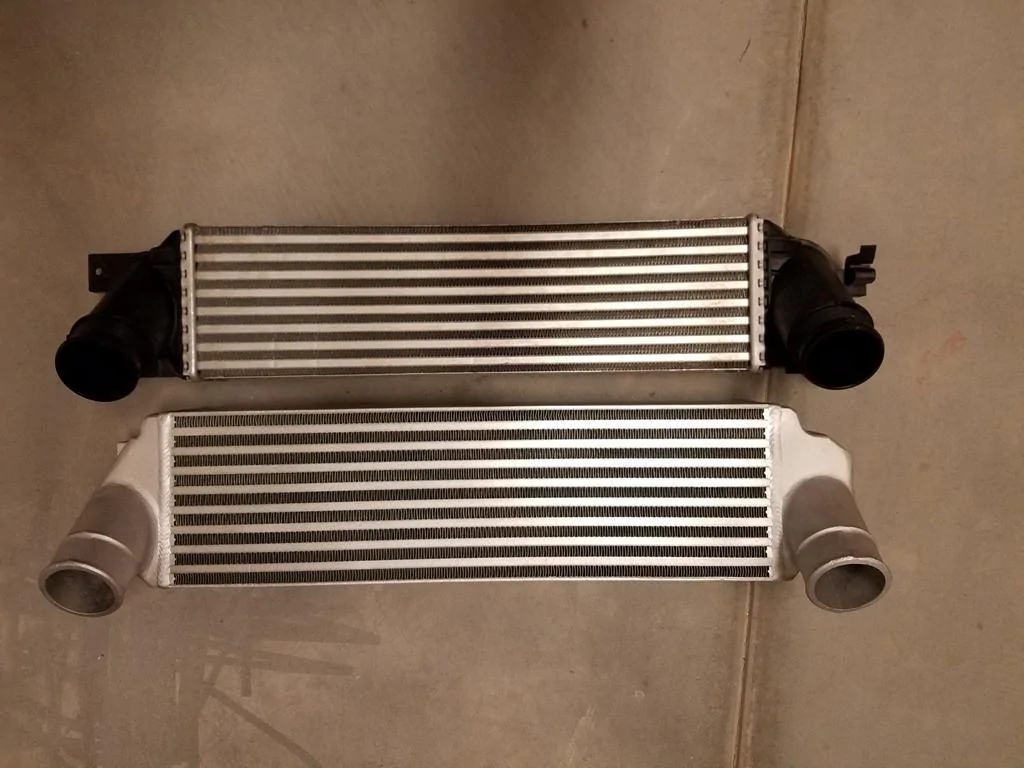

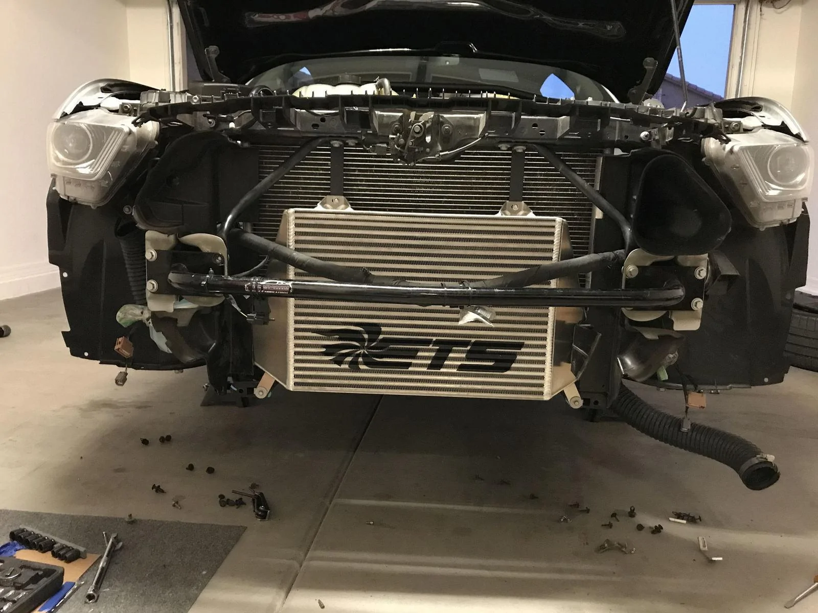

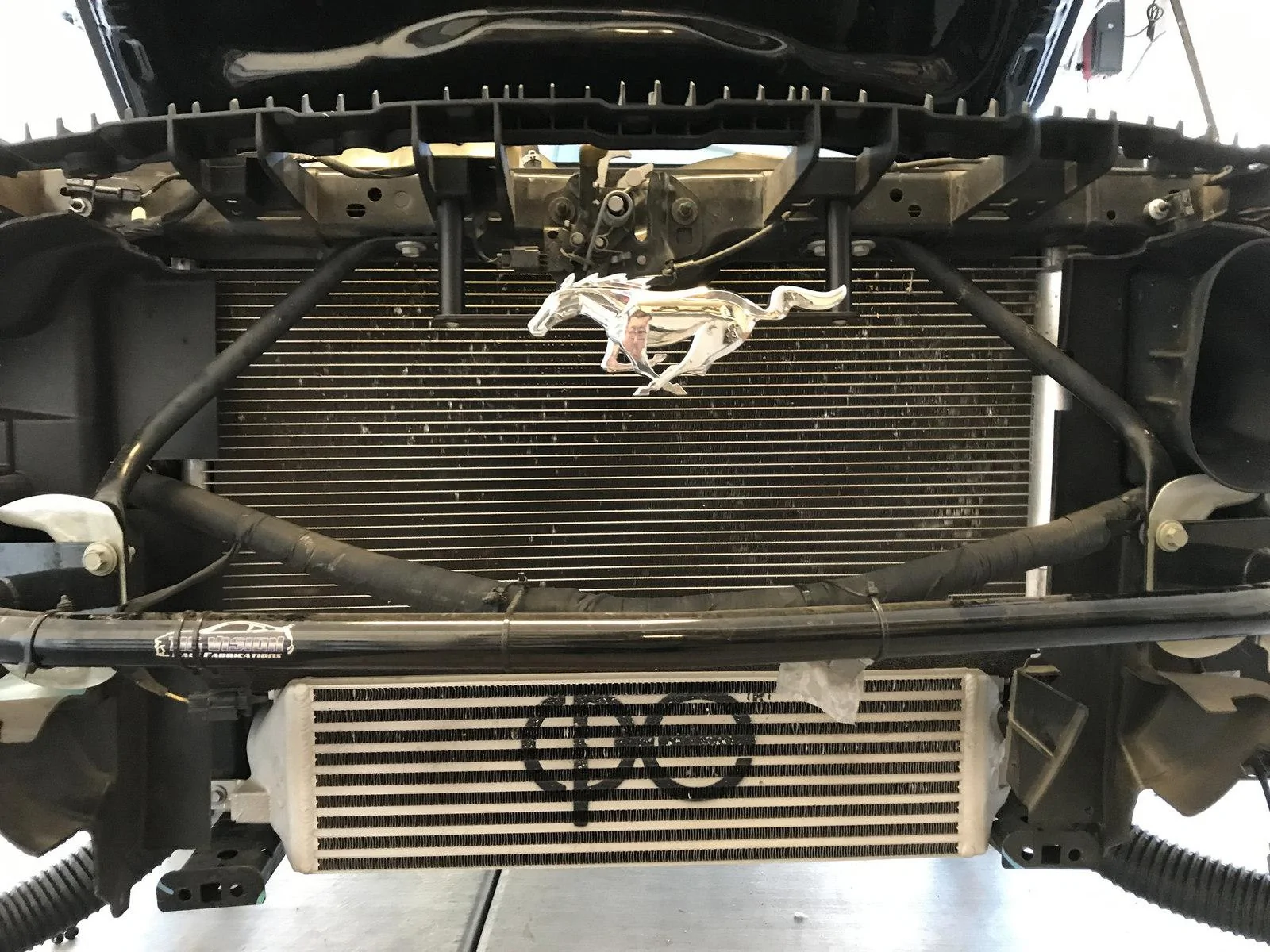

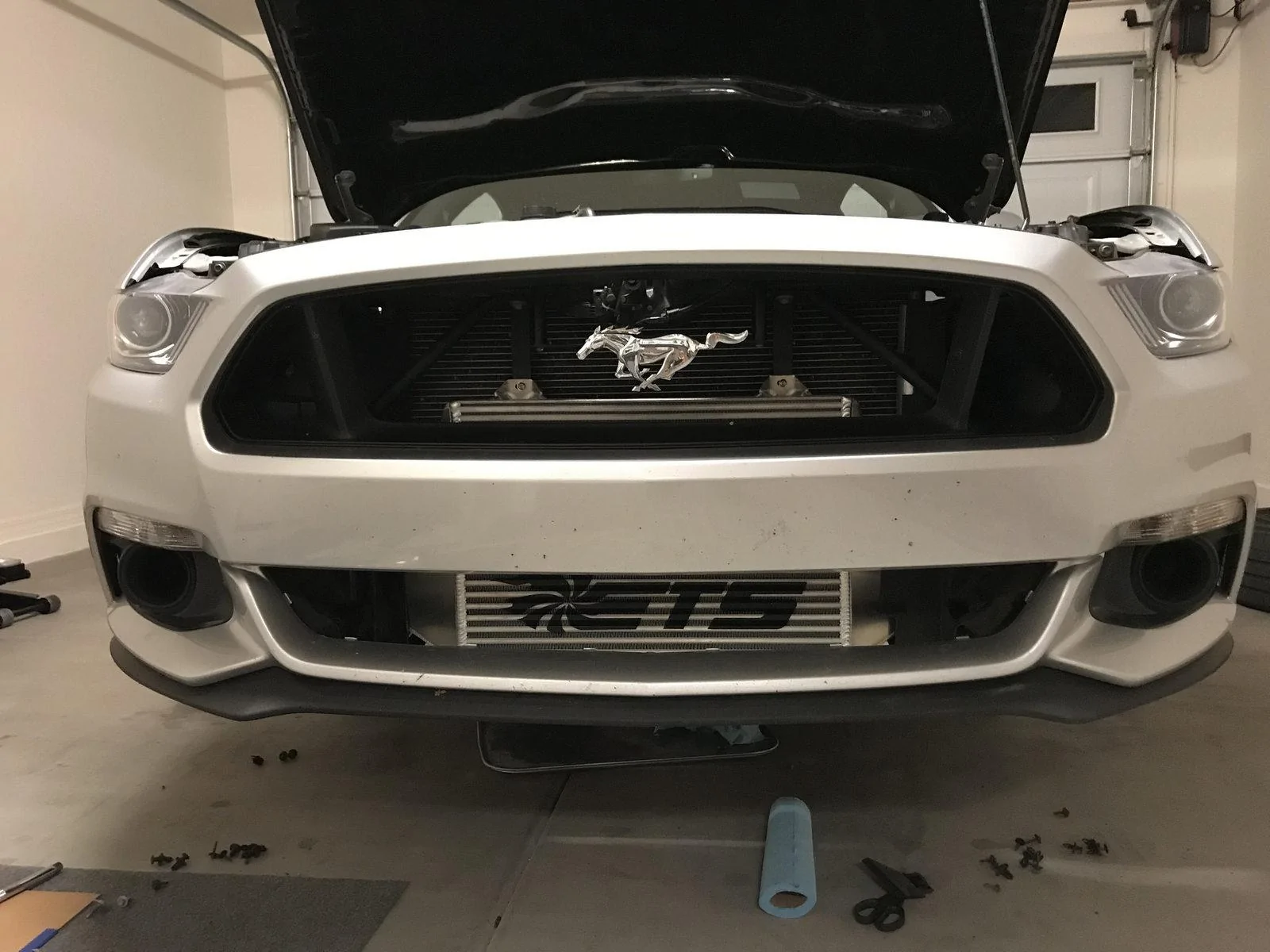

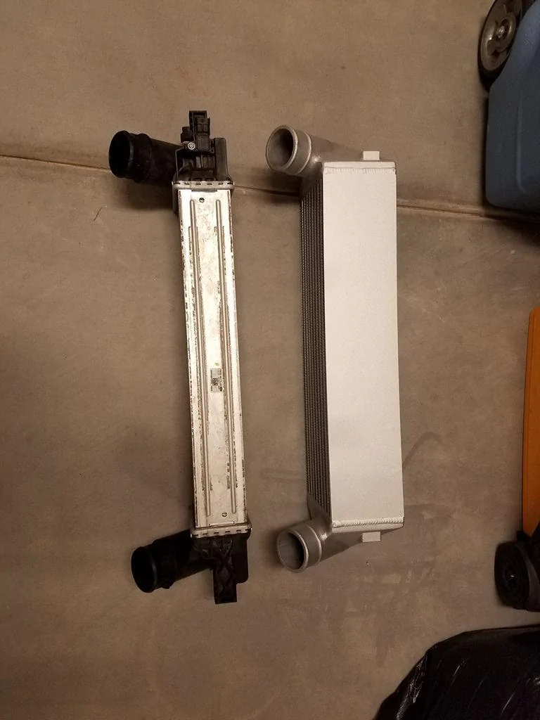

Map or cpe street intercooler? I have the Ford procal tune and I don't plan on getting a a new tuner in the near future.
If you are sticking with OTS tune, CPE Street IC's more than plenty. CPE claims up to 500WHP for that IC and it was plenty for my FBO+WMI+turbo upgrade+custom tune. I recently switched to ETS, only because I ran out of things to mod, there was a Black Friday sale, and I eventually plan on going with a built motor.
CPE Street vs stock
CPE vs ETS
CPE Pros vs ETS
Has thicker cast end tanks, probably holds up to abuse better
Can retain AGS
Good for the sleeper look
ETS Pros vs CPE
Can support more power for around the same price(ETS claims 700WHP)
Its frontal area is about twice the size (but is slightly thinner)
Good for the aggressive look
With the bumper cover on:

Appreciate the pics! A few things I think are important:
1: Cast end tanks are not only for holding up to abuse. Cast means that the end tanks are molded to facilitate the flow of hot air into the intercooler and cold air out of the intercooler and into the turbo. ETS, Levels, Speedfactory, etc. all feature end tanks that are sheet metal welded together without much else consideration for air flow. It allows them to save on cost.
2: Density of the fin pack is also important to consider along with size of the intercooler. If I'm not mistaken they're not too different (ETS may actually have more fins per inch than the cp-e), but the more dense the pack the more cooling power of the intercooler. Size shouldn't be the only consideration.
