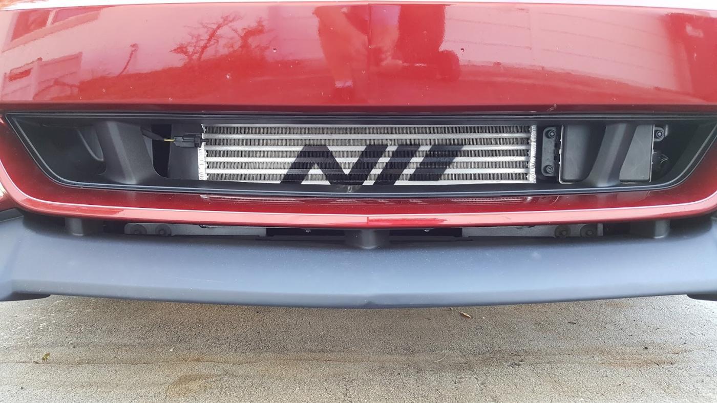

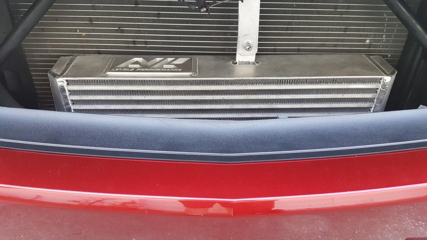

I have Levels Street the intercooler in place and so far everything is going well but I can't find any information on what the top mounting. Racket is supposed to bolt to. It lines up with the hood latch but there is no way it fits on there because the latch has a bend in the bracket that will not allow the intercooler bracket to swing down and attach to the intercooler. If you remove the hood latch and put that bracket behind the latch you will need about 1/4 inch of spacers on the other side and I didn't get any spacers with the kit. So if anyone has installed on please let me know where that bracket is supposed to attach to the car.
Thanks

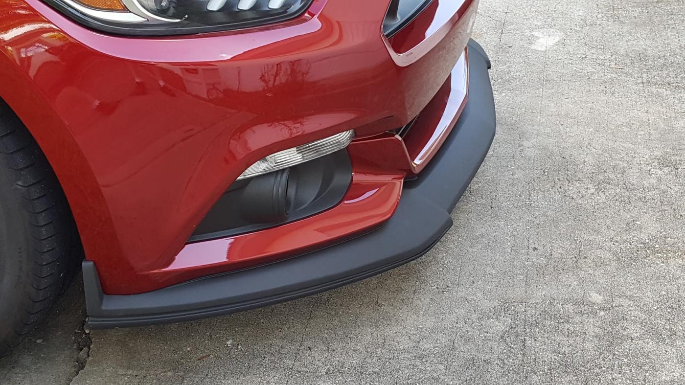

Heard back from Nik. It goes on the right mounting bolt of the hood latch. Overall the installation is easy. Just take your time and keep track of what bolts go where etc and you wont have any issues. Removing the front bumper cover is way easier than I expected. Just watch the videos that are out there and dont forget the 2 screws that are inside the fender well. There are a PITA to get to but doable with a small wrench. While I had it all off I also put in a GT grille delete and a Cervinis chin spoiler. Now that was a pain to install. None of the predrilled holes worked worth a shit. Ended up taking it back off and running the screws into the holes with a drill first and the spacers they send with the longer screws dont work either. The screws really should be longer but with this being my daily driver and up in the air I ended up belt sanding the spacers down 1/4" so the screws grabbed.

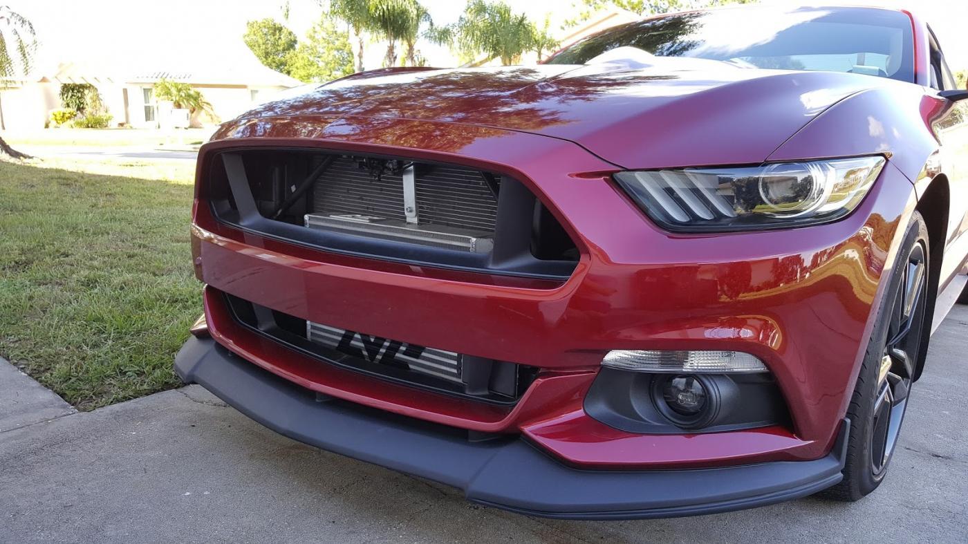

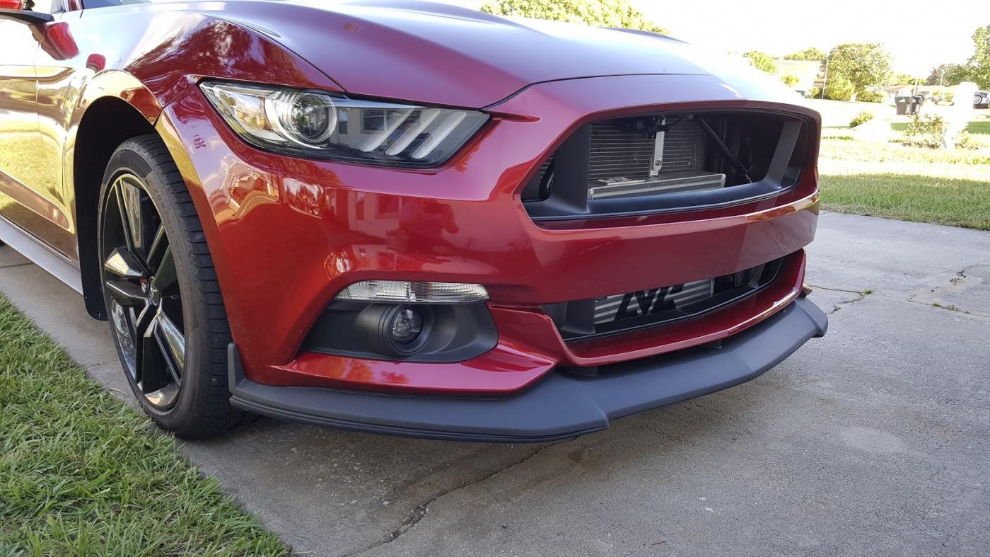

man that intercooler is enormous.

Yes and one of the lowest priced available too ! Very well built.

Debating on whether I like it myself but it's staying like that for now. I know it's got the Honda Civic guys attention already. Lol
