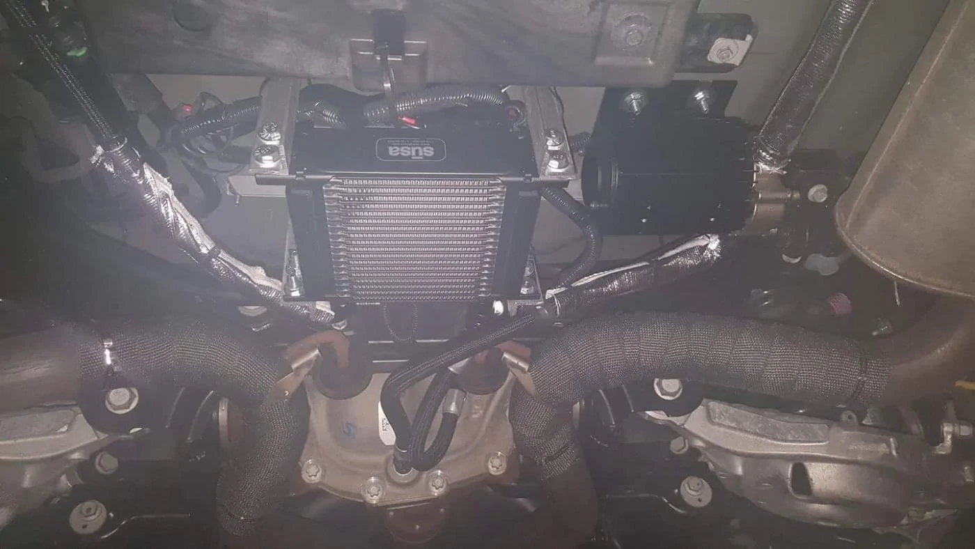

Our axle cooler is holding up well after the first session at Daytona, tomorrow I'll remember to bring my temp gun to see how hot it gets :frusty:
Good to hear. Don't forget that helmet! :D
Nice to see that placement, it was on my mind as a possibility. The other was a long, thin, double-pass exchanger, like a power steering cooler, tucked between a rear pan and the GT diffuser with air directed through it or in a 350 diffuser. Probably won't mess with it until later this winter or early spring. If there's an inexpensive bolt in solution before then I may just go with that.

So I ran two sessions in the morning today. I shot the diff cover with my temp gun coming off the track. I hit 150MPH+ at the start finish line and 140-145MPH on the back stretch. 30 minute session and the highest I could register was 181F. I'll install a real gauge before my next track day, but in my experience my temp gun is usually >5F from a temp sensor reading. My fan never comes on because I think with the BG 75W-140, the cooler and the extra capacity it stays in a good range. This cooling loop added roughly a quart to the system. The fan switch is 190F.
With the speeds I'm running it should be getting hot, 3.73's on 285/35's is spinning the pinion real fast. I have to shift to 6th for both of these runs. I plan to address the needed 500-700 RPM soon so I can stay in 5th. All runs are in Sport Mode.

Setup looks really tidy and clean Tim. More importantly, glad to hear it is working well so far.
Brent, I spent some time with Dean today and I looked in the trunk and saw my exact cooler set up on his S197 race car... #GreatMindsThinkAlike LOL
