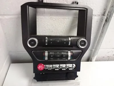

Are you installing a new ACM? Adding Sirius or Sirius/HD requires changes and the output and EQ must be changed to amplify the factory speakers properly.
Is your FCIM for a Recaro or heated seat car?
Did your FCIM (bezel) come from a wrecked car or is it new? If it's new, leave it alone.

I went ahead and bit the bullet and order the extremely expensive radio bezel with the deleted heat/cooled seat buttons. The plus side is that it already had the red gt350 start button installed.. so that is a good thing and a $50 option.
After this I plan to do the digital dash swap.
Where did you buy the non-heated seat radio bezel?
I found it on Ebay.
