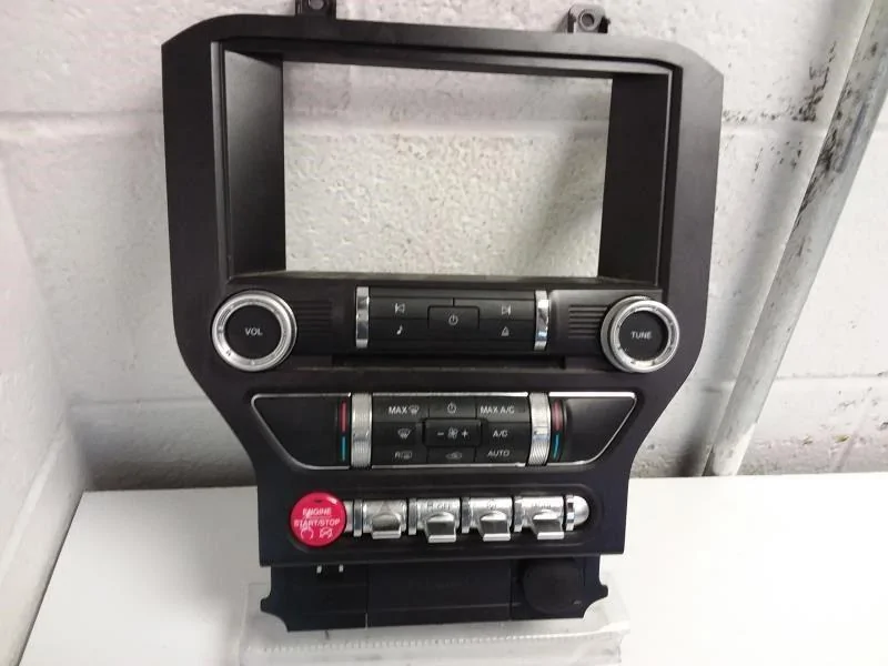

Alright, I think have all the parts on order to get the base to Sync 3 Swap done.
$385 Sync 3 w/nav
$7.45 Mouser (connectors)
$397.50 Radio Bezel
$120.51 Tasca (USB cables, HUB and spare clips)
$136.18 Amazon (OBD Link, Wire, GPS Antenna and trim tools)
$30 Brackets
Total for my swap $1076.64
Would have been under or close to 1k minus the trim tools, spare clips and 22 gauge asst wire.
I went ahead and bit the bullet and order the extremely expensive radio bezel with the deleted heat/cooled seat buttons. The plus side is that it already had the red gt350 start button installed.. so that is a good thing and a $50 option.
