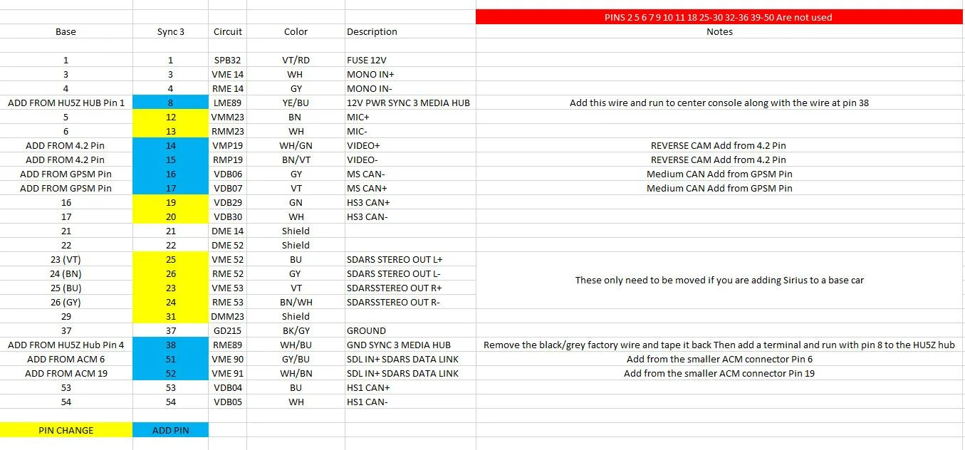

The guy that is selling that gave me the VIN, I'll look it up and see. The issue I see is that the CD slot and the overall size of the chassis appear different from the Mustang ACM.I'm not necessarily wanting to install the Fusion ACM because I don't really have a need for sat/HD. However, since it came as part of a deal (free), I wondered if it would work with a simple bracket swap. If everything else is equivalent and compatible to the Mustang ACM, I thought I might as well exchange it while I'm in there.
But again, without confirmation that the non-Clarion units will work, it's probably a moot point.
