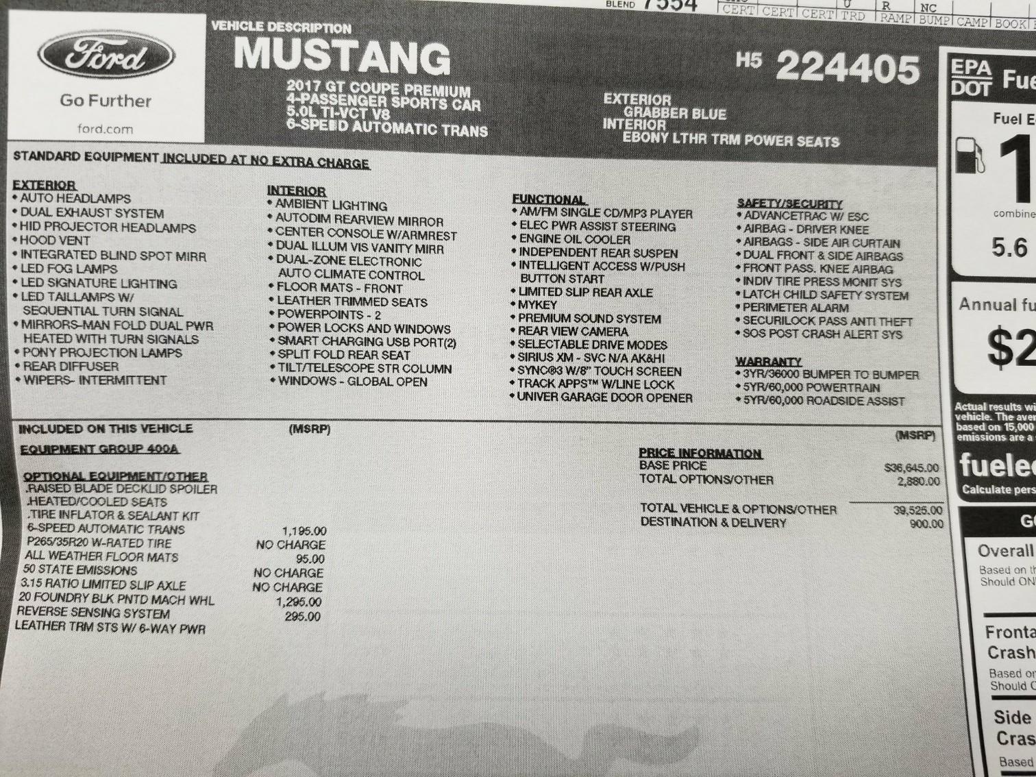

Gotcha,
Yeah, my nephew is a Ford Mechanic here at the local Ford. I called him today before I purchased it and he was off. He tired to log in from home to look it up, but couldn't. I will definitely know first thing Monday when he gets to work.

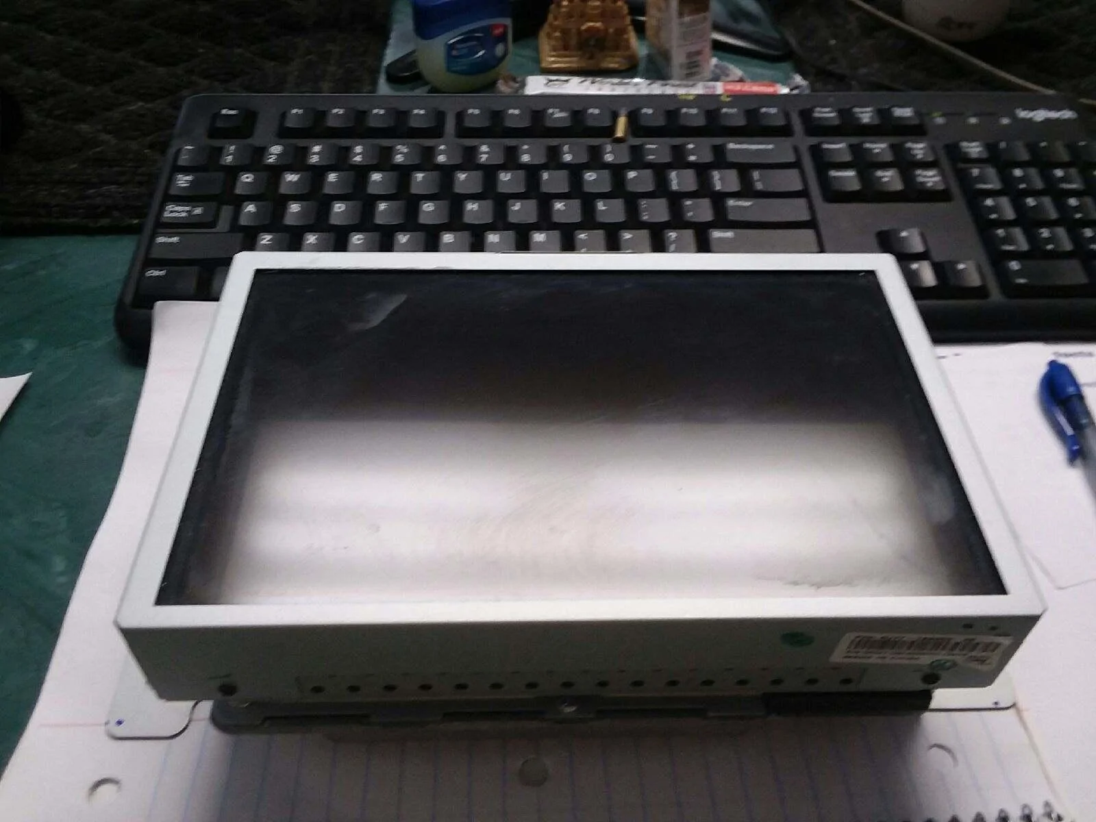

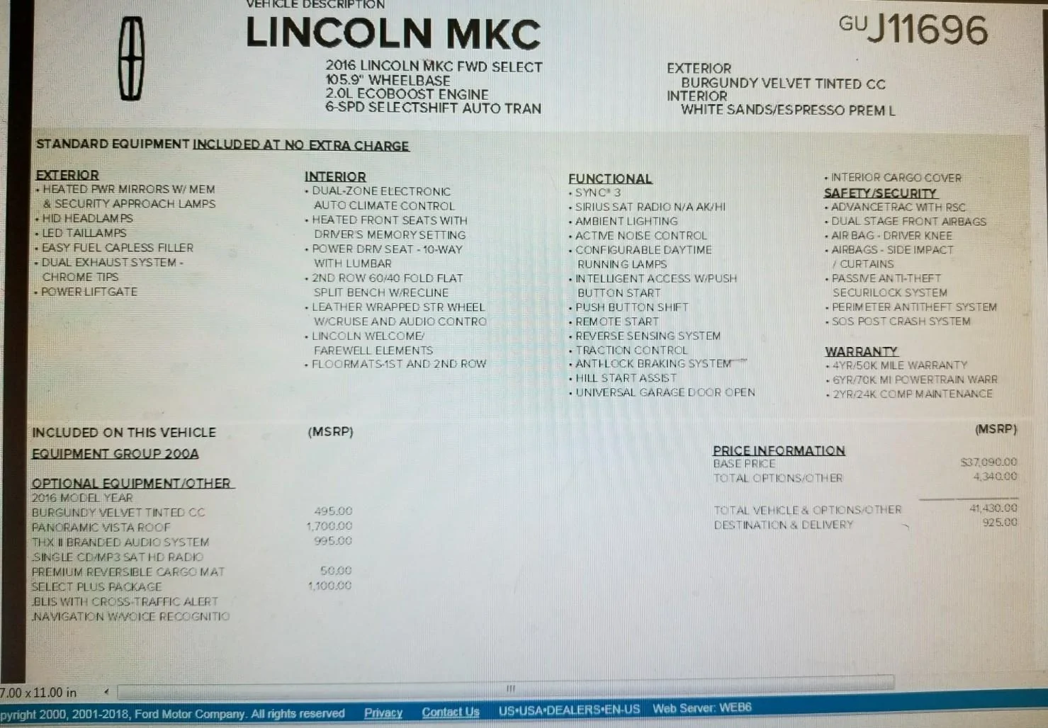

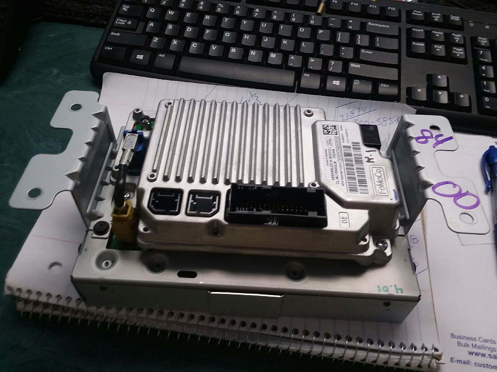

Alright, I think i have found one out of 2016 Lincoln MKC...
$350
Ran the VIN and it came back with Sync 3 and Select Plus Package $1100 which includes Navigation.
Looks to be in good shape from the pictures, just needs the correct brackets.

looks like that should work. You will need to use Forscan to update the APIM with your as built data.
I put my "as built" on my Sync 3 APIM and lost nav so I reverted it back. In reality there were only a couple settings that needed updating but mine came from a '17 Eco boost premium and I Have a '15 GT Premium. I loaded APIM as built data from a sync 3 car as-built.

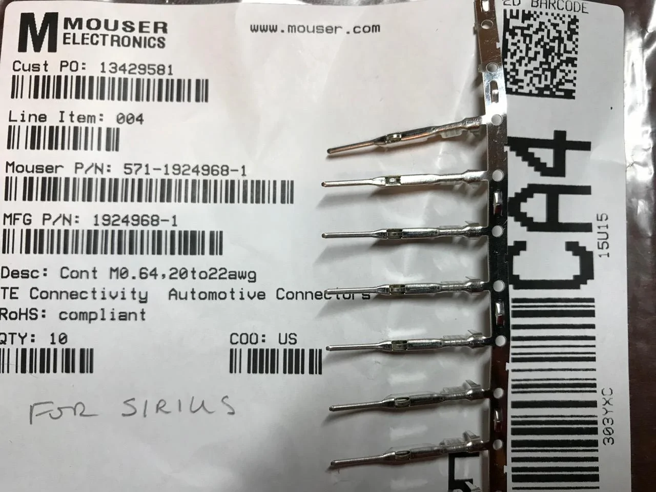

So, I'm in the process of doing the wiring, per page 1. I ordered my terminals from Mouser via the provided links. I attached the two 1924968-1 terminals to the wires for 6 and 19 on the ACM but something's not right. The 24 pin ACM connector seems to have the same female terminals as the APIM, but the 192968-1 terminals I have are male.
Am I missing something or did Mouser package the wrong terminal?
No, I pasted the wrong number from my harness build sheet. It should be 2035334-1. Most people aren't using Travelink so my typo wasn't caught until now. PM your address, I'll mail you some.
I had this exact same issue, i should have informed [MENTION=28081]HextallS550[/MENTION] back when I did the swap but I forgot to mention it. Since I didn't have time, what i did was just twisted and plugged in the wires directly into the connector and taped it so that it doesn't come out. While it isn't the ideal solution, i didn't have any issues so far. Almost put 10k miles on it since the swap.
