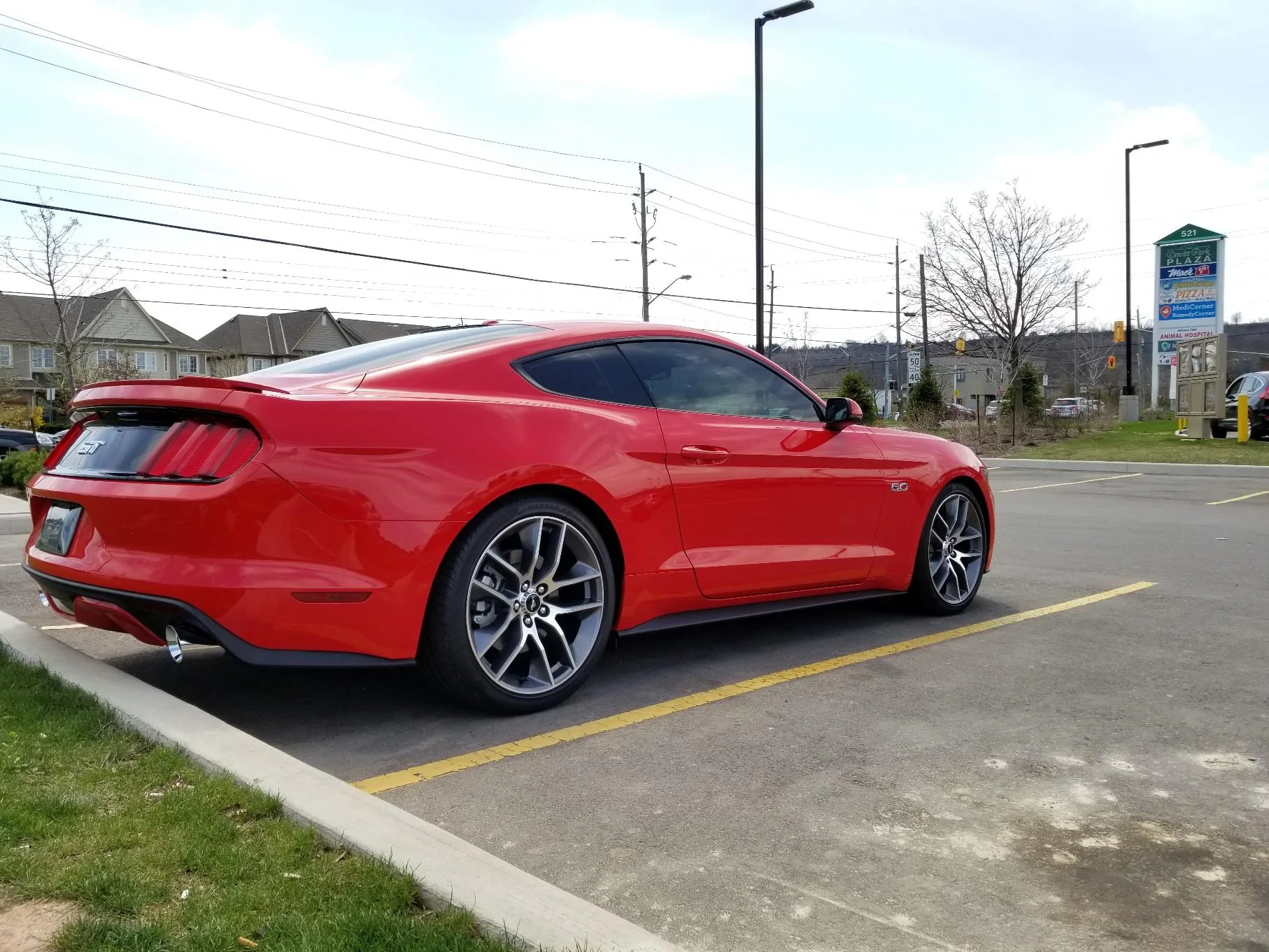

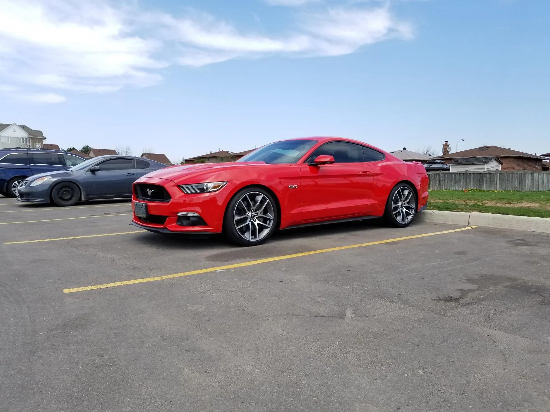

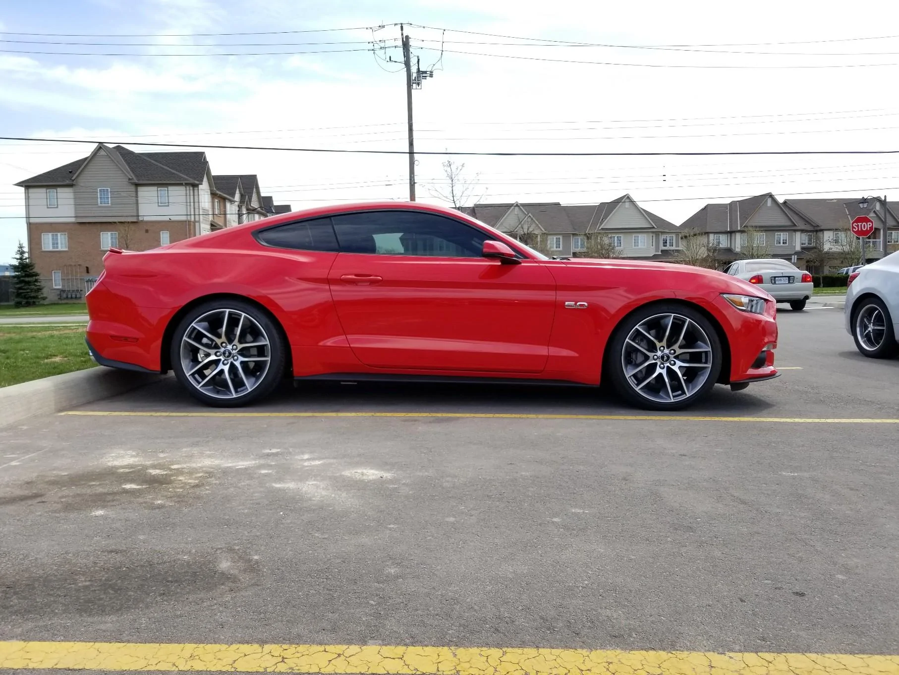

This'll is what I installed after a bunch of research. Everyone has their own opinion so I took all those and then did what I wanted.
In the end it worked out great. It's only positives and no negatives from my perception.
Ford street handling pack
Steeda lateral & tension links
Steeda Bumpsteer kit
Steeda rear vertical links with poly bushings
Steeda front and rear sway bar end links
Steeda stop the hop starter kit
Car is low but not too low and it handles like you dream it should. You won't be able to push it to the limit on the street and it's trackable but at the same time soaks up the shitty city streets.
Wheel hop is 100% gone the car just hooks and goes. The floaty disconnected feeling of the rear end is totally gone. The rear end feels glued the car.
It's race car without being fully racecar. Comfort plus handling. Win win. But like I said everyone's after something different. This was my idea of perfect.
