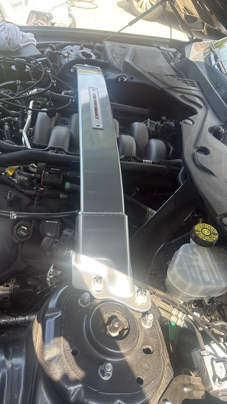

My car has recently developed some clunks after 90k miles on the stock suspension. I was looking at the Ford Performance track kit, but it seems like it’s always on back order. It’s a daily, but I am looking into slowly upgrading the car. I do want to eliminate the body roll in curves. My previous Mustang was a 2006, so all of these IRS components are very foreign to me. So far, the first real “mod” was the Ford Performance GT350R strut and cowl brace — that has helped stiffen up the front a lot! I did find the cowl extension thread and just ordered those parts, so it’s time to take all that apart again. I also swapped to Michelin Pilot Sport 4S 275/40/zr19 tires, and that has made a huge difference.
