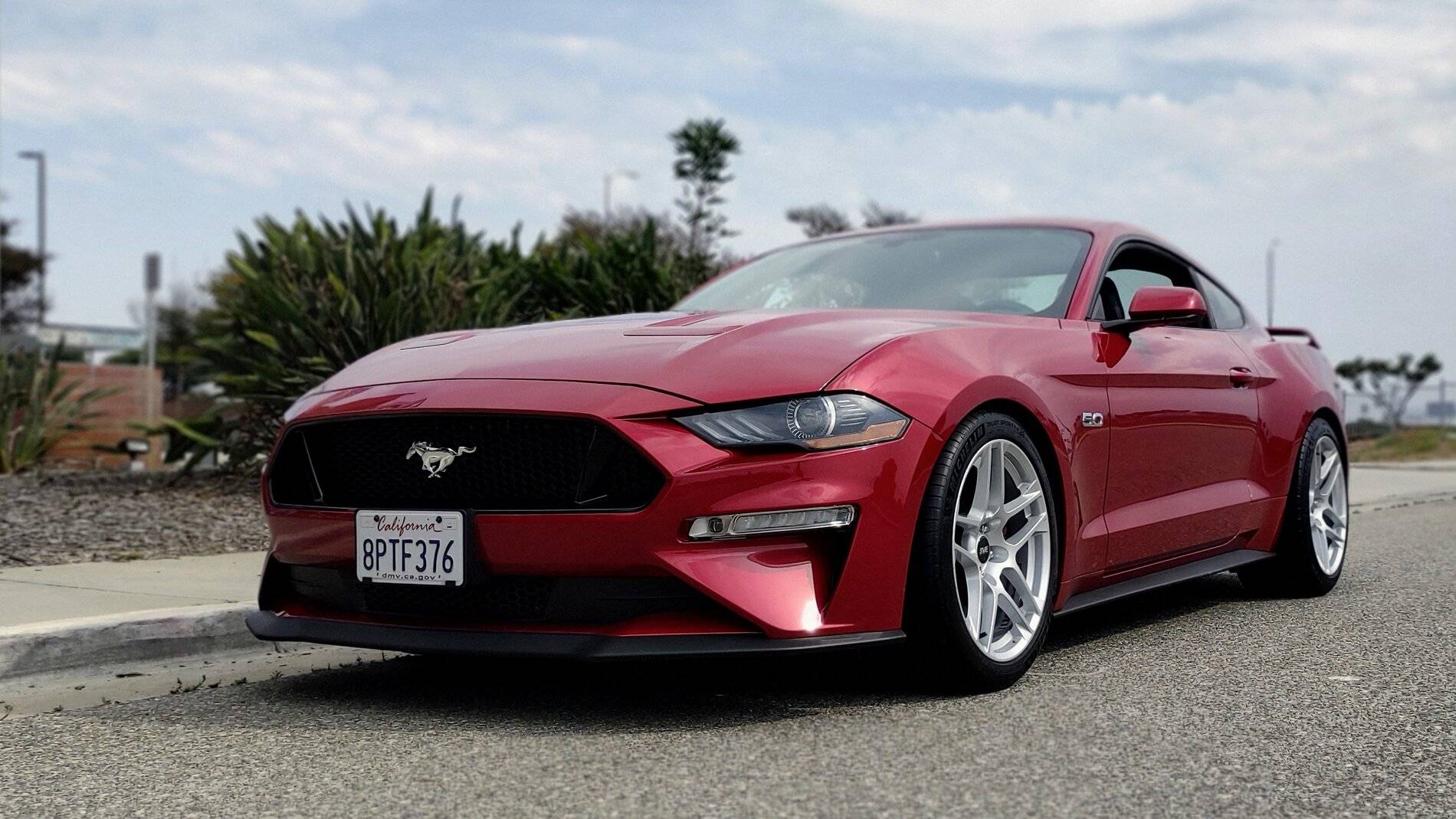

I am kind of at a loss. I found the FR Track kit to be stiff yes, but also quite compliant. I would go with the TrackKit and learn to suck it up buttercup! :D
TrackKit
