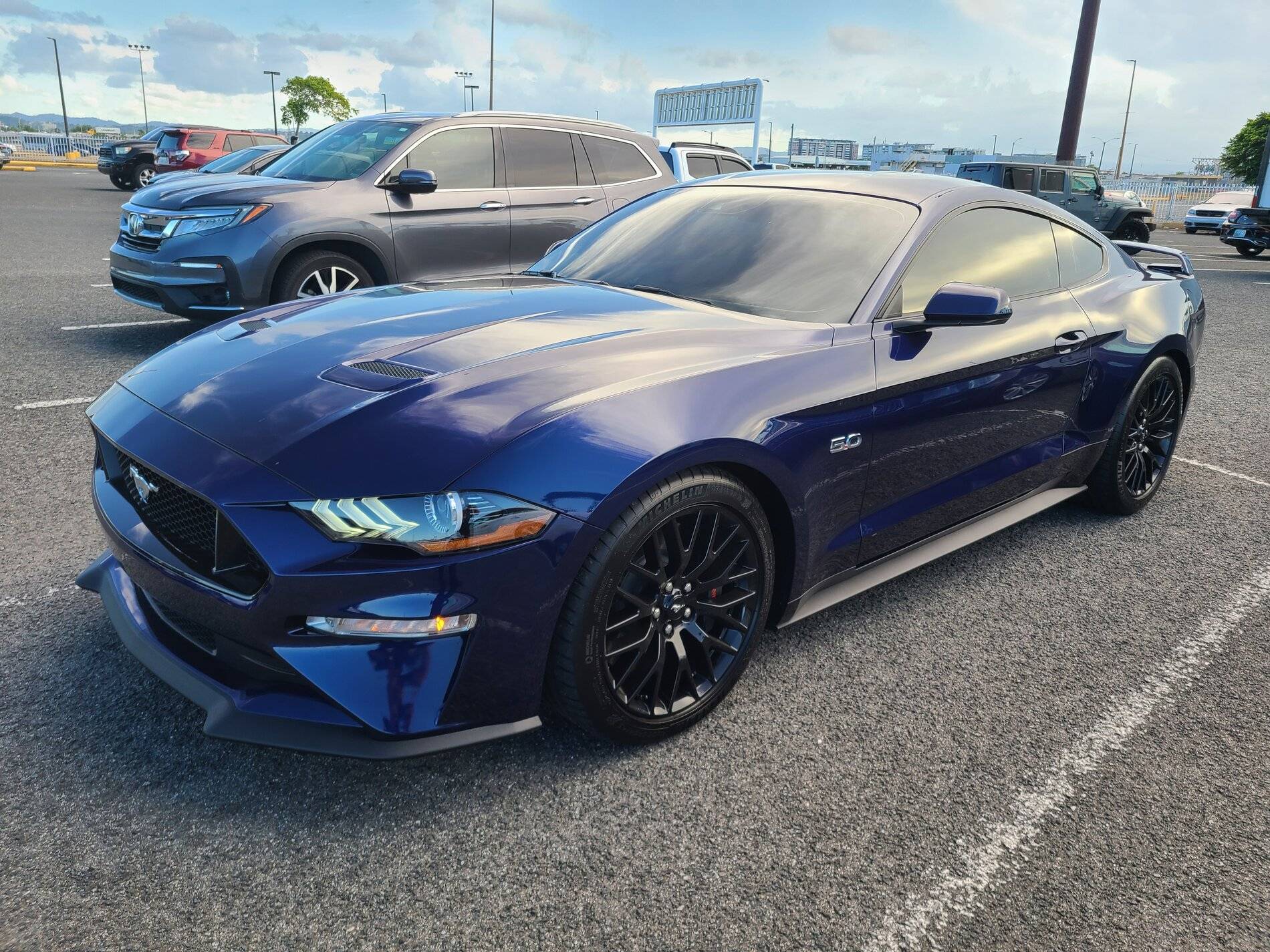

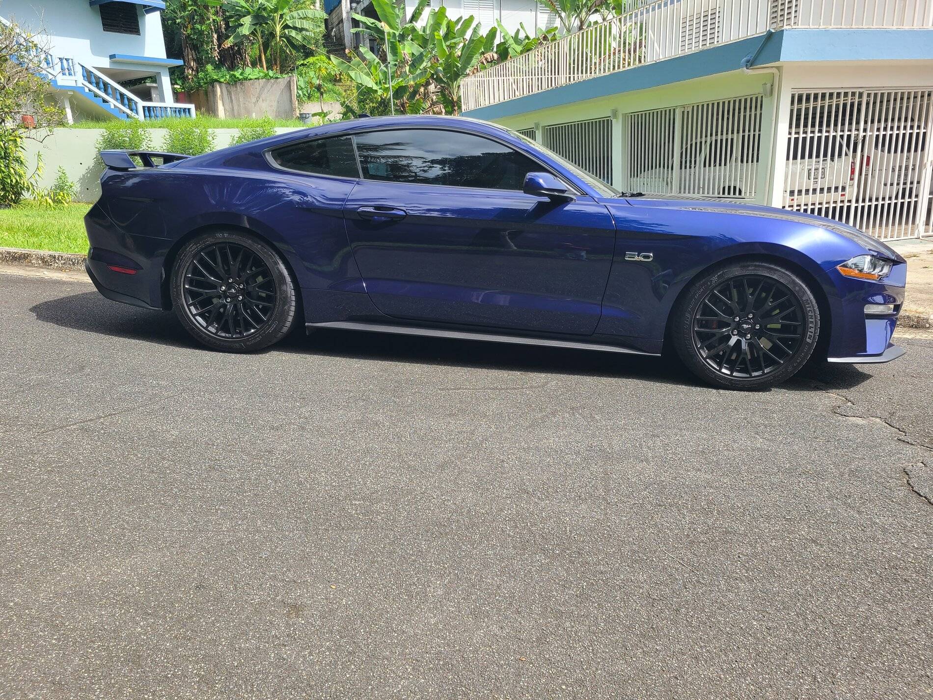

Steeda Pro-Active Shocks and Minimum drop springs. Perfect stance and great ride. And I live in P.R. Streets here are worse than N.Y

Awesome, Roberto - the car looks great & glad you are happy with your package. WE appreciate you taking your time to post photos & your review - thank you!
