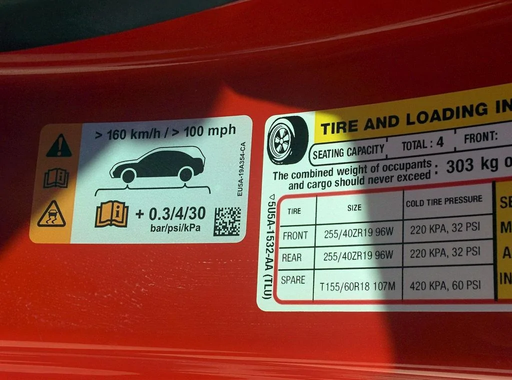

No one ever seems to mention this, but this stick on my door jamb seems to indicate 36 psi if you do any sort of fast/hard driving.
Low pressure will cause tire to heat up faster. Pretty common practice on trackdays where you measure your tire temperature and add/remove air accordingly.
this isn't present on my GTPP, may have something to do with non stagger, maybe non p-zero summers?
Sorry to ask, I am not seeing the he 36 psi. Could you point it out to me please?
Take the 32 psi from the right sticker and add 4 psi indicated on the left sticker if you drive over 100mph.

Keep in mind, door stickers are COLD tire pressure. In my car, 32 PSI goes up to 38 PSI when the tires are warmed up. Starting at 40 PSI cold is a recipe for issues.
