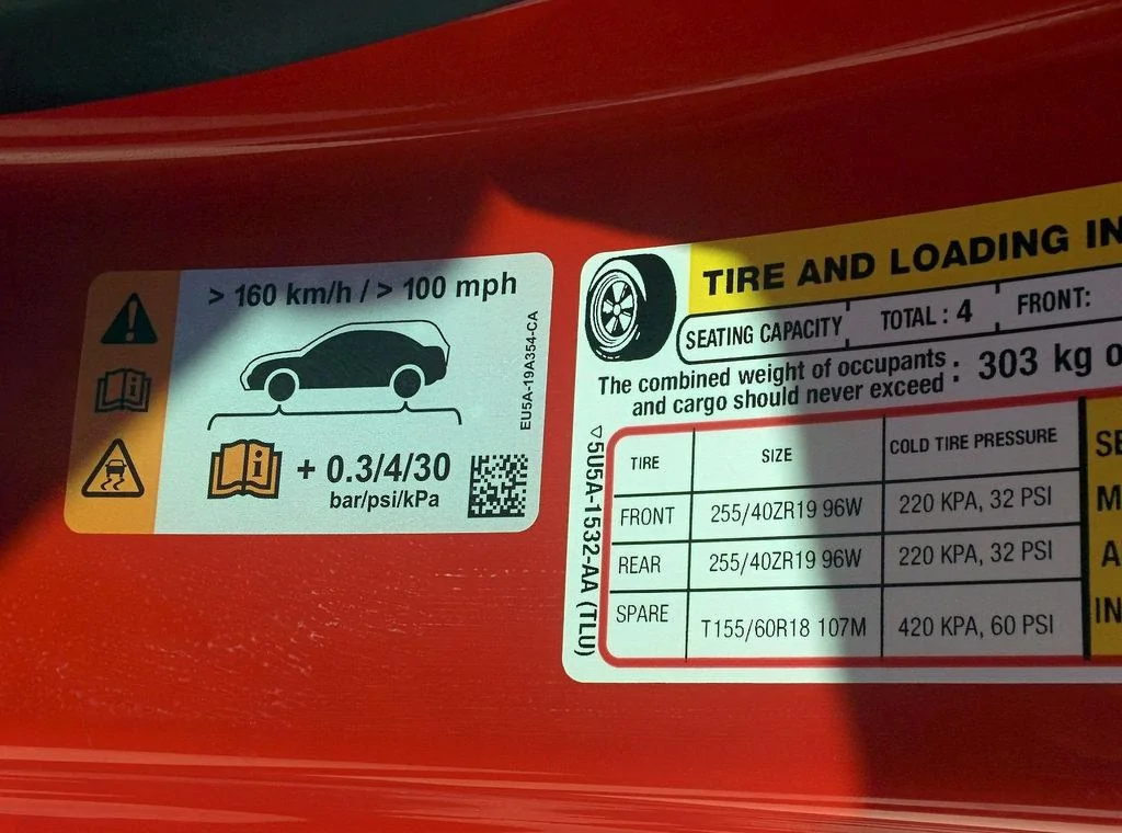

Yep. The doorsill recommends 32 psi.
I'm a little surprised they call for that low. Higher pressure results in less sidewall flex and better turn-in. Is 32 the recommended pressure for PP cars?
Never mind, I see you have a PP.

The pressures in the first post picture are what my car came with.

No one ever seems to mention this, but this stick on my door jamb seems to indicate 36 psi if you do any sort of fast/hard driving.
