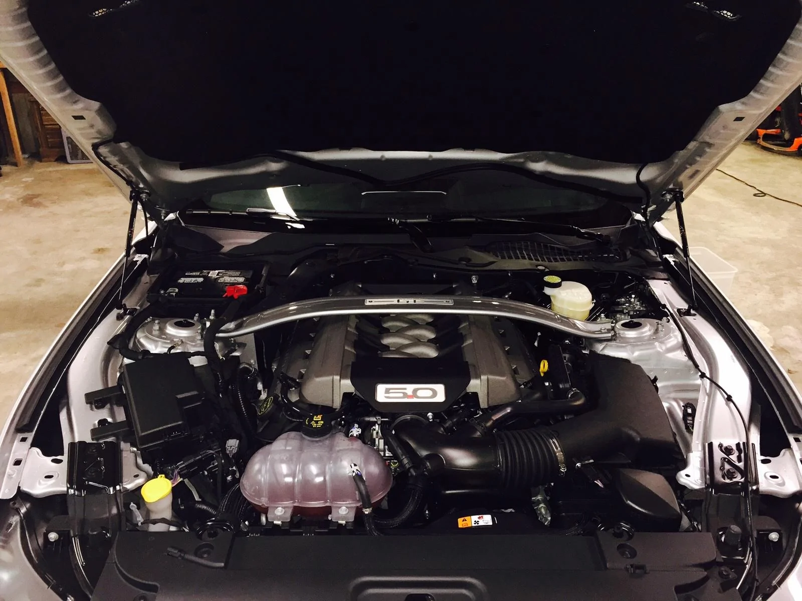

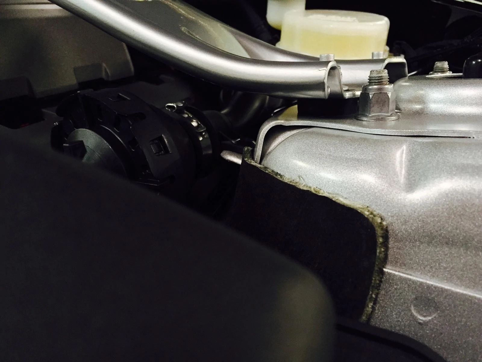

This has been bothering me a bit since the install. The kit shipped with 4 nuts but only 2 were used. The passenger side already had 2 used that were identical so I used those.
Did I do something wrong? Does everyone have 2 extra?
The directions say to use the 4 new nuts.
They are the same as the two old ones though. You should have two nuts left, old or new shouldn't really matter.

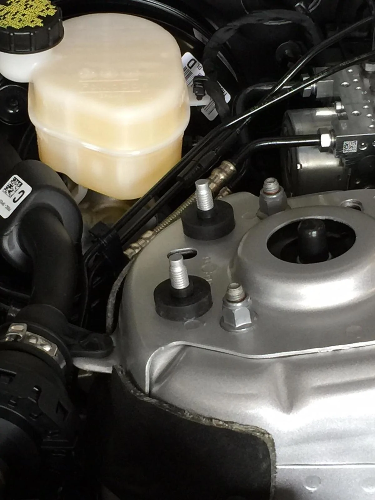

I'm not hard on my car at all so this is what I did. I don't need all that bracing so I went to Lowe's and bought these
PUT THEM ON THIS:
SIDE SHOT OF THE BUSHINGS:
ENGINE BAY SHOT:
DONE!
COST? $4.00:lol::lol:
