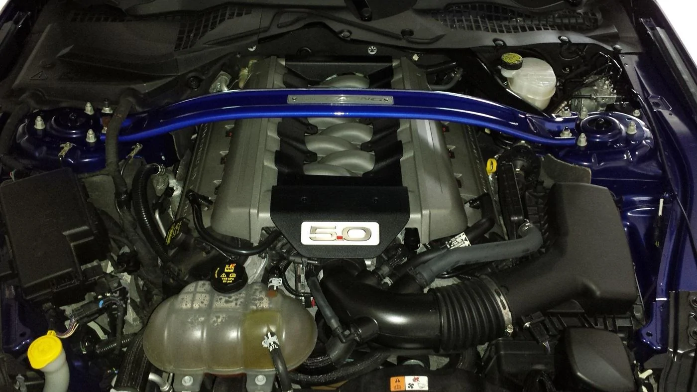

I installed my Ford Racing strut brace. The box was ripped open when delivered and the nuts were missing. Ford's standard pack size is 3 nuts (W712334-S442 as noted). Go figure! So I reused 1 nut.
If you lose a battery cover rivet they are W716510-S300. :p
I haven't driven with the strut brace yet as the car is in winter storage, but it sure came out looking good.
It's a pretty noticeable difference — you'll like it!
