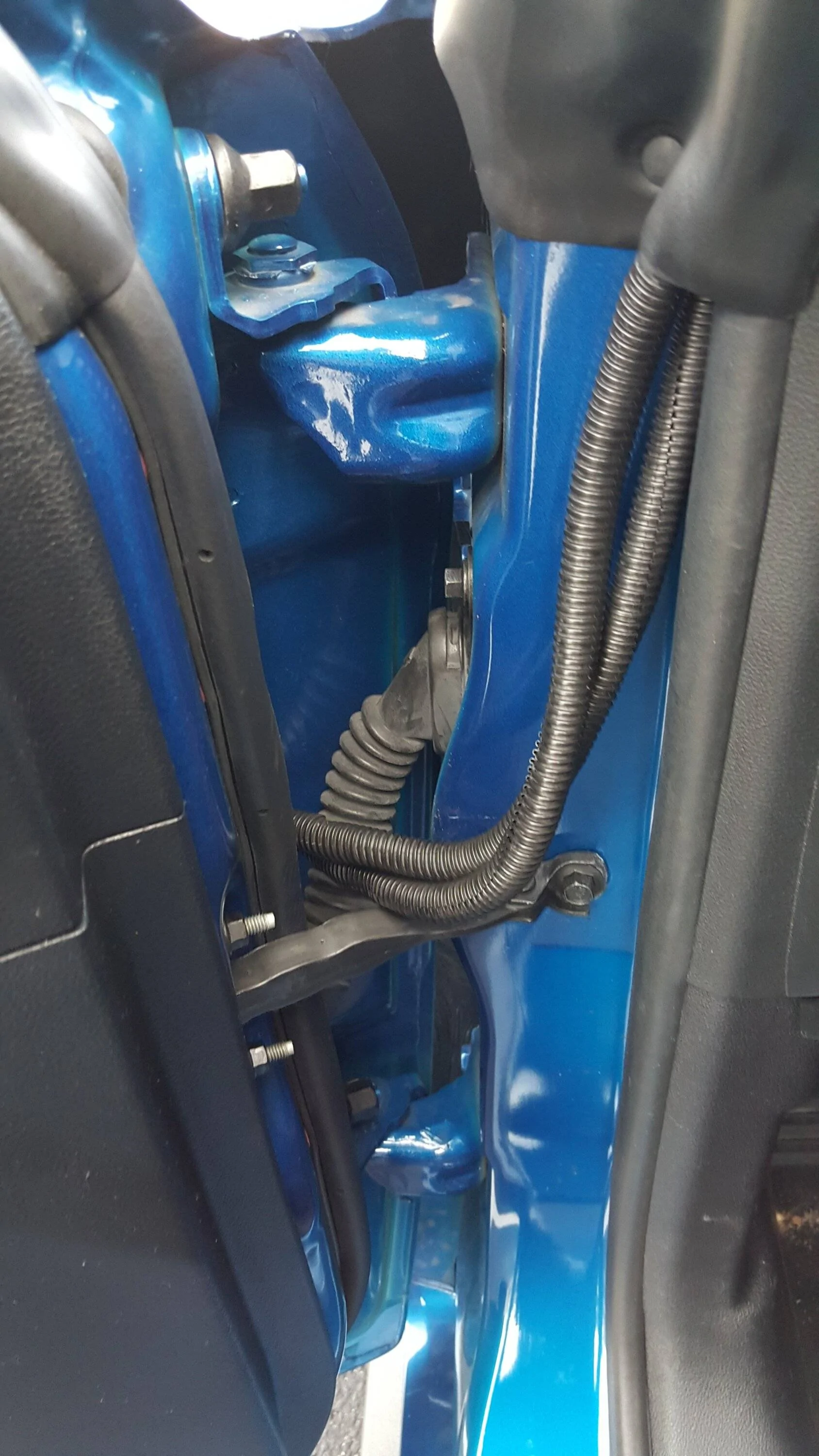

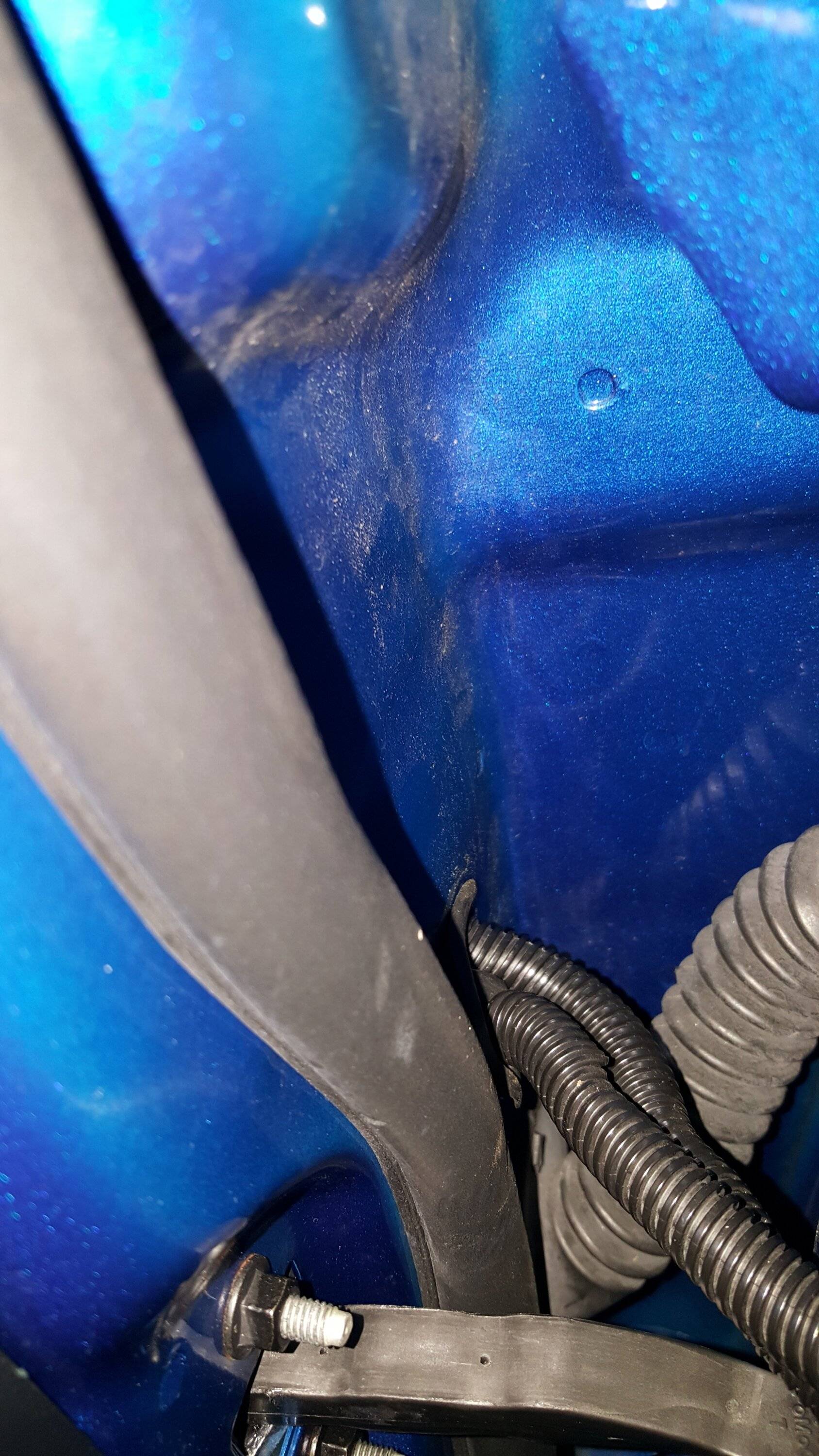

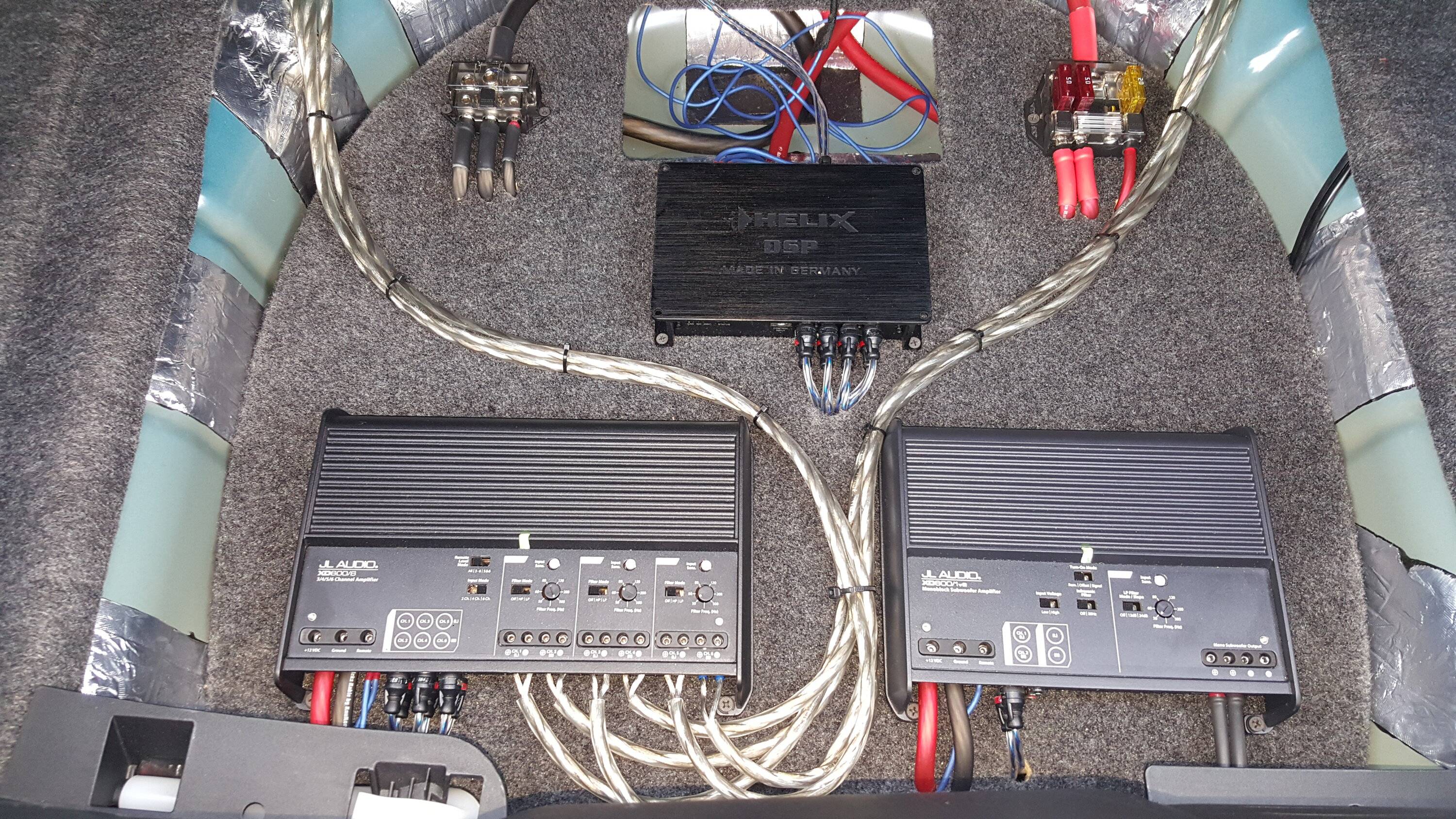

how i did mine, not the greatest pics, but the the third shows the size wires i ran into the door...i didn't want to mess with the molex...just went through a grommet in the door.
The pics are detailed enough for me to get the idea. Thank you! Was the grommet you used already in the door?
That wire loom you ran doesn't get pinched when you close the door?

17 GT Base Lightning Blue
Existing grommet and I haven't seen any indication of pinching and been there for several years.
