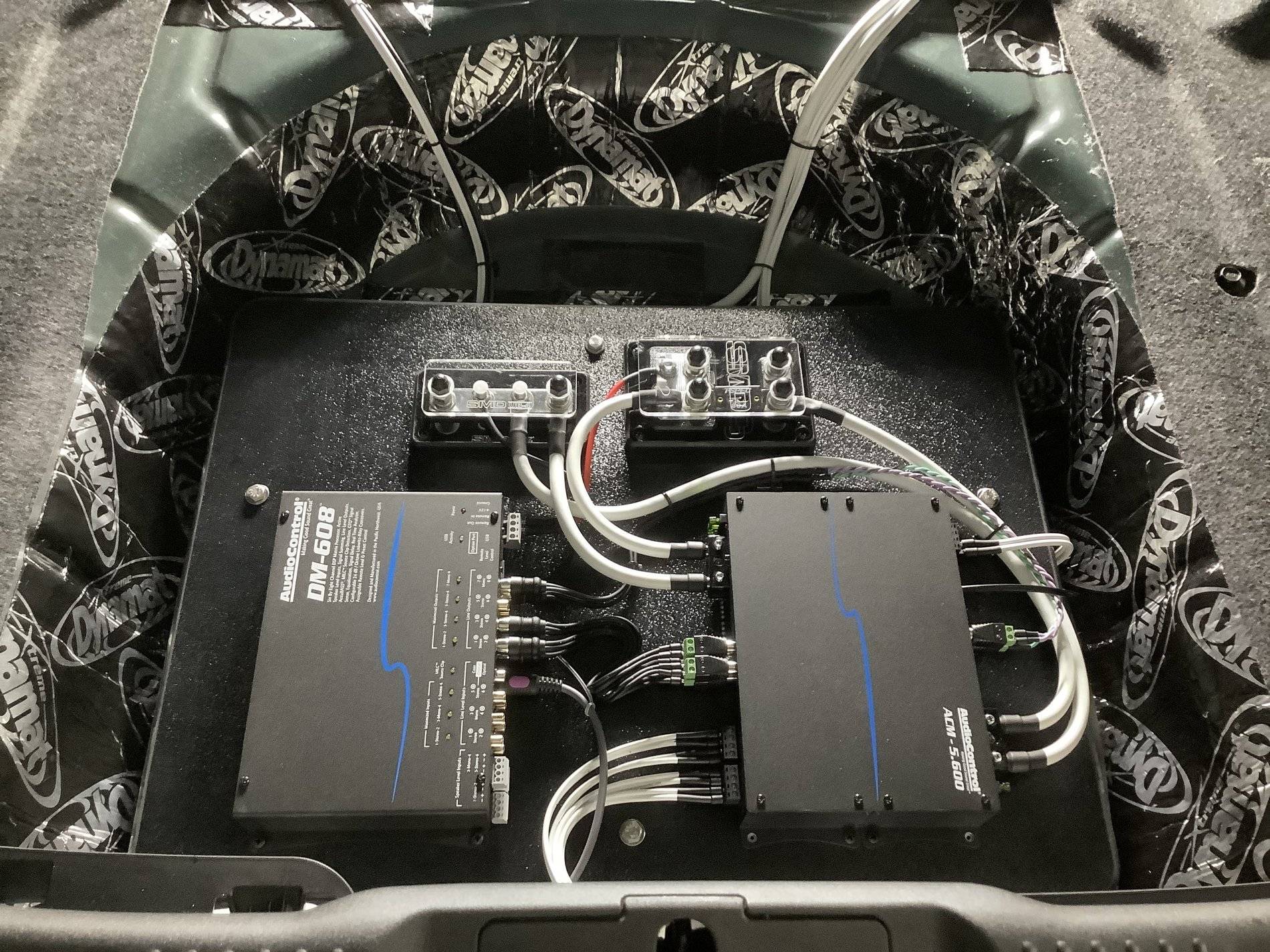

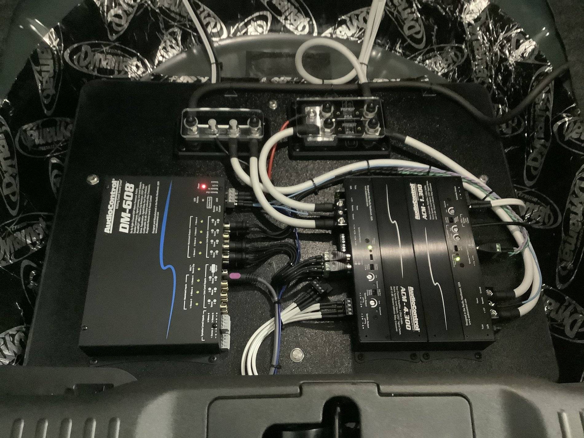

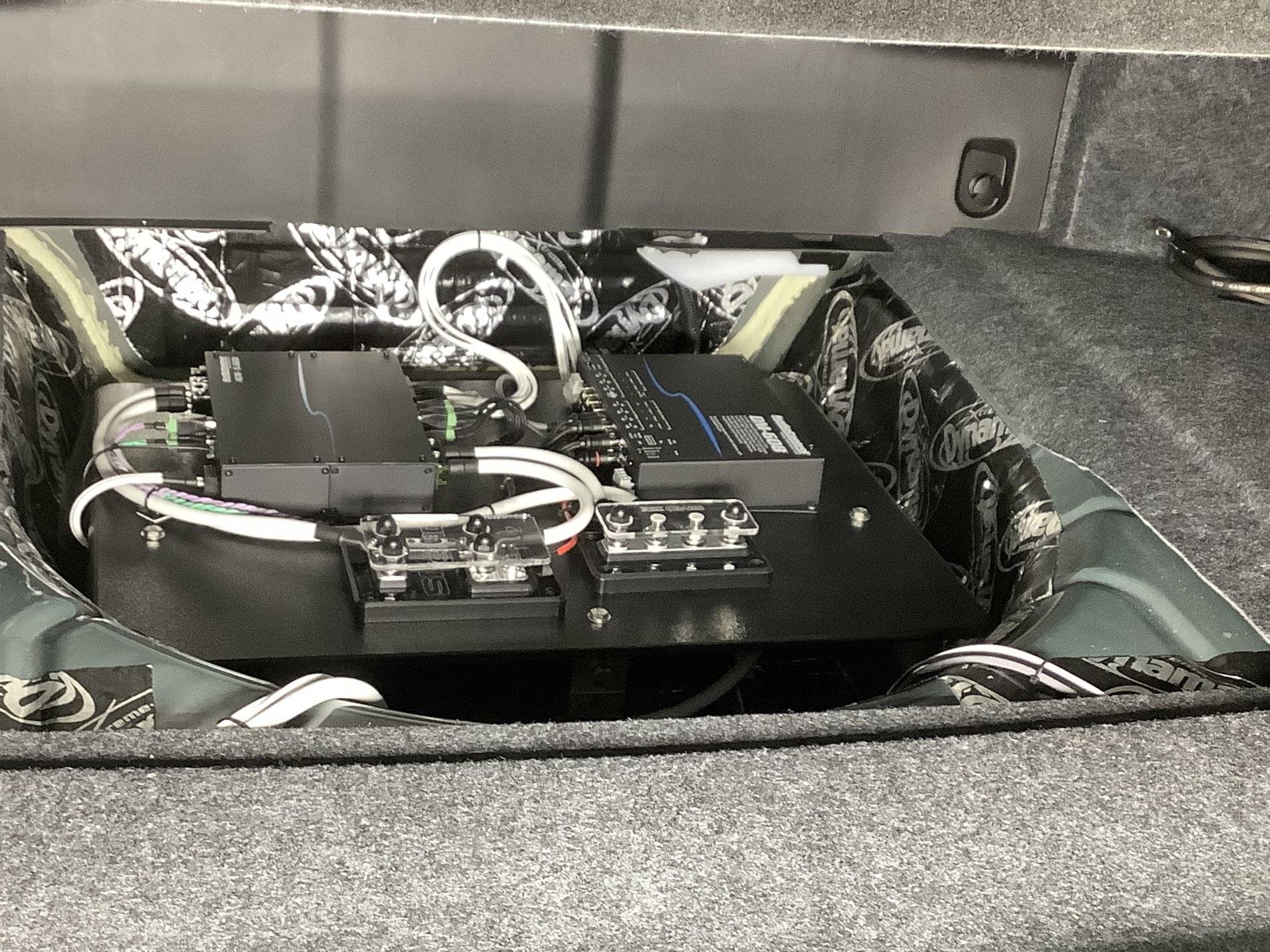

Why do you need the DSR1 with that HRN AR FO3 harness? Buy the harness just for the plugs and modify it to put RCA plugs or whatever you want on the signal lines. Hell, I used Cat5e STP cable (triple shielded and twisted pair) to run the signals back to my trunk. I used the raw connectors sourced from Digi-Key and mounted them in a box instead of the expense of the FO3 harness.

I considered using the HRN AR FO3 harness but decided to use StangTime's design except mine has RCA connectors into the DSP. Its all working fine.
