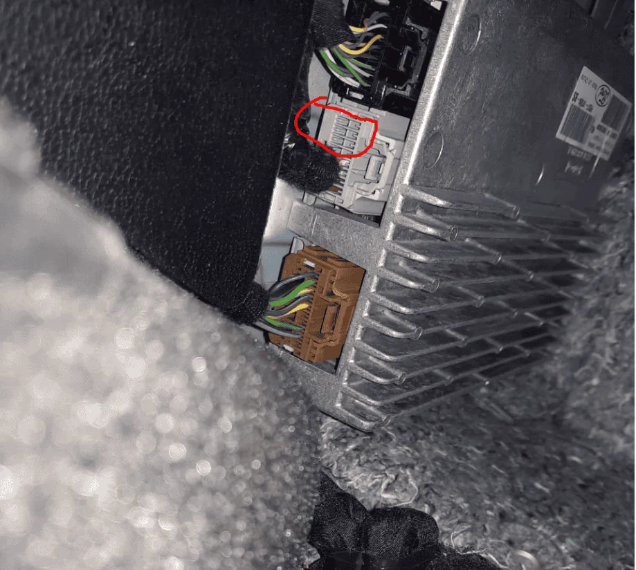

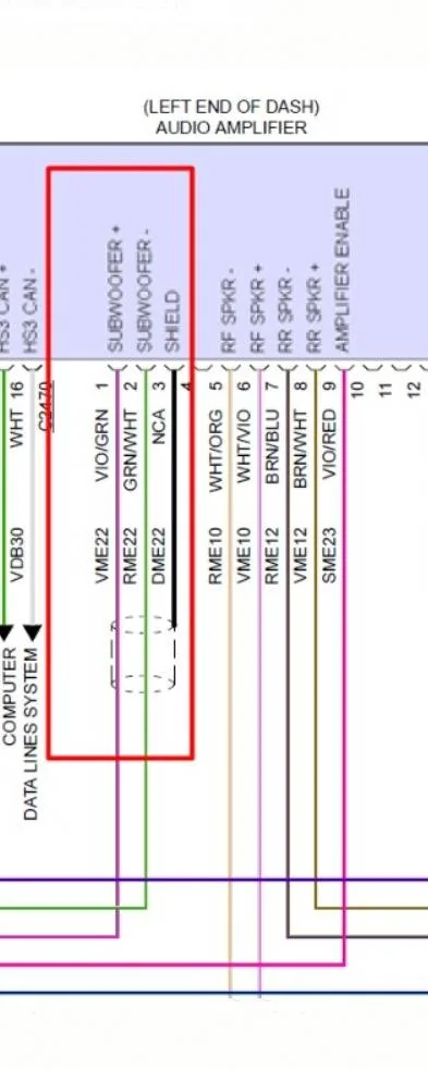

Hi guys. I read all 70 pages and did not understand. is it possible to connect a standard subwoofer to the amplifier from the 9-speaker shaker. Or you need to change the amplifier from 12 shaker
I have the 9 speaker system. There is no speaker out connections for a sub. You would need to add an amplifier, run power and take the signal from an existing speaker cable such as the rear deck. A LOC and Forscan would be useful too. I am not sure about installing a factory 12 speaker amp. You still would have no speaker wires to the sub.
I mean, does the amplifier from the 9-speakers version support the connection of a subwoofer
if i will make wires to this connectors from subwoofer? like 12 shaker

Test for a signal but I don't think so

That’s what I used to tap into that 12 speaker amp I bought
oh. Btw there’s no sub channel in a 9 speaker amp. I tried to hook the wires into my stock 9 amp before I pulled it
zero signal
swapped the amps out, same wires because same plug. Signal played from sub.
