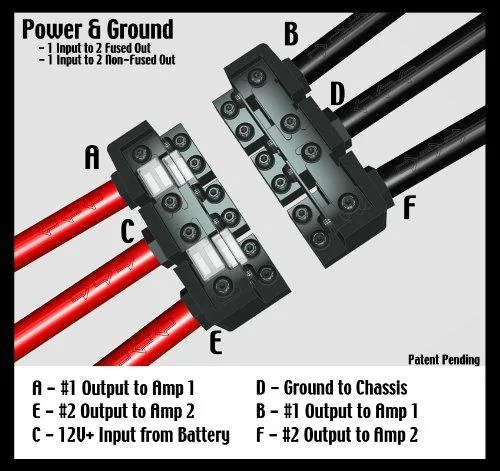

Okay. Just to be clear. my setup will be like the picture below. Are you saying to just add an extra small wire in the compression fittings of A and B for power and ground to the DSP? Because I won't have any "spare" outputs.
I'm not familiar with those dist blocks, but I would thing you could also put a small ring terminal on your power/gnd wires and screw them under one of the allen heads... would be a little more secure that way.

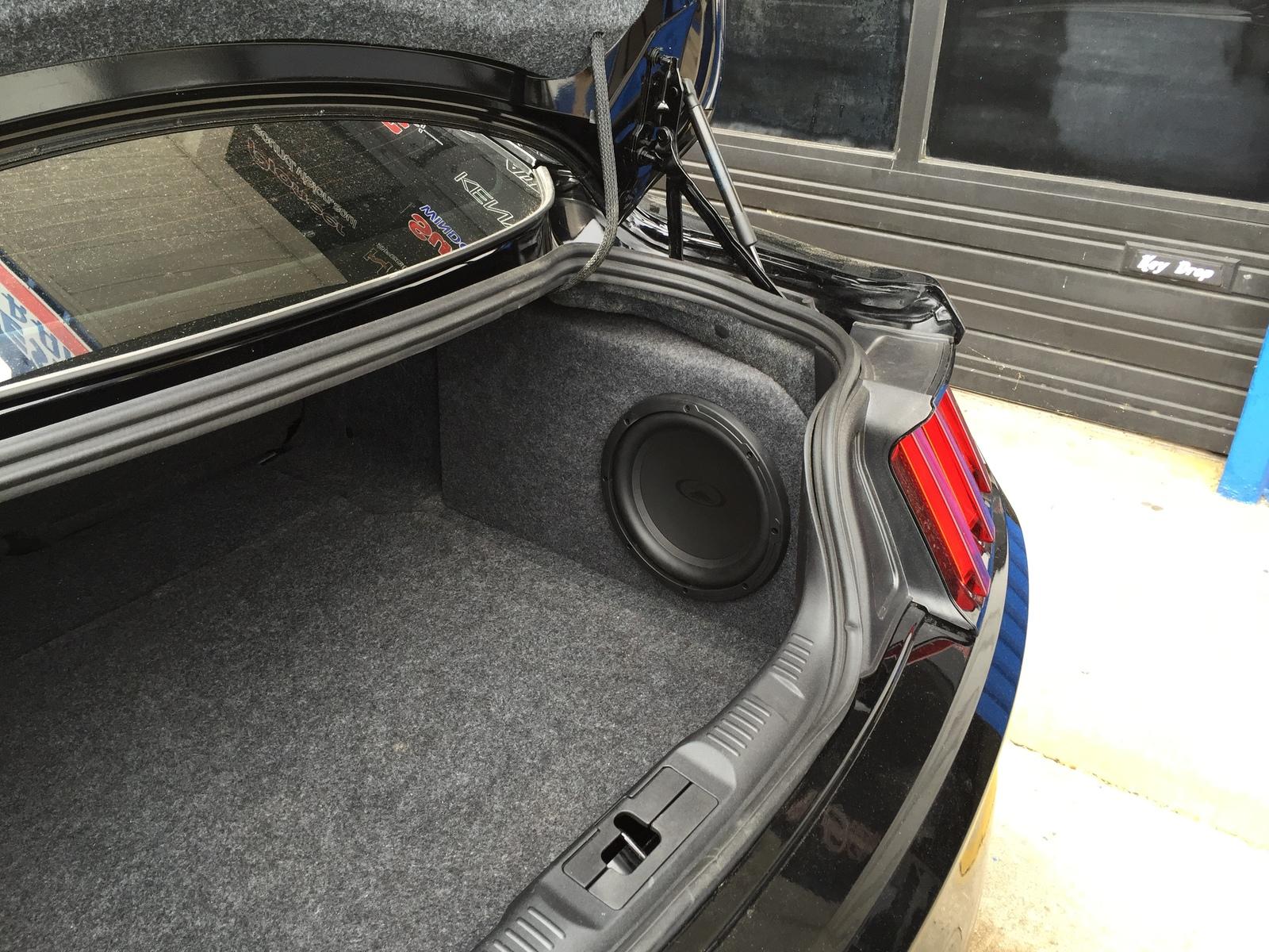

Custom enclosures can be expensive are you sure nothing premade will fit the convertible? I would assume the zenclosures wouldn't work but it could be worth a call to see if they have anything not on their site. Something like this from "audiodesginscg" could be an easy plug and play solution, but I've never seen a S550 convertible trunk to know what could work. Just a thought to save money on labor.
The cost surprisingly isn't too bad. Thinking about what he described, I don't think it's going to be a full enclosure... I think it will be more something to make the mount more rigid to avoid/reduce rattling...
Plenty of room in the trunk for sure, but I would rather not give up the space when I can utilize the current location of the rear speakers on the sides. I would think this will work fine given that I'm not looking for a big thumping low end, just good low end frequency.
