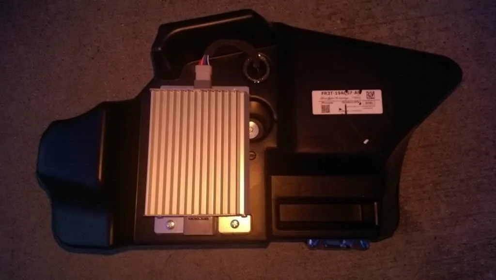

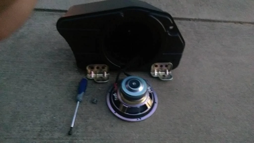

Subwoofer:
Amp: YanFeng Visteon S69GA (From Shaker Mustang, Fusion, F150 and Lincoln MKS) P/N: BA1T-18C808-AA (50Wx2?).

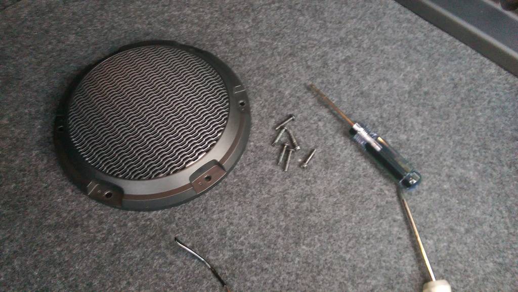

Speaker: 8 in. PAPER cone with foam surround model with 2 voicecoils (L, R) and the amp connection pinout is to follow. The sub has 6 T20 screws on the front that hold the grille to the case (through the SW flange) and one 8mm bolt that goes through the back of the case to the base of the Subwoofer. The speaker is only 4 in. deep and finding a replacement may be difficult. A Polk Audio db840dvc 8-inch dual voice coil subwoofer looks like a good match.
I would LOVE to know if this amp is 2ohm stable and bridgeable, a 100W 2Ohm setup would be awesome - HIGHLY doubtful though.

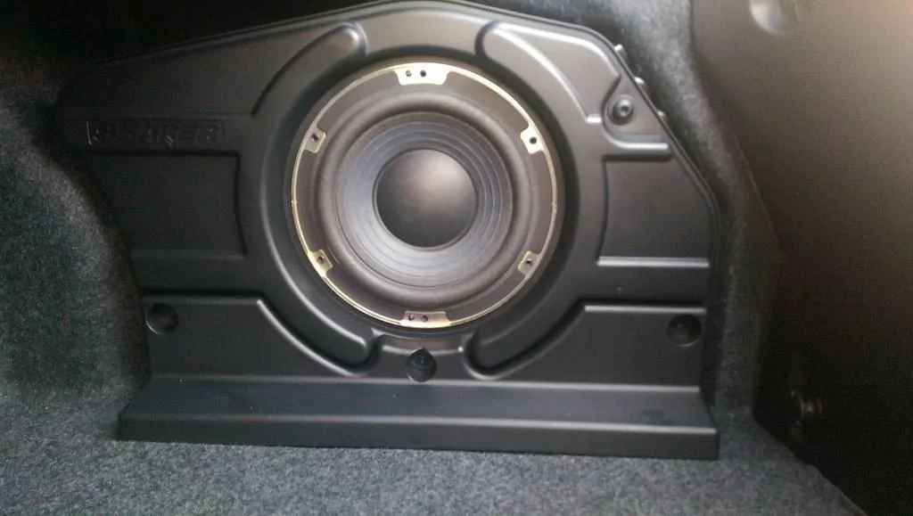

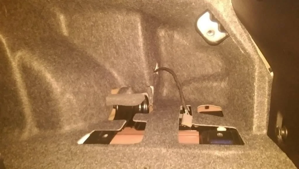

Installed
Cover
Mounting area - One Torx bolt, 2 - 15mm bolts under the cover (2 T-20 screws)

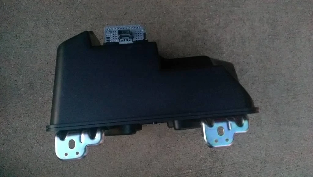

Bottom of unit showing Amp input connector
Front, grille removed

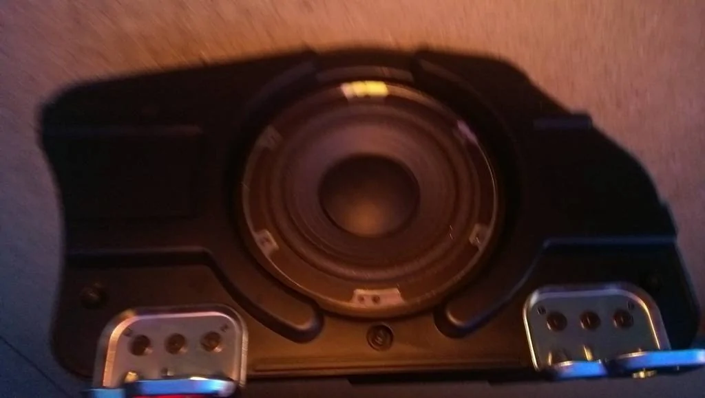

Back with 8mm SW mounting bolt shown
4 wires (L, R) to SW - ONLY marking is [CHINA] - Assuming 2 Channel 100W (50w+50w) 4 Ohm based on specs of the system overall.

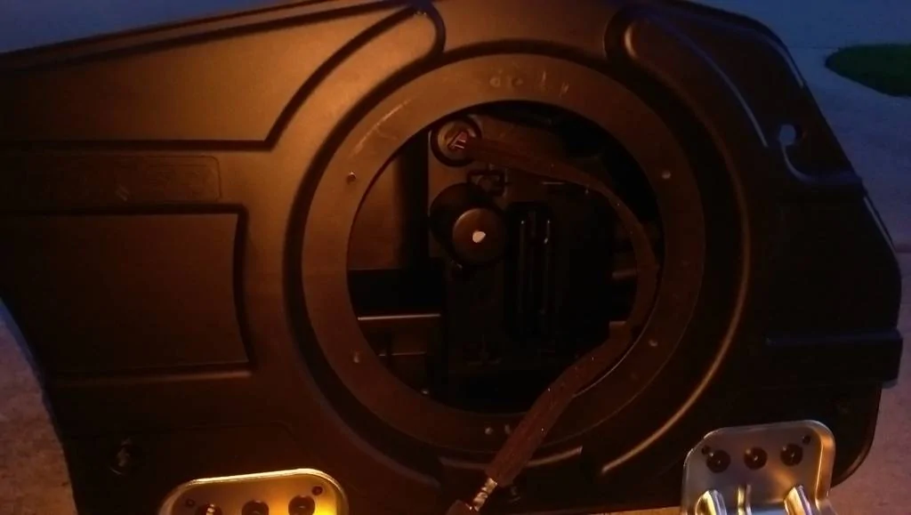

Interior of SW cabinet with NO port, no seal between speaker and box, no batting material and the mounting post in the center; no doubt to control the vibrations from the back flexing.
