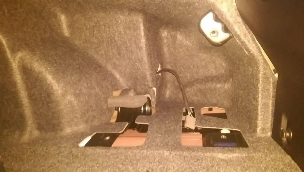

Thanks for the pictures and write-up. Is there any chance you can get a picture of the other end of the amp input cable shown above. ie. where it connects underneath the panelling? I'm looking for an input signal for a powered subwoofer on my non-Shaker Pro system.

Sure thing, I'll do it later tomorrow when I'm doing the pinouts.

Premium/Shaker cars have an amplifier in the drivers side kick panel area that is driven from line level feeds from the head unit. The center channel is "created" by the amplifier itself, not the head unit. The sub signal also seems to be artificially created as I see no wiring to suggest it comes directly from the head unit.
The subwoofer amplifier is located on the subwoofer box itself.
