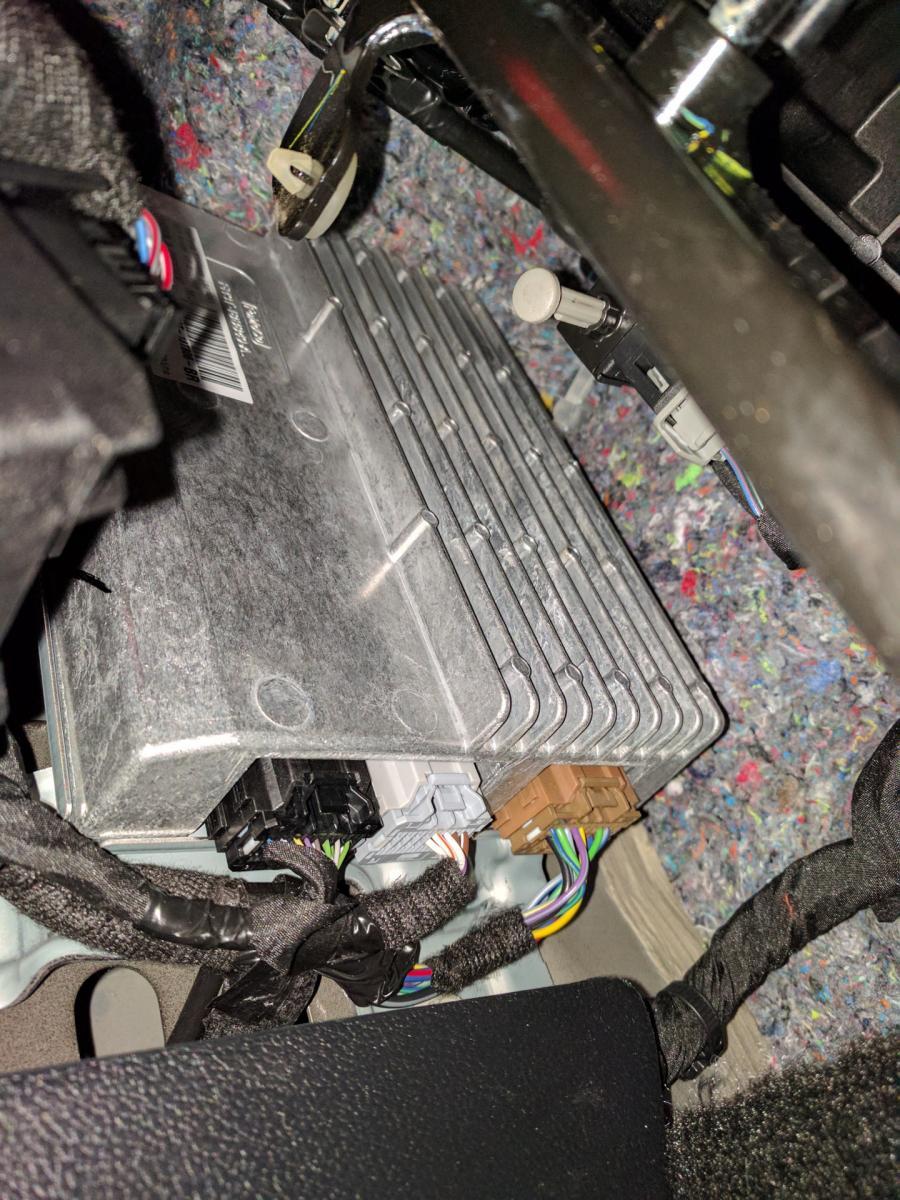

I didn't see any pictures of the premium amp in here. Can someone help identify the correct plug/wires for splicing in RCA's?
Considering this is hard to access, will it be worth the effort vs a LOC from a rear speaker?

I'm going to do some wiring on mine in a bit, so I'll get you that info...
The LOC will be much easier... I would use a tap over splicing though.

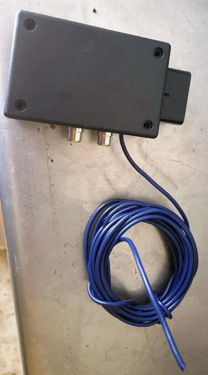

this is the custom interface that I made for the factory 401a shaker wiring.
It takes the low level output from the factory system, splits it into two rca outputs, and it also takes the factory amp (5.98 volts) remote turn on, and converts it (using a relay and the factory amplifier power and ground) to 12v.

There you go.Very nice job.Thats what I like to see,clean work.

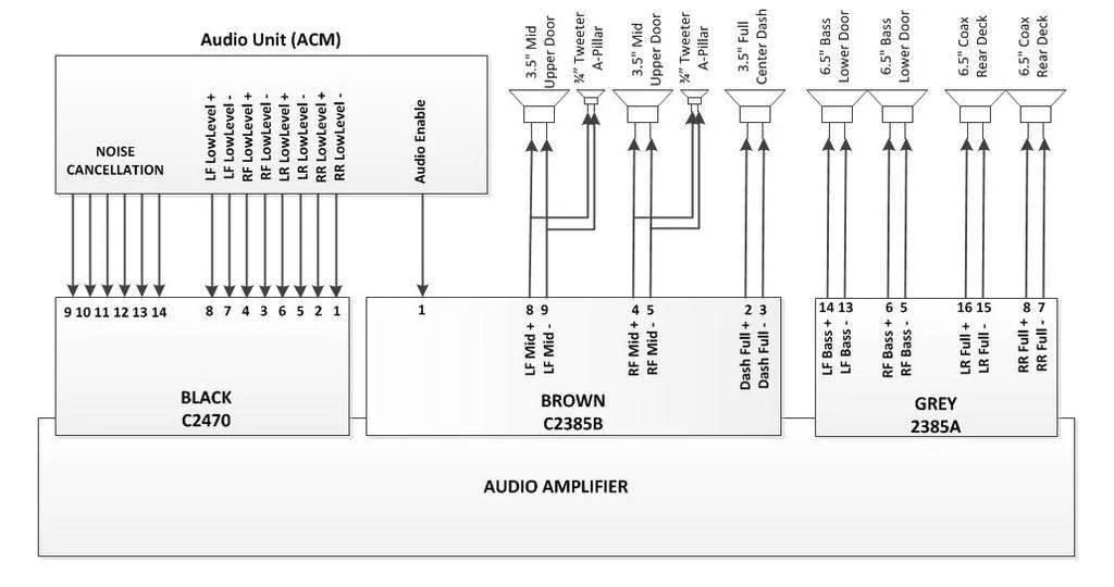

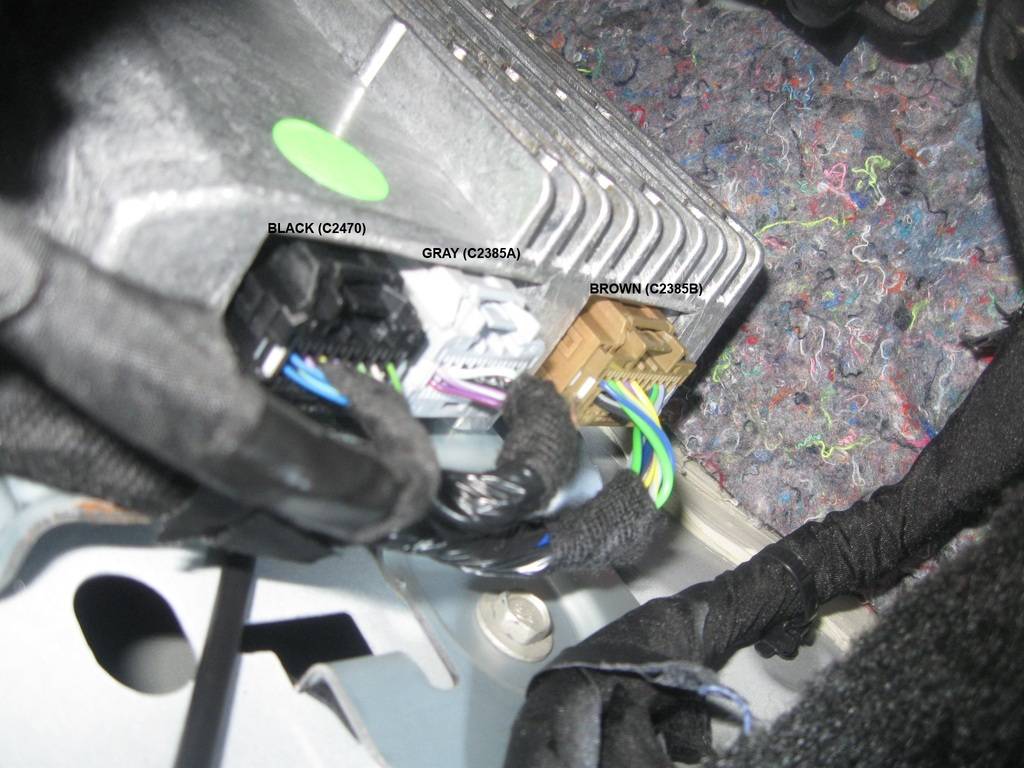

I had some wiring to do, so I thought I'd put together a diagram that hopefully simplifies the 401a system. The first pic shows the physical amp in the drivers kick panel with the plugs labeled, and the second shows the overall system. In the wiring, I didn't put any colors because a lot of the colors listed in this sticky didn't match what was actually in my plugs... so, I just concentrated on the pin numbers and functions. Hope this helps somebody :D
Amp photo
Diagram
I think you may have just helped me to identify exactly which pins to remove from the amp to disable the fake engine noises once and for all :)
Do you have to remove any trim panels to get to the amp, or is it just sat there?

The amp is not hidden at all its just awkward to get to since it's under the dash a bit. Stick your head in your foot well and look to the left side and up a bit
Awesome info there mumbles!
As Fenix says, you don't "have" to remove the trim panel, but it makes things easier...
  1. Pop off the cap on the hood release
  2. Push a 10mm socket into the hole of the hood release, and it will pop free the handle
  3. Pull up on the lower door scuff panels to create some room to wiggle the kick panel free
  4. Grabbing the rear of the kick panel, pull out towards the center console to free the rear retainer
  5. Still holding the rear of the kick panel, pull towards you to free the front retainers

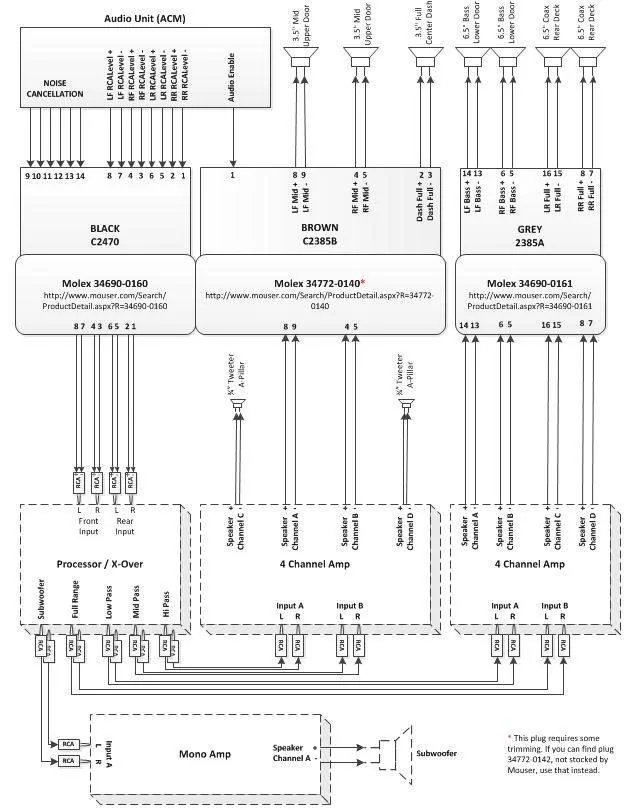

Ok folks, new diagram time...
This one shows how you would add aftermarket processors and amps by utilizing some connectors from Molex that just plug into the connectors at the factory amp. Racemaster did an awesome job using the 90 degree version of these plugs and enclosing them in a "project" box.
This diagram is pretty generic, so please remember that there are literally hundreds of ways this could be done... although I have shown the center channel speaker, it's just for reference and is not part of the amplified output.
