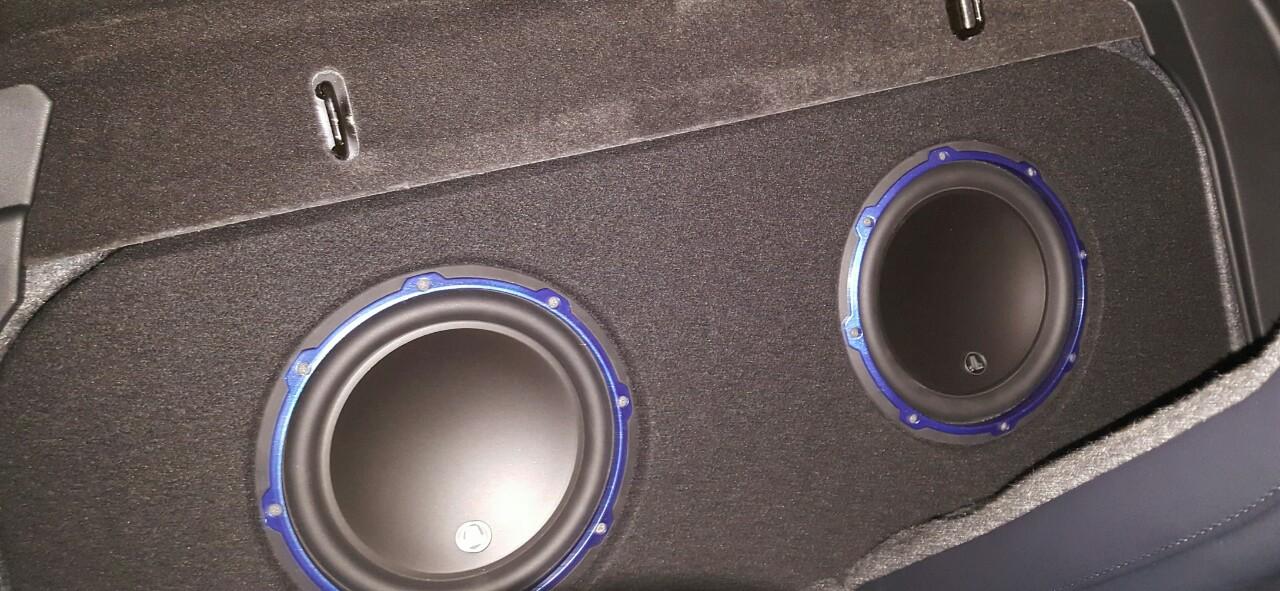

My sub install. Power wire route location.
Gpt my install done here's a picture to show you where you can run your power wire on the driver side there is an empty Gromit and it comes out right where the gas pedal is easy access. 10" jl w3 i used kicker loc and hifonics 1000 watt amp. Sound awesome. The box is custom for or cars by zenclosures. Perfect wall fitment. But with seats up you get some rattle. I plan on taking the sests out the back anyways.... what you think?
