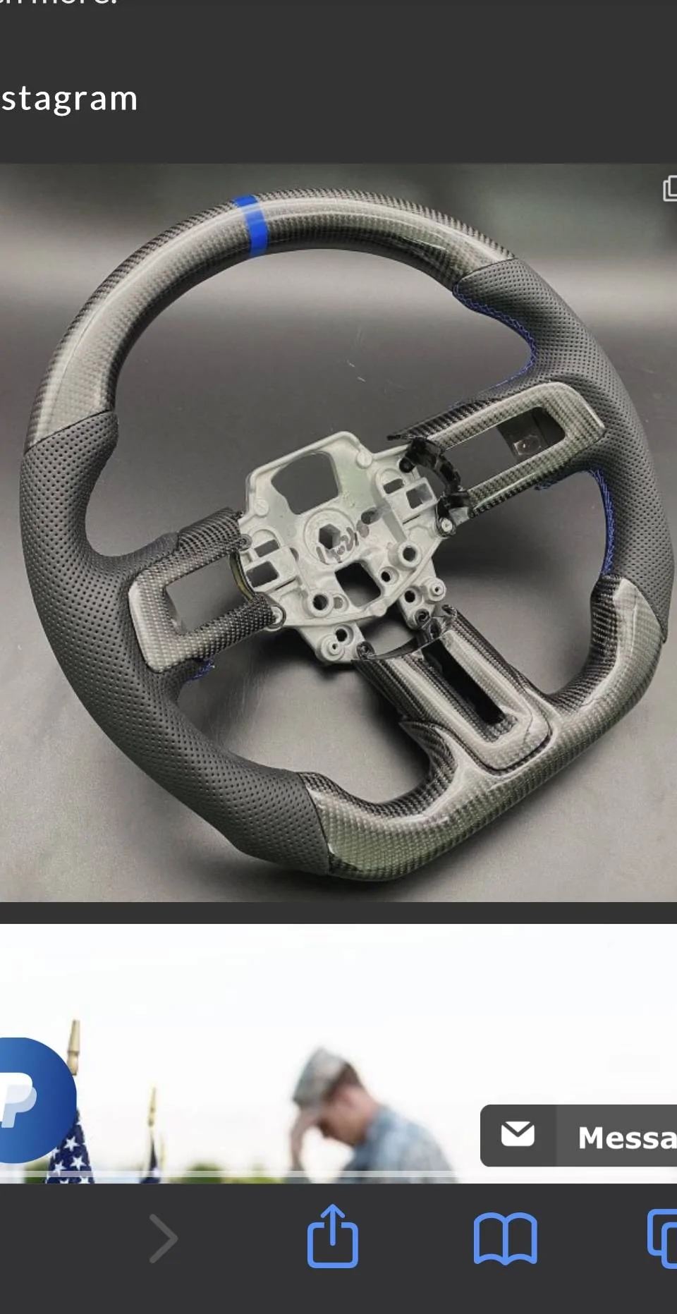

I appreciate all the feedback . I will take the advise and put it to use. I did get a new bolt already from LMR as I read it’s a torque to yield bolt and shouldn’t really be reused. This is the wheel I chose. I didn’t get the CF pieces in the middle parts where controls are. I think the stock silver ones will look better, if not I can always add them later .

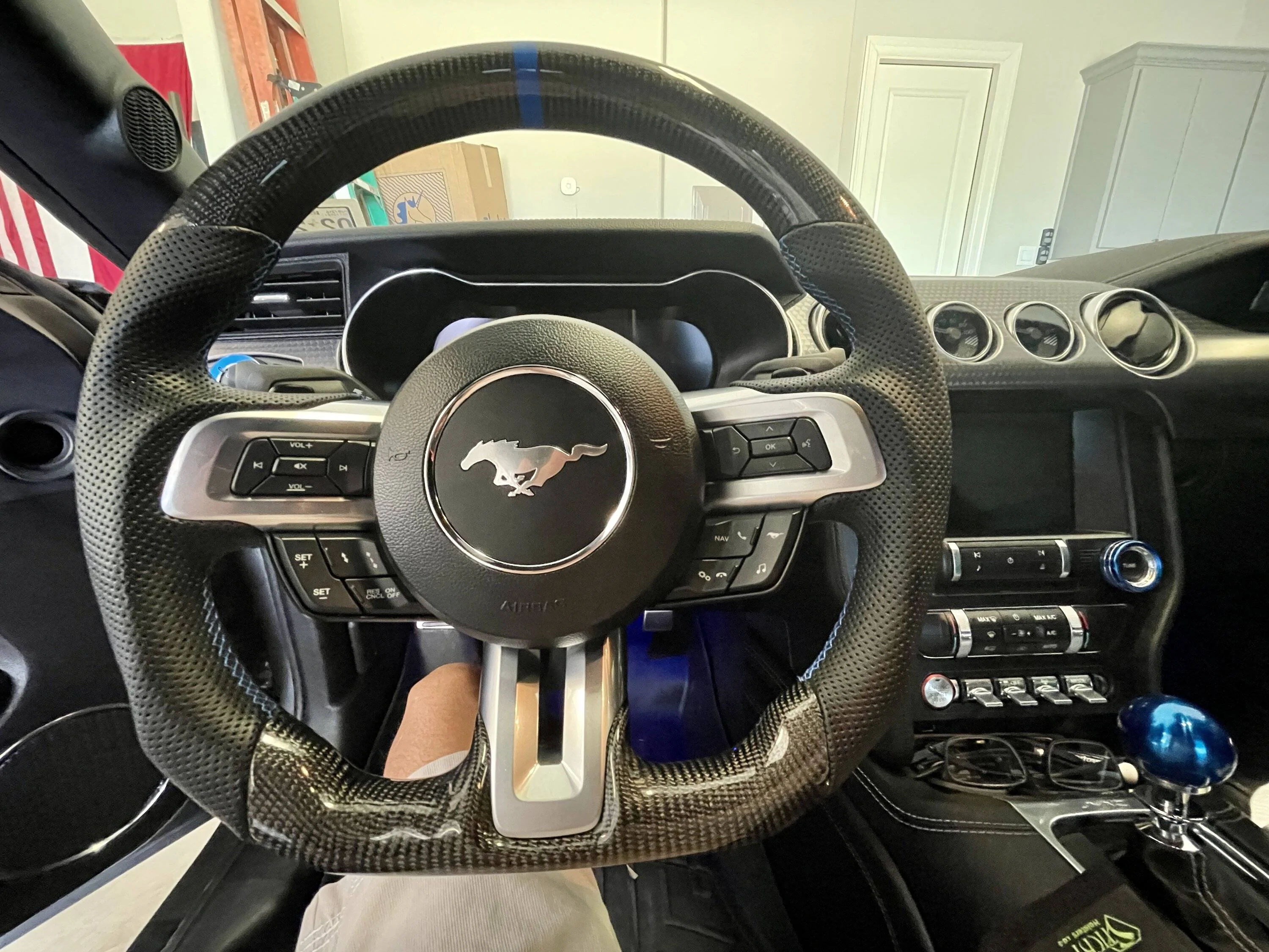

Just finished install . Wasn’t as bad as I built it up to be. My wheel did end up having the 24 MM steering wheel bolt and not the T50 nut. Def have to be careful of all the little plastic tabs on all the trim pieces. I can see how the can break easily.
