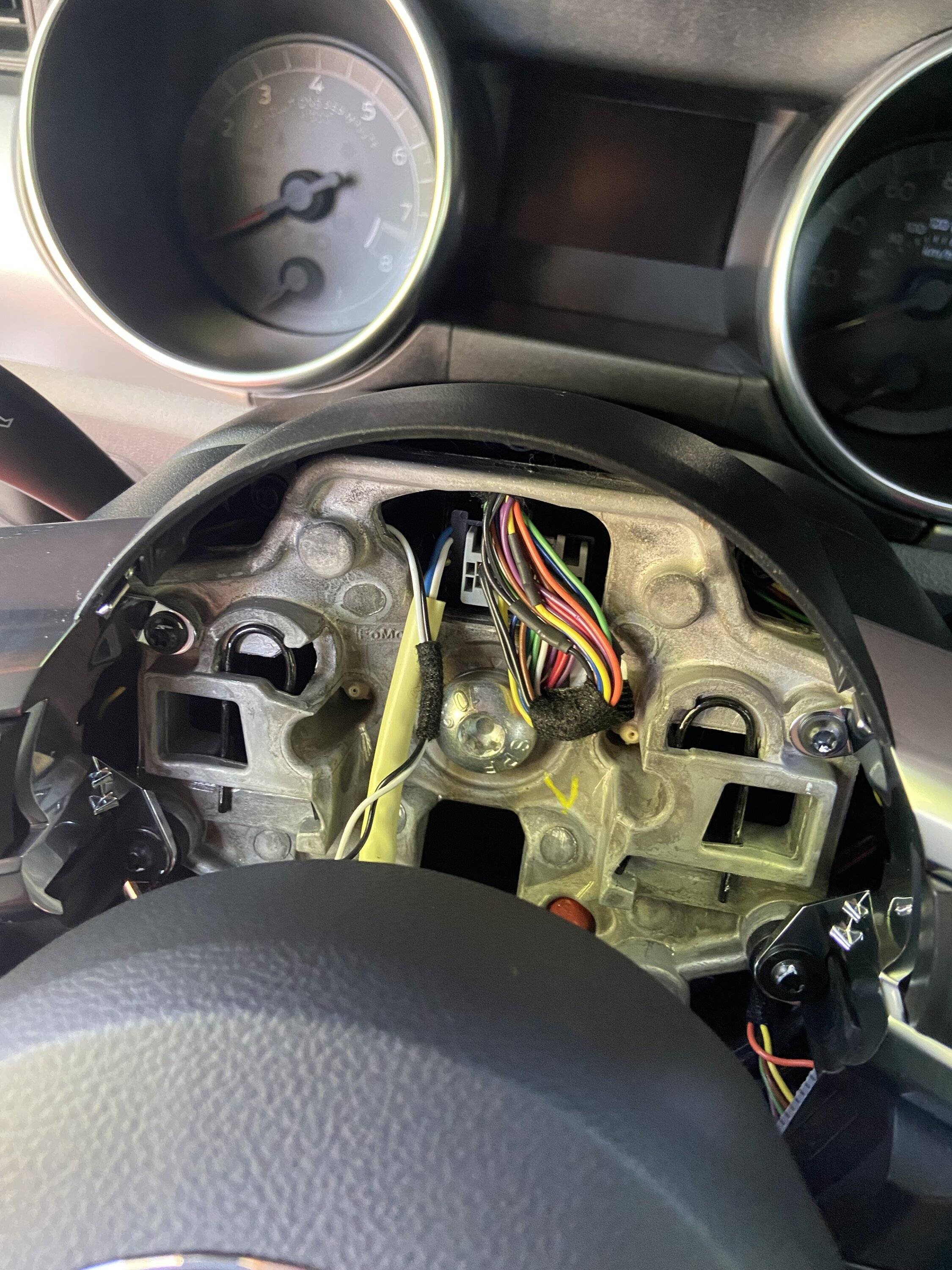

Hey everyone, I just got a 2022 Mach 1 and I already had a custom steering wheel for it. I went to put it on today, but came across a different steering wheel bolt than anything I’ve seen online or in videos. Has anyone encountered the same issue or possibly know what size torx bit I will need to remove this? Thanks for the help.

Wow, they definitely changed that up.
I've changed steering wheels on my 2011 and 2017, and it was just a big ass bolt.
Wonder why the change?

I hadn’t seen anything about a change anywhere online. Just went to Home Depot tho and a T50 torx bit did the trick

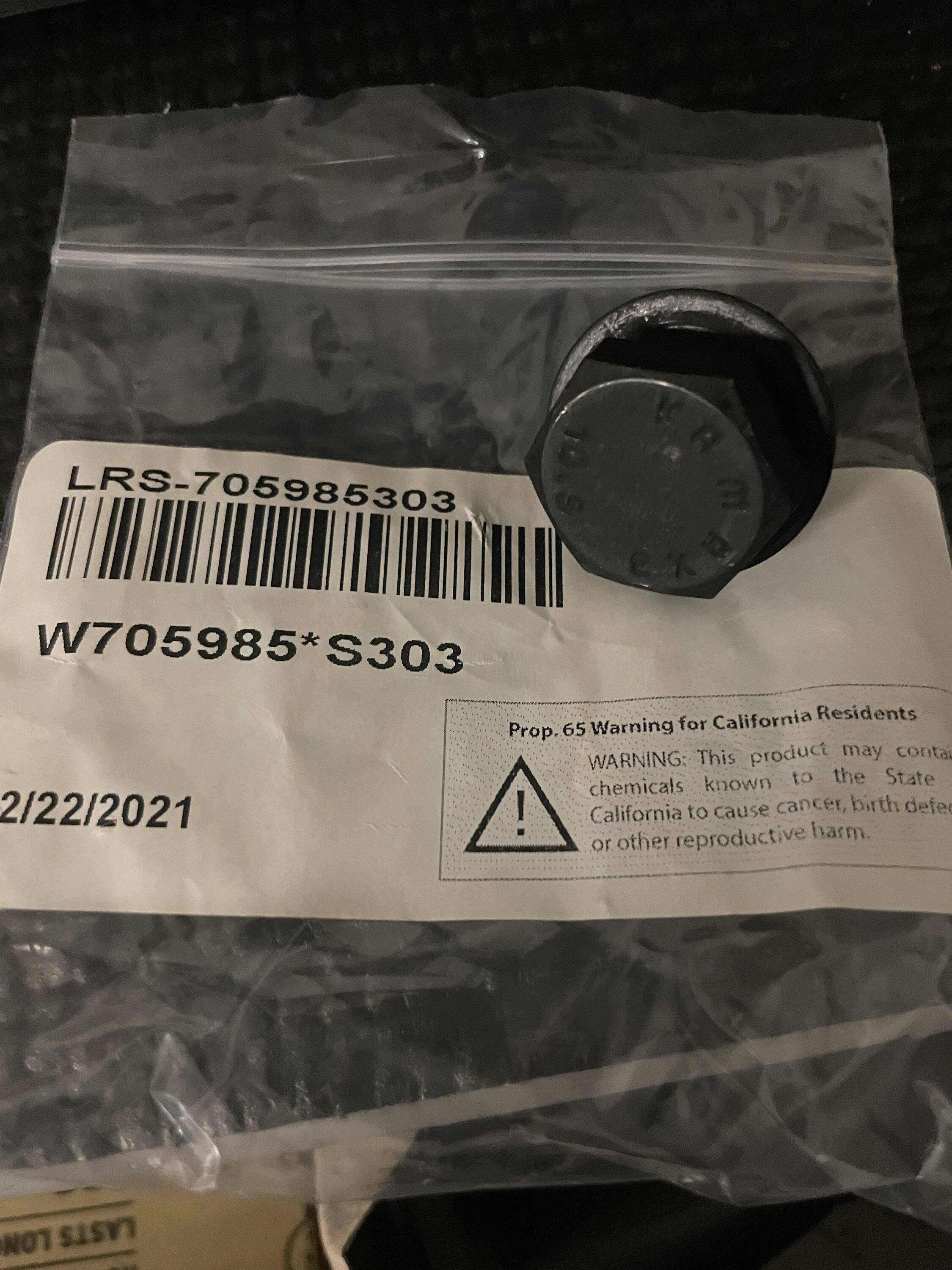

Interesting , I have a carbon fiber wheel on order for my 21’ GT PP .
I wonder what bolt I have.
Edit: just remember I ordered a new bolt from LMR because I read the bolt is a one time use torque to yield bolt and shouldn’t be reused.
Just opened package and this is what was sent .

Since it has a large Torx bolt now, it's most likely reusable (ie:not torque to yield). I am also thinking the change to a Torx is being used for either safety or anti theft reasons.

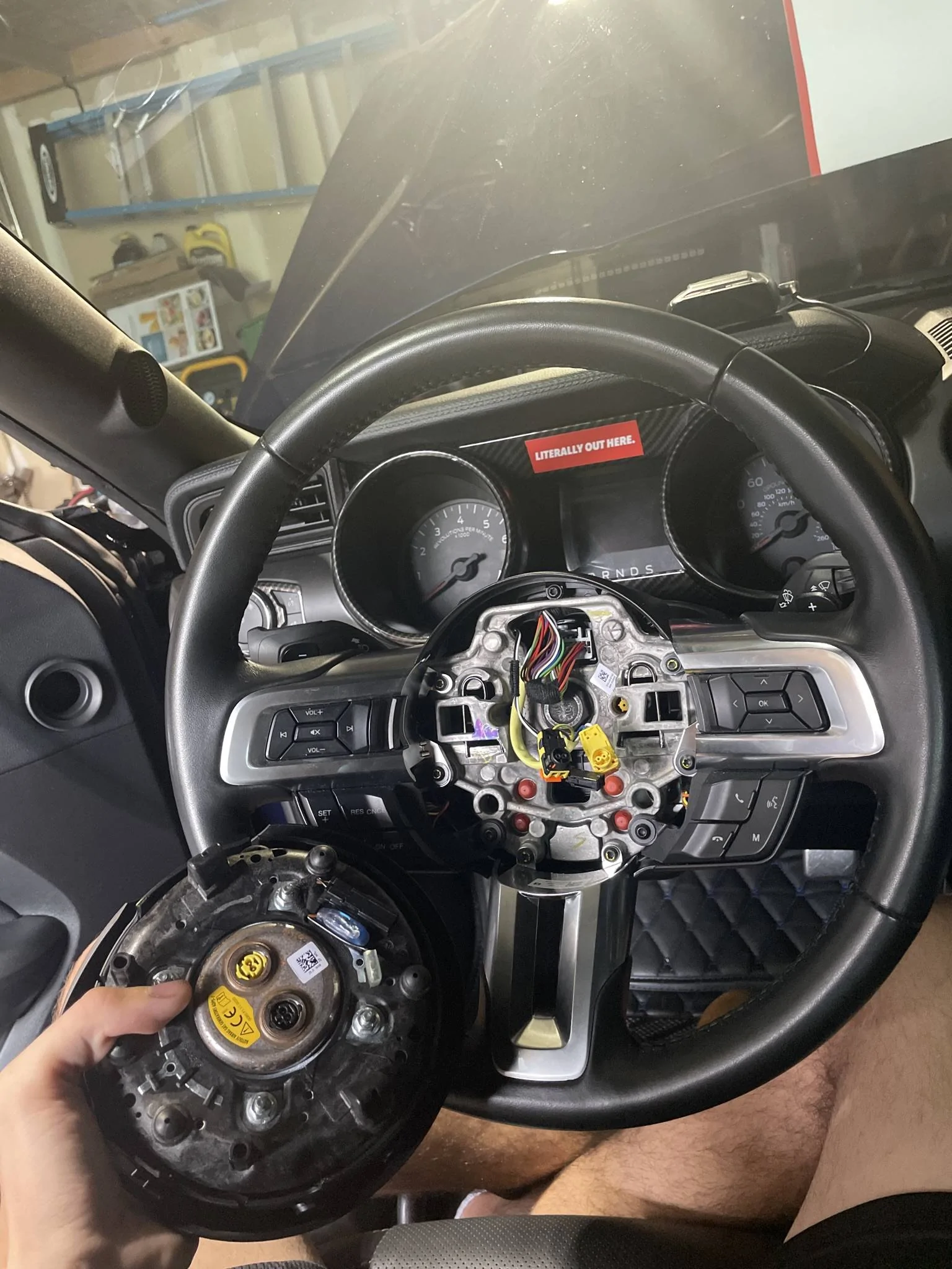

So 2022+ will require a T50 torx bit? and I can just reuse the torx bit on my replacement gt350r steering wheel? trying to make sure before I go to home depot

This is what i have in 2022 Mach 1 - not a torx bit
damn it. looks like I'll have to take the airbag cover off just to see which I have which seems to be a pain in the ass as is

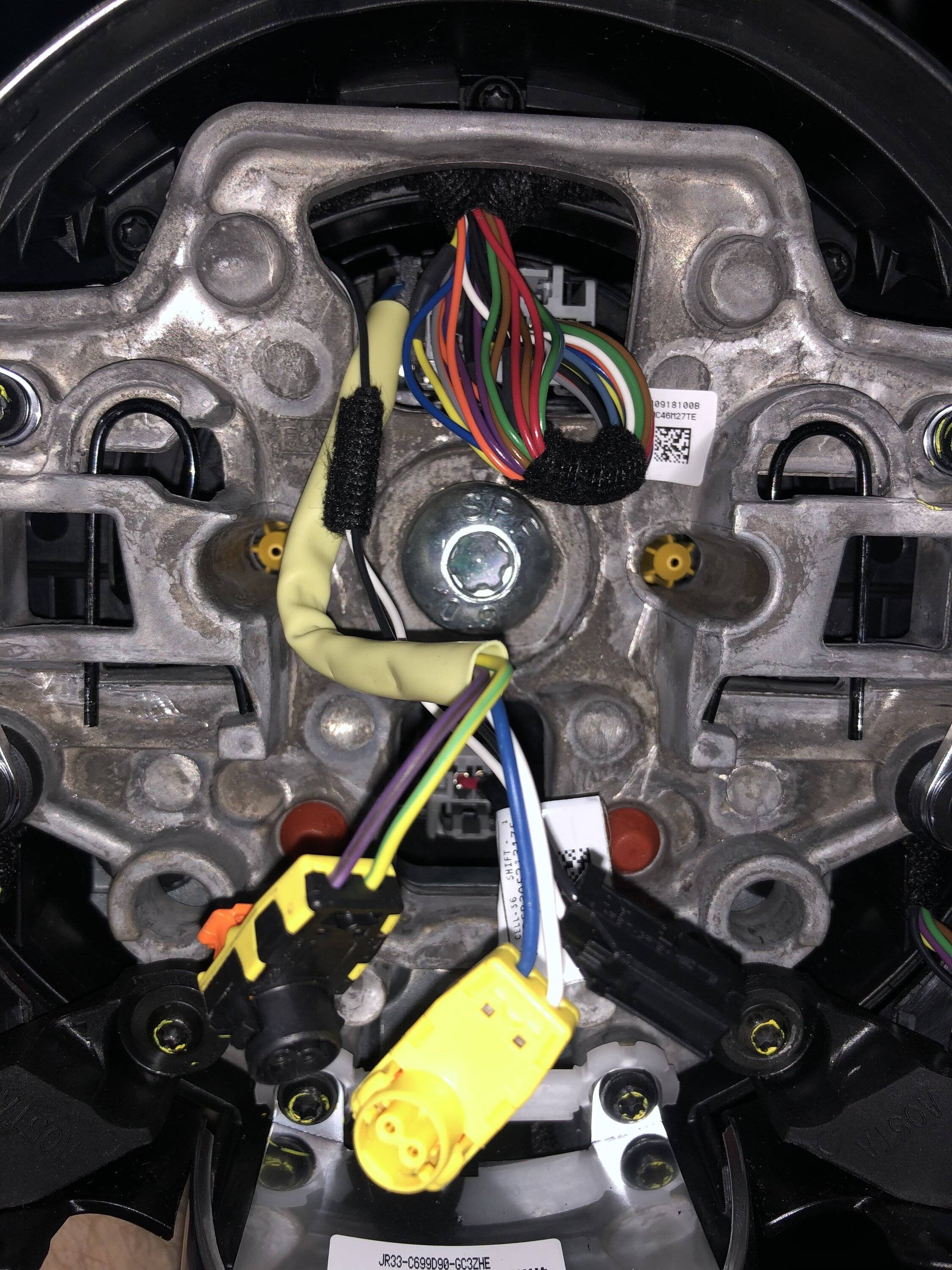

Look closely at the picture that OP posted of the bolt head, and you will see that the slots are kind of squared vs. the sharper teeth of a standard torx.

you were right! took me 5 mins with an allen key. time to see if any place local has that tp55
