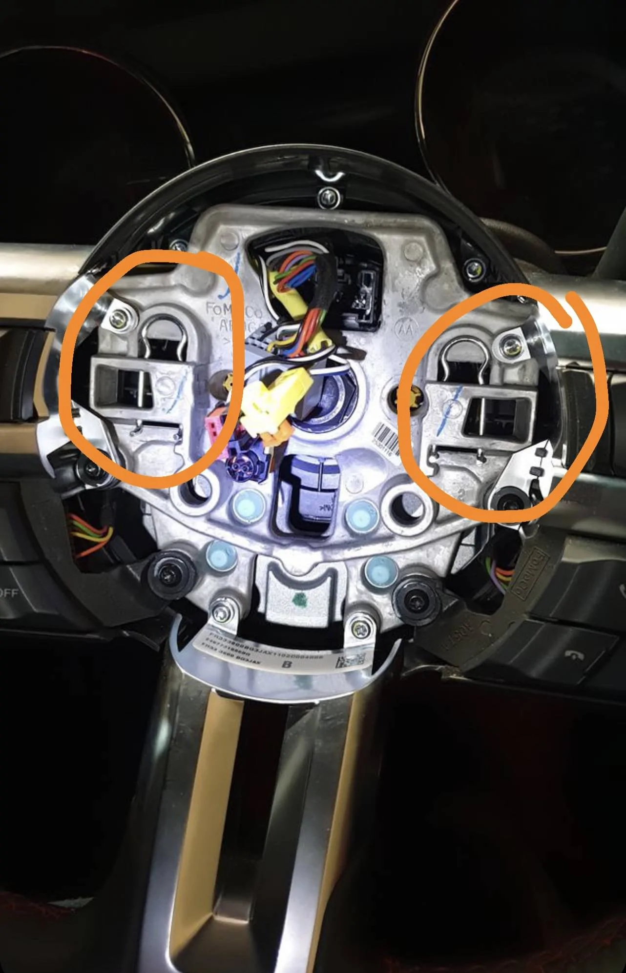

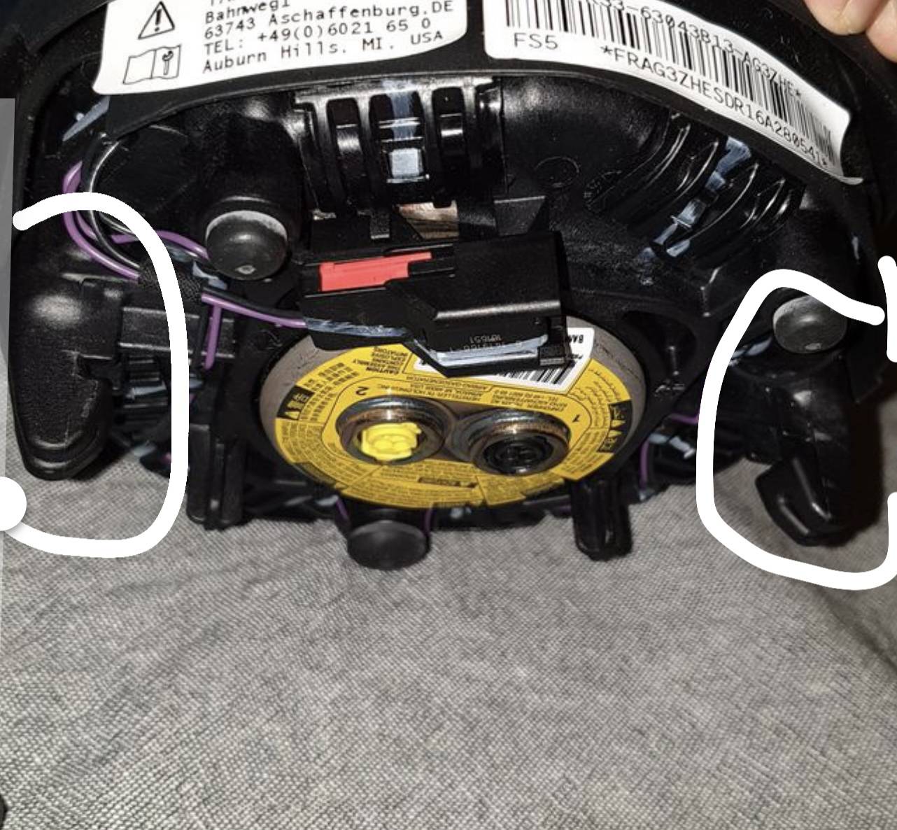

I used the long side of an allen key that could fit through the hole snuggly and also made sure that the key was a bit long as compared to the standard allen key set. You can see in the first photo the spring clip that needs to be depressed at the same time pulling the airbag gently towards you. In the second photo you can see the depth and shape of the hinge that is holding the airbag in place by the clip. Once you get one side out the other one should be relatively quite easy. Hope this help. cheers

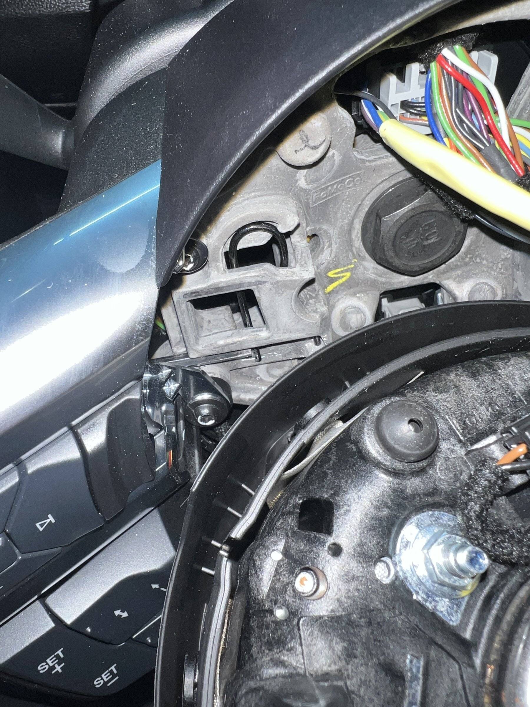

s1stl
Aug 21, 2021
Steve
2021 Mustang GT
Thanks for this thread. Was able to get the wheel off my '21 GT. The right side was done in first shot but it took a few tries to get the left one. Here's a picture of what it looks like inside. The clips are a bit different. I found what was needed was to keep the allen wrench pressed against the back so it glides into the clip. Used a 4mm t-handle.
Clip looks like my 16 ,you should go to Ford and get a new steering wheel bolt at the very least clean threads an apply Blue
Lock tite. bolt 1yr ago was only $4
s1stl
Aug 21, 2021
Steve
2021 Mustang GT
Thanks for the advice! Will do.
