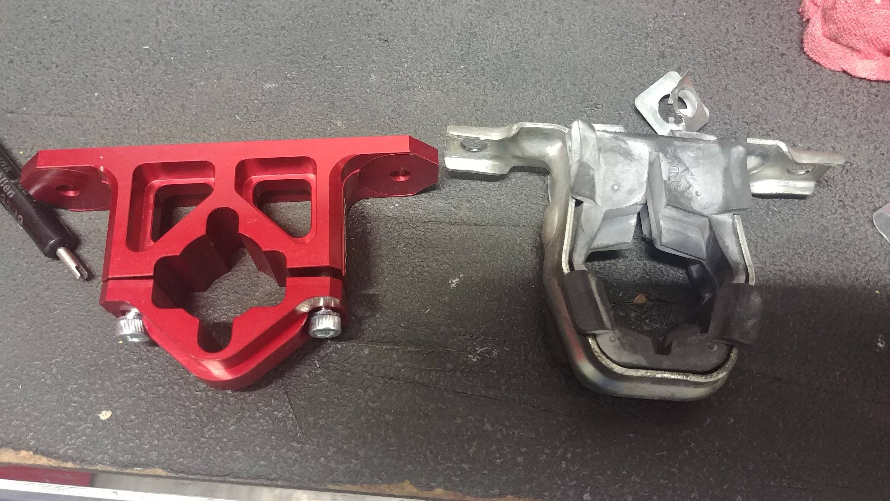

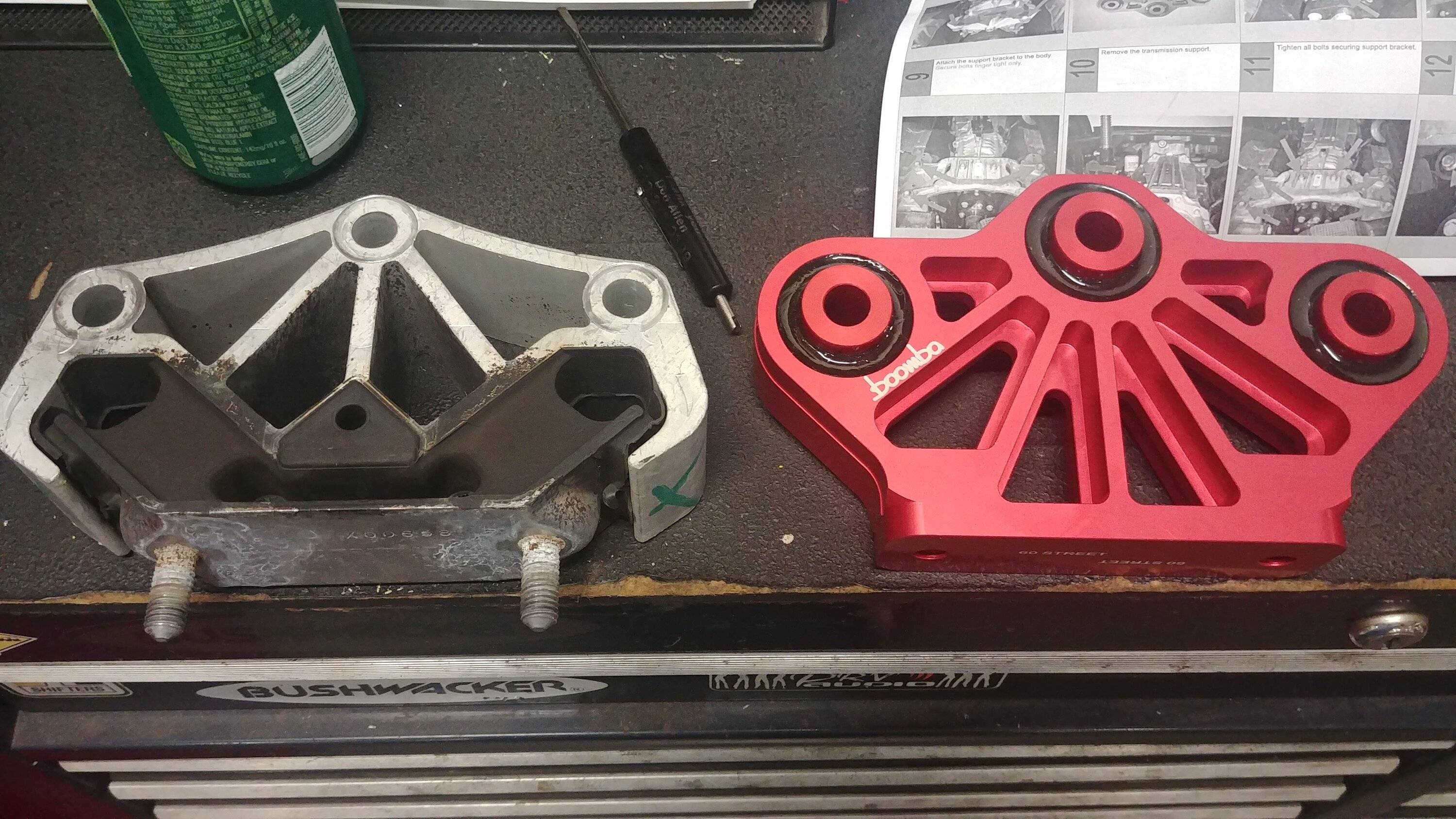

It's funny you say that because the more I drive the car, the more it starts feeling normal.. But I am going to leave the Bracket in and pop the insert back on and see how that feel's. If it calms down I'll leave it like that and see how things go.. ThanksHere's another option to consider. I replaced the trans mount and shifter bracket with Boomba parts and replaced the fluid with the BG Syncro II. I have no issues with shifting afterwards.
Pics below of both the original and replacement parts. There was very minor noise and vibration and Boomba says it "breaks in" which I don't know if that is true or if its just so minor I don't notice after a few drives.
