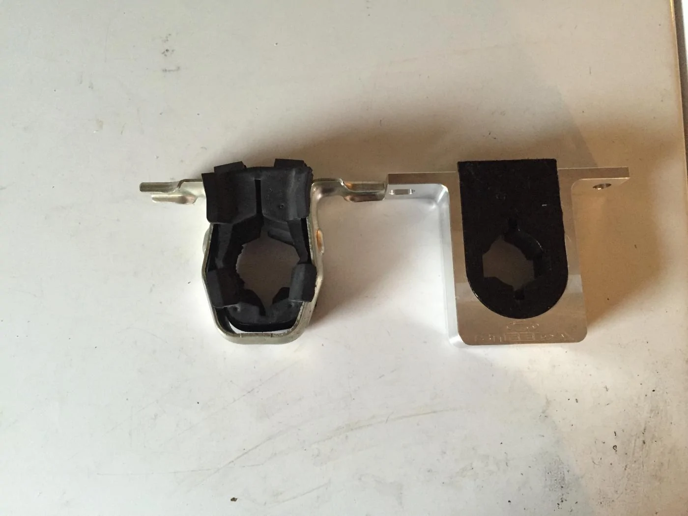

The clip you mention when removing the stock bracket, I assume when you install the Steeda bracket this clip is no longer required?

You are correct. Thank you!

Good to know, so if it makes these troublesome I can just go wild and tear that clip out and sling it in the trash can. :D
Once removed the clip is trash. It was pain in the ass to get off.

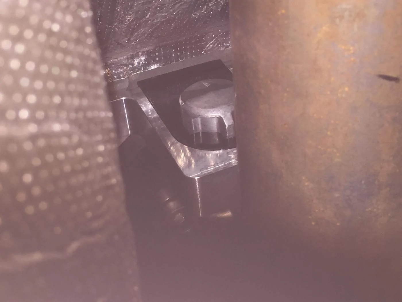

I know, I know, thread revival but as this is the best install video I've seen for the Steeda shifter bracket and this thread is the first search result on Google, I figured I'd add to it.
Did this install over the weekend and the OP's video is perfect though I wanted to add a few things
1. I was able to remove/install the bracket without lowering the trans or removing the exhaust. A bunch of socket extensions and some pliers did the trick.
2. That little clip on the passenger side is a major pain. Removing the clip took up 70% of the total install time. Just keep yanking at it and it'll eventually come off.
3. The video says to install bushing first and then slip the aluminum bracket over the bushing second. I found it easier to install the whole thing as one piece.
I only have shifting problems while on track so that'll be the true test but I definitely notice a difference even on the street. All the slop seems to have gone now.
