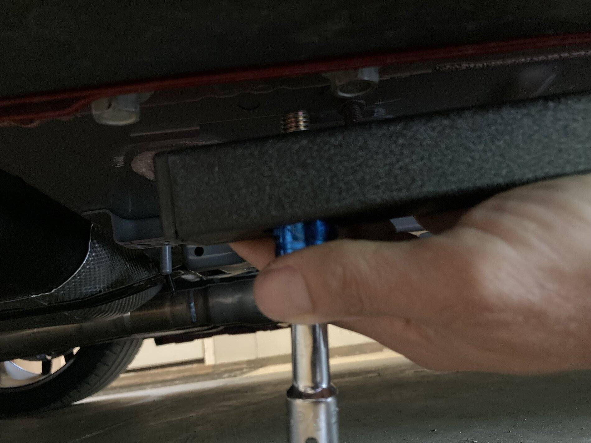

Installation requires rolling around on the ground and reaching under your car... Even tho they don't really engage when you raise the car on the lift - they do just enough that this needs to be an unimpeded installation. I looked at it as the only time I have to work on this car laying on concrete - ever... and that's a good thing :)
Only notable note of noteworthyness - RTFM... Like step one line one - which I didn't read until I was 30 minutes into being convinced everything was garbage and Steeda people were out to screw me personally... the jacking rails are slightly different lengths - and the shorter ones goes on the passenger side. And - they do in fact mean the longer one will not fit the passenger side no matter how hard you try to make it... no matter if you bolt the front or the rear first - it will not work... trust me on this point alone.
Here's an action shot of me attempting to install the wrong rail on the passenger side... it was an exercise in another one of my life's modicums... I was simply unable to find the hole.
The kit comes with 4 bolts per rail - but you remove 3 longer bolts to install on each side - so I reused the longer stock bolts and just one of the included ones. Dunno - all my life people told me longer was better - so I just stuck with that notion.
You do need a putty knife to scrape some of the frame sealant / glue / stuff off near the front attachment point on both sides of the car... that part I would actually, if doing another set, raise the car on the lift - clear that area with a putty knife - then lower in install the rails.

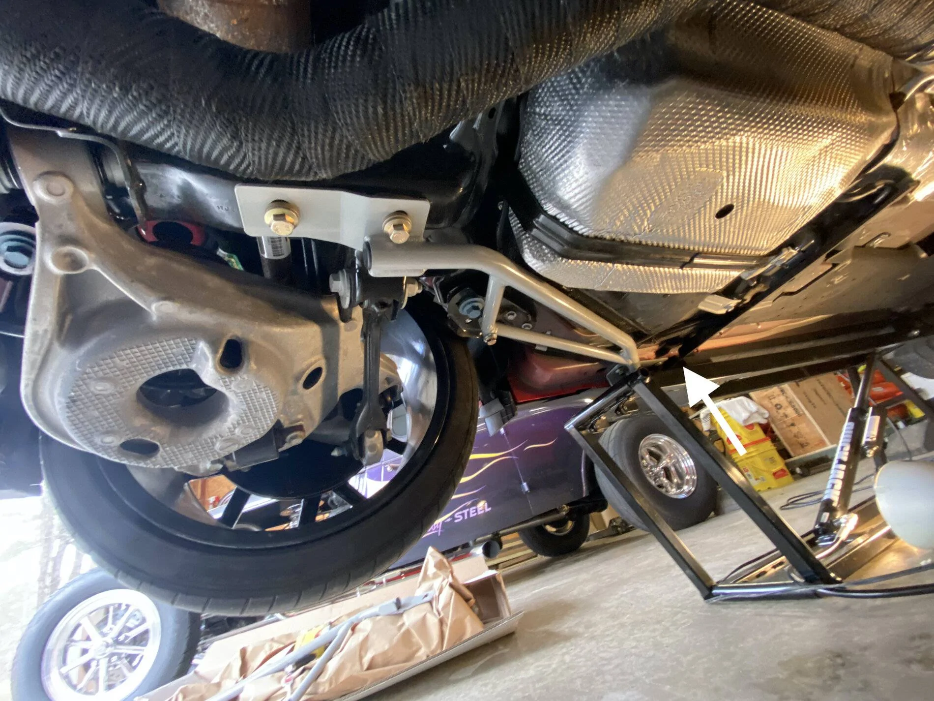

At first I thought the same, installing the rear sub frame support brace. Had the jacking rail extended further rearward. It would have interfered with the mount point.

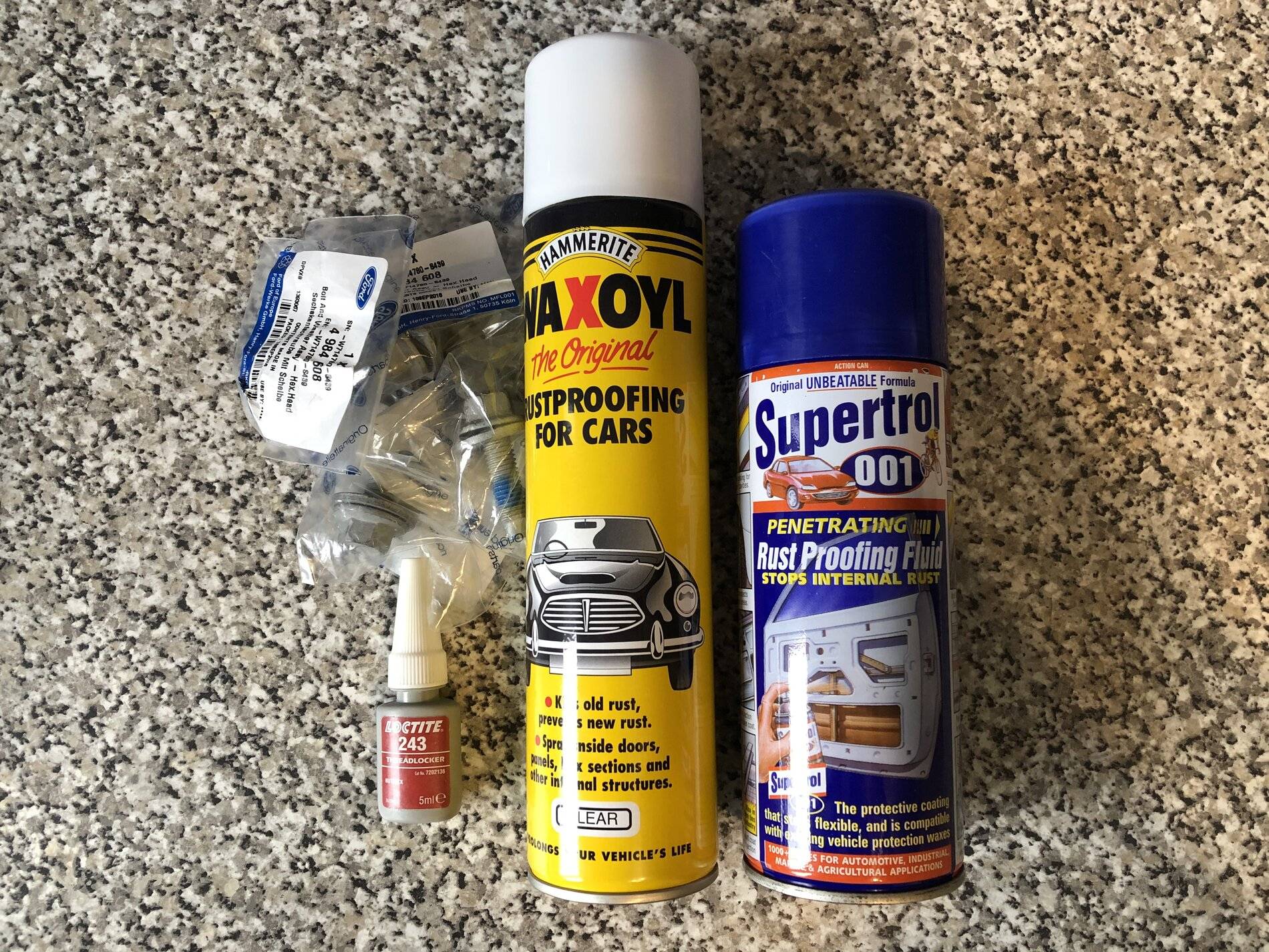

The factory bolts are grade 10.9, they have large diameter captive washers, pre applied thread lock, heavy duty plating and a unthreaded lead in to reduce the chance of cross threading - what’s not to like … ?
This was my installation kit :

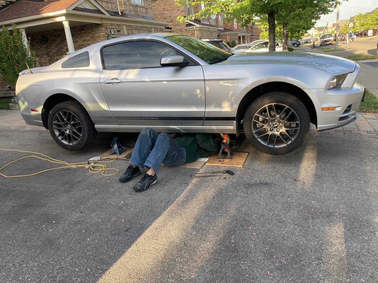

I installed mine with the supplied hardware. There must be some reason Steeda sent them. Other than that mine went on just fine, didn’t even bother with sealant scraping.
XeninWorX
Jun 26, 2020
648
1,017
Toronto
KC
2014 Mustang
No offense, KC, but that's a wee bit too shaky for this old codger. :-)
It was perfectly fine for hours. Perfectly stable. I kept tapping the jack stands accidentally with my elbow. Didn’t budge.
That also made me a little nervous. Things tend to slide down hill. That's not the way I would want to go.
