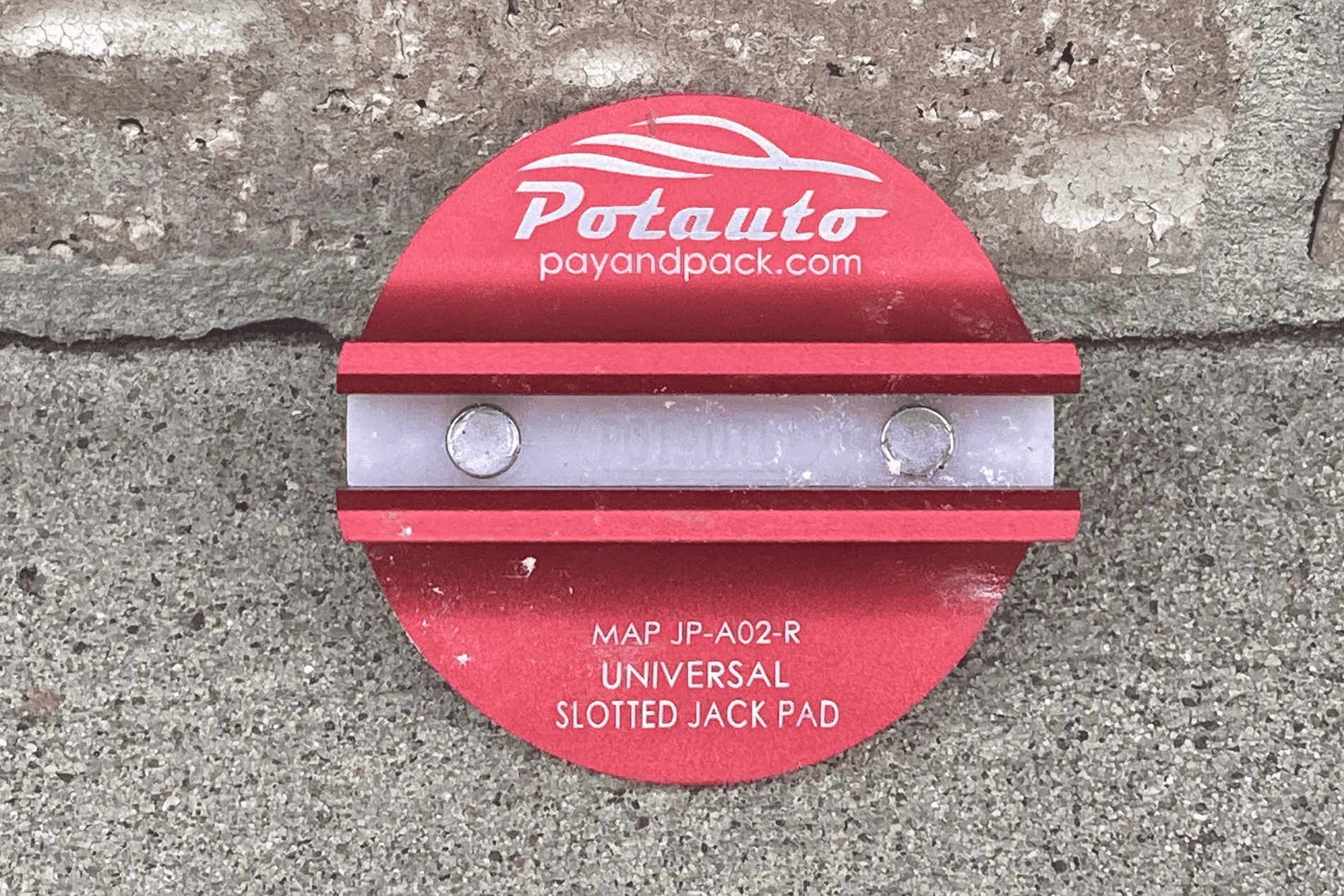

You'll also see a number of posts on jacking rails or "pucks I call them. Small blocks of aluminum that sandwich the pinch welds and are held on with set screws to provide a more solid base to jack from. That way you don't heavily distort the pinch welds.
A number of places sell them. Pretty basic. I recommend getting jacking rails that have been anodized to help prevent heavy corrosion.

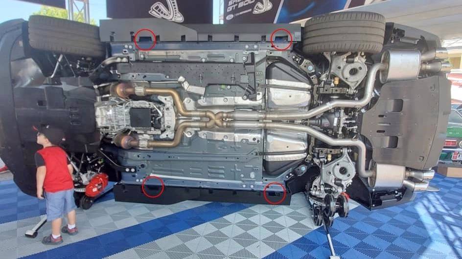

I believe the owners manual has that. The same location used to lift the car if you have a flat.
However jack stands are another story. And yes there are threads with the underside pictured, and positioning pointed out.

get some jacking rails....there pretty inexpensive.....then it takes out the guess work and can lift it anywhere in a 4 foot section easily
