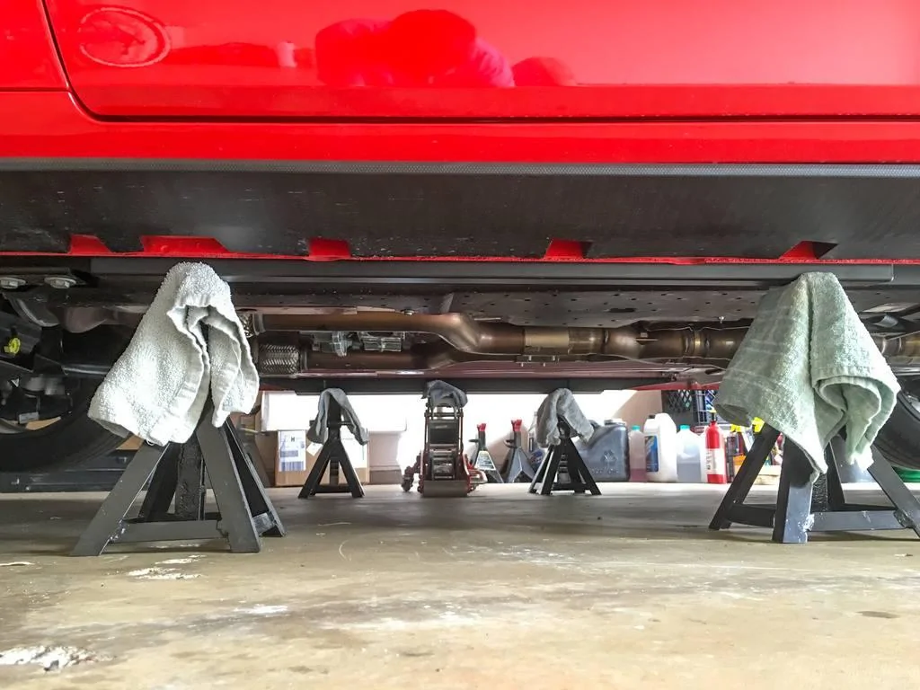

It does look sketchy but it was rock solid. I believe this is a common false concern with the Steeda jack rails from what I've seen posted around. I didn't want to put them any further out on the jack rail as the stands wouldn't been sitting on the welds where the tube is welded to the brackets.
You can move your stands closer to the ends, actually over the welded area of the rails is the strongest section, and the safest, to support the car.

As the car was in the pictures, it felt fine. I wasn't climbing in or on the car, just changing the oil. I placed 2 additional jack stands under the front as a "just in case" measure but the car never budged at all.

wow it never occured to me that the jacking rails would locate the rear stands so far forward... like someone already commented above, is that safe? especially with so much engine weight up front? :eyebulge:
That is literally why they are so far forward. Because that is where the center of gravity is, closer to all the mass. However I personally would want to see them much further apart from each other if doing any kind of extensive work.

Even if I only used the jack rails as a jacking point and put stands in the areas you'd use a post lift at, they'd be worth it. I've never had such an easy job of getting a low-ish car like this on 4 jack stands before. My GTR especially took me 20+ minutes to get it up on stands. Similar story with other cars I had/have: 97 240sx, 91 Miata, 12 Mazdaspeed3.

Installed them today. Used the Steeda supplied bolts as they are only a couple threads shorter than OE bolts if the OE bolts were used with their washers. I noticed the OE bolts had what looked like blue thread locker, so I used blue loctite on the Steeda bolts.
I did not remove/trim the seam sealer, just installed it on top as several of you all did. It's super easy to get the car up on 4 jack stands, the easiest of any car I've ever owned now! It looks a little sketchy with the jack stands all inboard but worked well today for my first oil change.
I took a pic while under there of what seems like the seam sealer getting squeezed out the side of the jack rail bracket.
