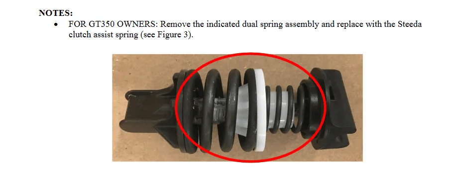

Just reinstalled my Steeda clutch spring after complaining to a friend about how stiff it felt after driving another GT350 with the stock spring. Turns out mine was installed correctly about a month ago, lol. I actually took it to a shop a month ago after having problems with the removal of the stock clutch spring, and they just followed the instructions on the site. One thing it didn't mention (and there's plenty of topics here of course) was the removal of the plastic part + extra spring that's installed only on the GT350s. [MENTION=7748]tj@steeda[/MENTION] would you guys be able to add a note in the PDF for this?
I know it's clear as day on the forums here, but I almost wonder if there are any non-forum members that did this too based on the instructions. I was getting ready to ditch the spring last night until my friend told me about this. It's so much better now that it's actually installed correctly.
I will definitely pass along this feedback ... thank you for the heads-up!
Glad you didn't ditch the spring & you are now reinvigorated!

It does come with instructions. After a trip to the store to pick up some needle nose vise grips, ended up not using them, compressed the assembly by pushing on the lower perch till it unseated the pin, then reinstalled it by seating the upper perch and pushing on the lower perch to compress it enough to seat the pin.

Apparently not alone but very much in the minority. Installed the Steeda spring and really didn't care for it over stock. Marginally higher pedal effort but for me if anything the engagement feel was more vague and non linear so back in went the stock assembly and I am much happier. Will run it this way for a while then maybe try it again and see how I feel about it. As for removal of the spring assembly, what worked best for me was to pull down on the top spring seat and then it easily pulls away. Exact reverse to re-install, no tools needed. Initially tried the needle nose pliers, both regular and vise grip and could not see how that could possibly work as in my case nothing was compressed enough to make any difference in removal.
