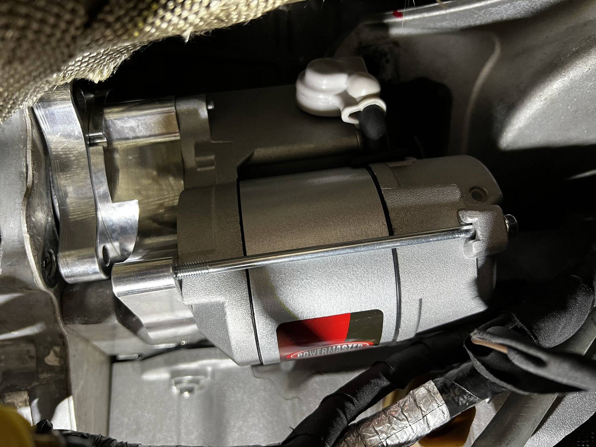

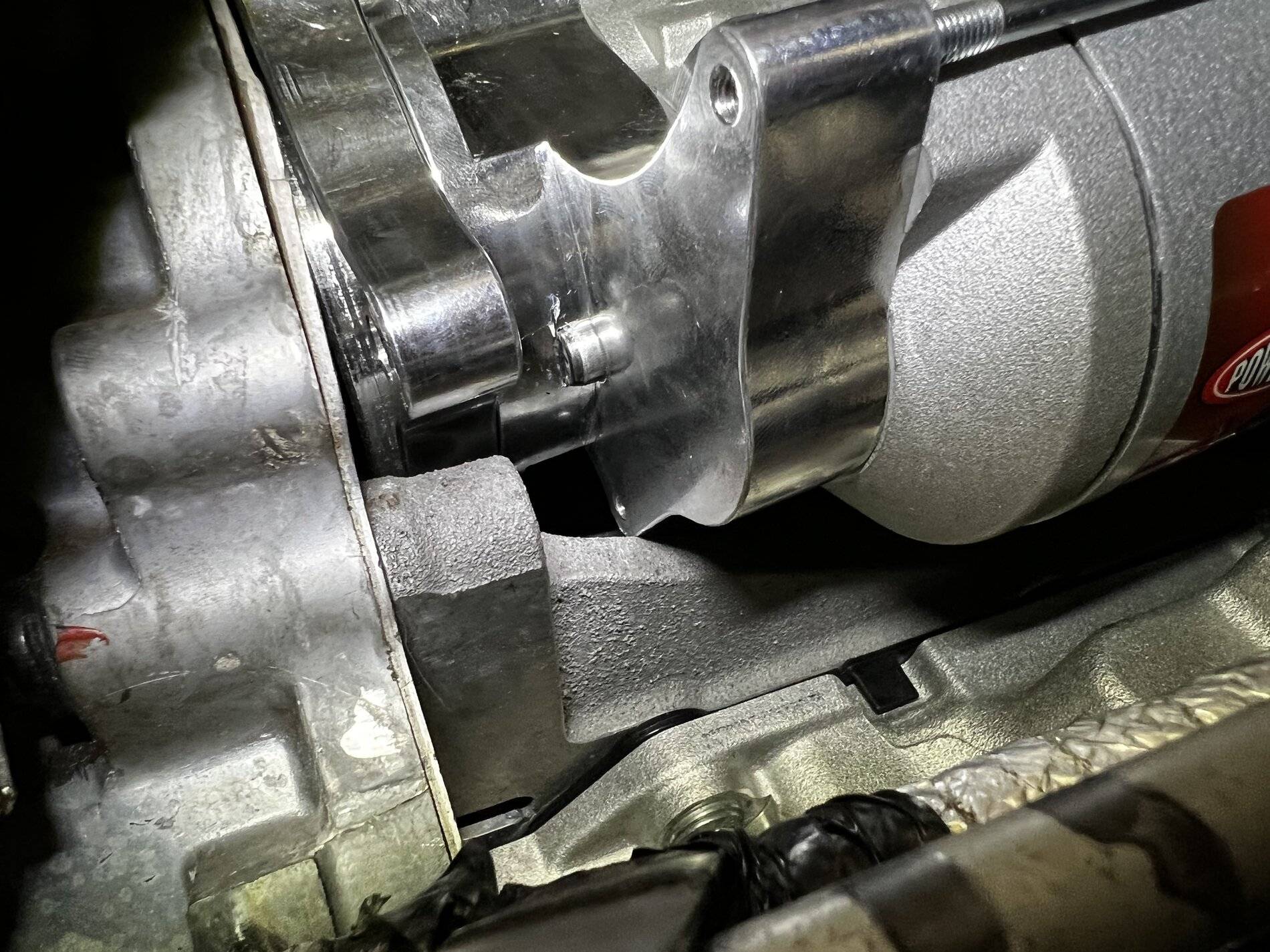

Okay - got the PowerMaster starter and having fitment issues. Was there a block change in this area with earlier coyotes?
@bauern do you happen to know?
honeybadger
honeybadger
Just don't care
Apr 20, 2016
63
4,089
7,429
COTA
Kevin
'17 GT350
Never mind. You can disregard. I found out how to adjust the base and pivot it a bit

So far so good. It spins the engine over faster and sounds like it takes less effort. No signs of any type of issue. Only time will tell if it handles the heat and vibrations, though.
ChipG
Jan 27, 2021
33
532
590
Nashville TN
Chip
'20 GT350/'95 F250/'65 Fastback/'96 Cobra Project
Which PowerMaster did you get? Any installation notes other than clocking it? I'm tired of waiting on my dealer's badly backed up service department which has had my car in twice and has been "unable to replicate."
