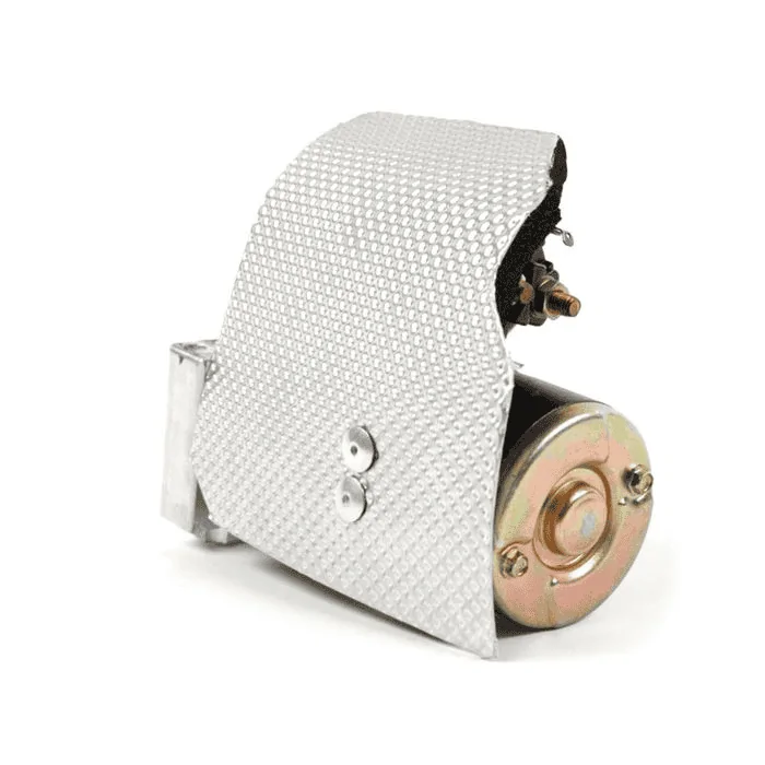

What type of insulation was used on the starter wire? Proper heat shielding? Or just more wrap?
And for the solenoid heat shield, was it something like this?
The wire had nice, proper shielding something like this:
https://www.designengineering.com/aluminium-plug-wire-sheath/
Covered all the way from the chassis to the connectors.
This is the starter wrap I used on both cars:
https://www.amazon.com/dp/B01GIL1O22?ref=ppx_yo2_dt_b_product_details&th=1
The one in your pix looks pretty nice as well.
