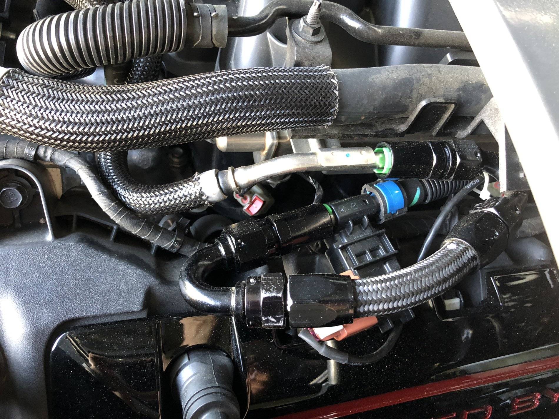

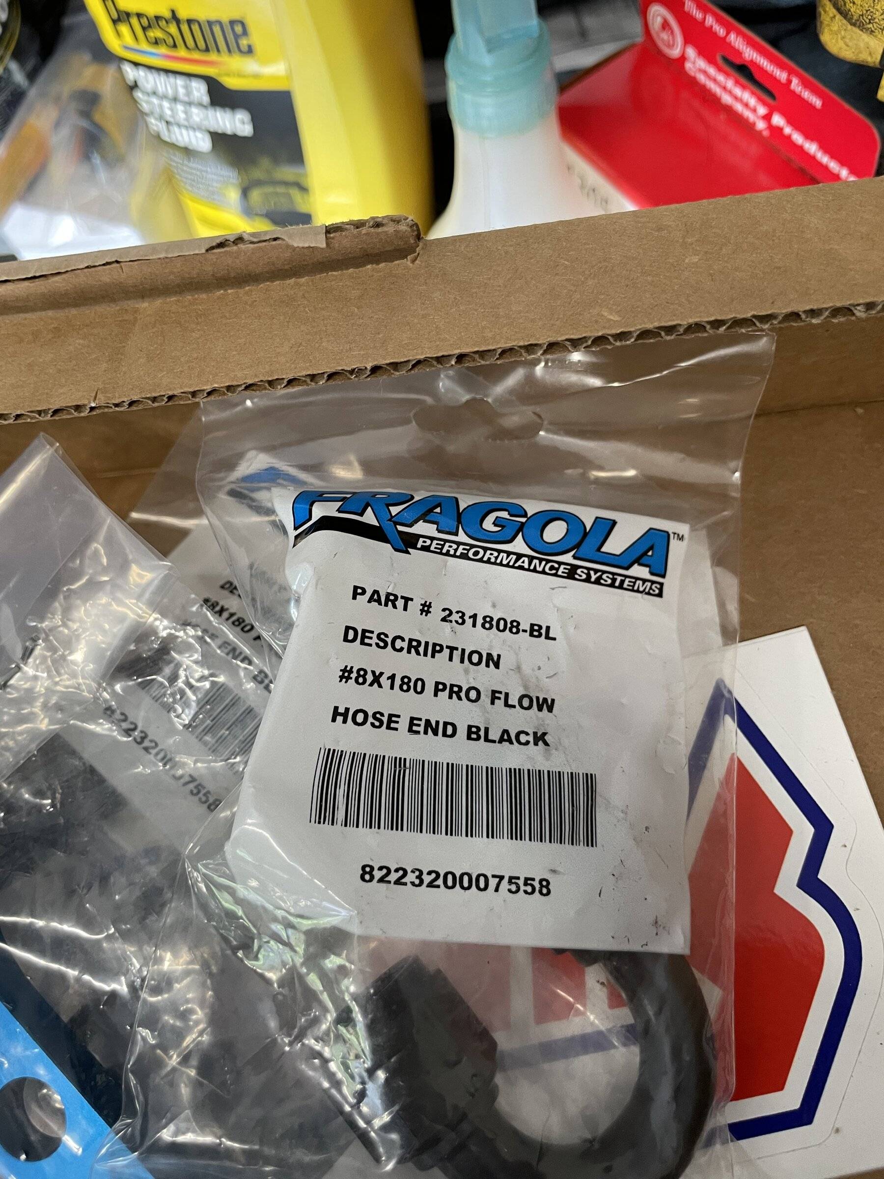

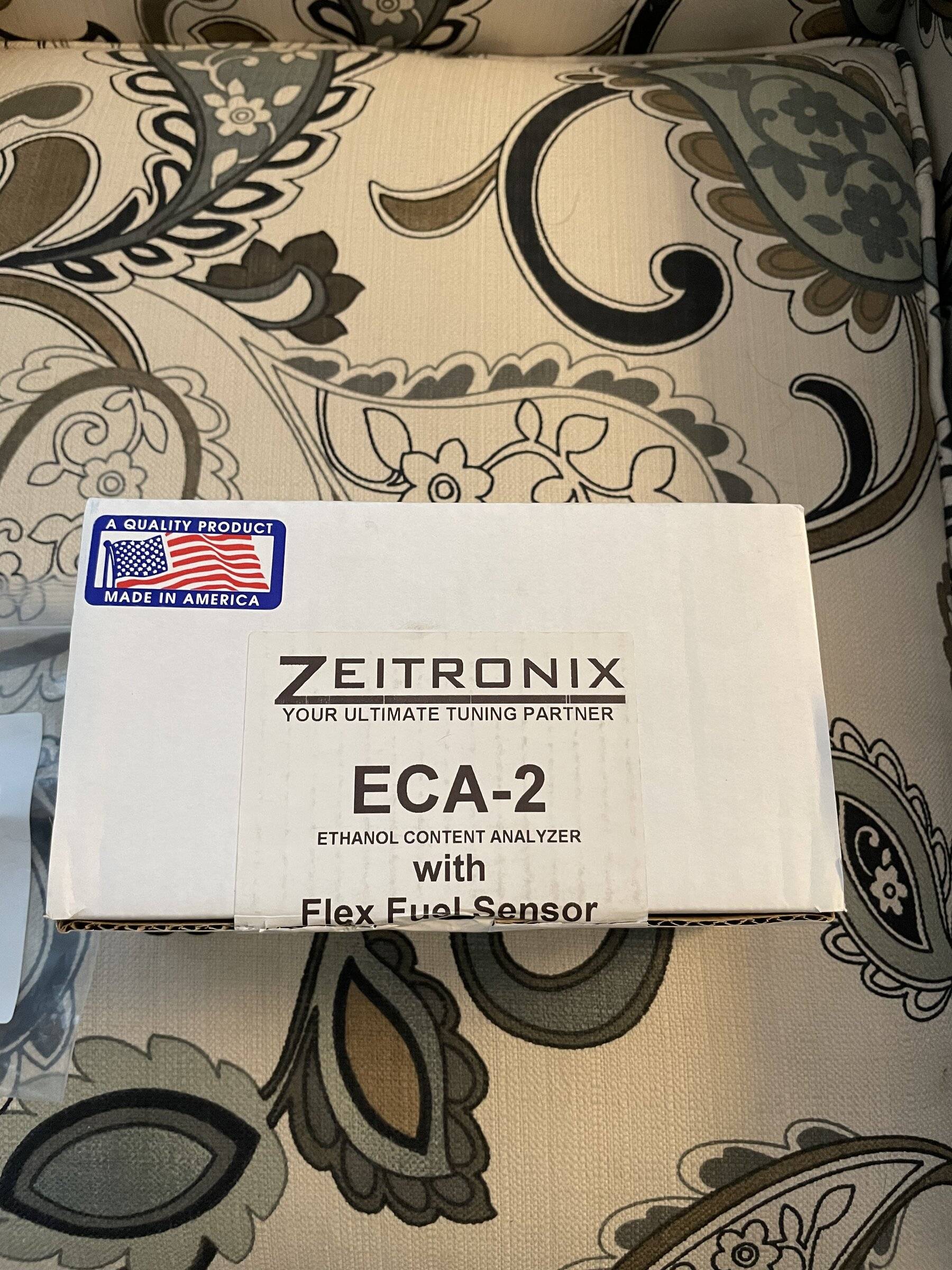

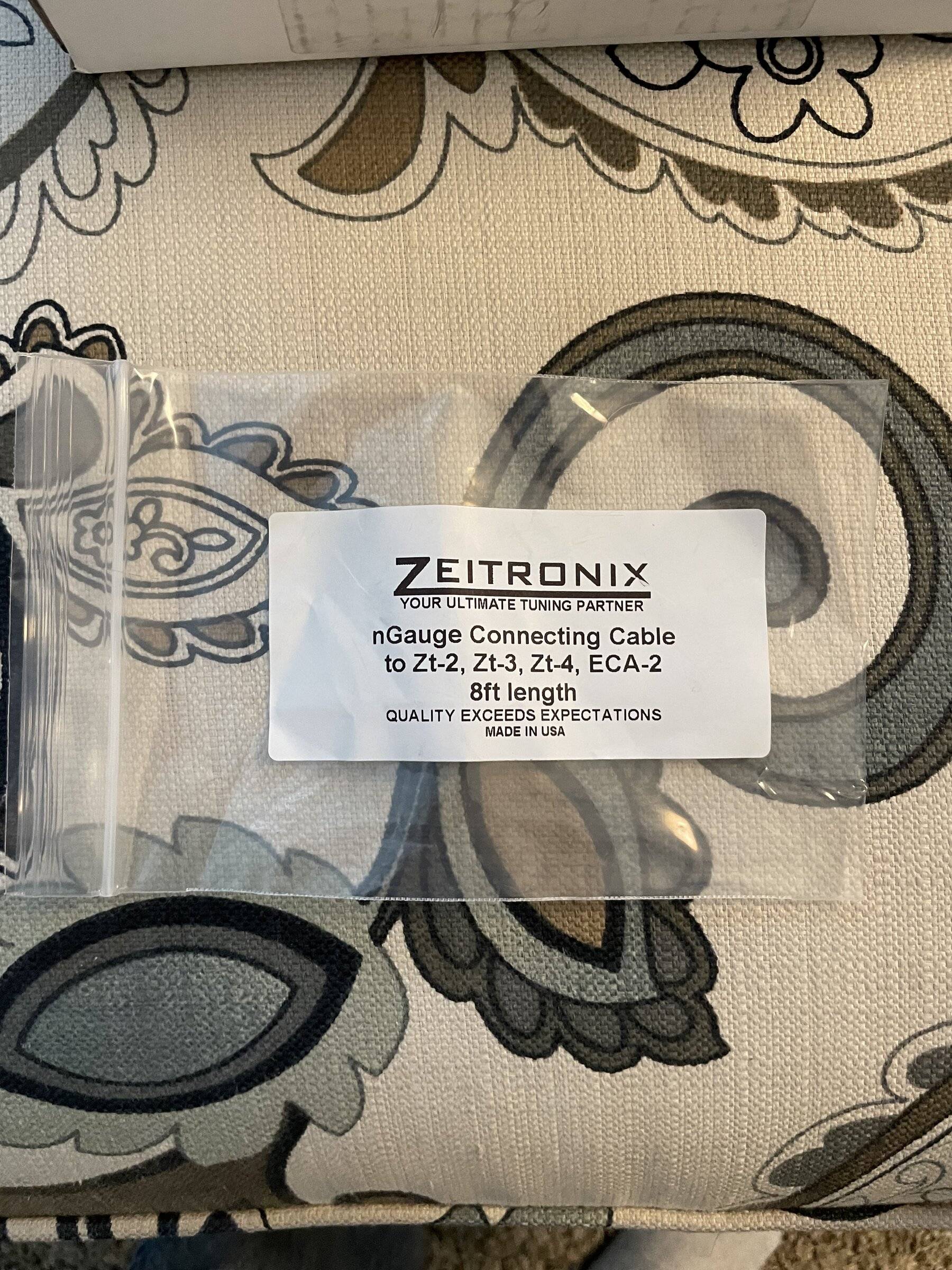

@guzie, which ethanol sensor and gauge kit did you install on your car? Got any pics of it that you can post here? Thanks
I did with my first GT350 when I did the investigation on how to set it all up. I had a earlier post on the board about it. On my current one I repeated the setup except for the ethanol sensor and gauge used. This time I went zeitronix kit. I got their controller and sensor which I wired the analog signal into my ngauge for the display. Since the ngauge crapped out on my during winter storage I bought a gauge from zeitronix and vent mounted that. Now I’m switching over to a SCT tuner for tune loading so I need to do the whole tune loading and data logging with 93 and then switch to E85. Here are some pics of my current setup. You need to make a custom fuel line setup to tie the sensor inline. You disconnect to line where it connects to the fuel rail hard line and sandwich the sensor in there, In my first go around i had used some clamp on fuel connect adapters and flexible fuel line from the local parts store to connect to the factory locking fitting. The fuel line with barbed fittings and hose clamps started leaking. I went to Fragola and got their stuff instead to make my own custom lines with their adapters and elbows. Much better and no leaks.

@guzie, nice work! When you routed a cable to your nGauge did it just plug into the unused cable port on the back of the nGauge?
