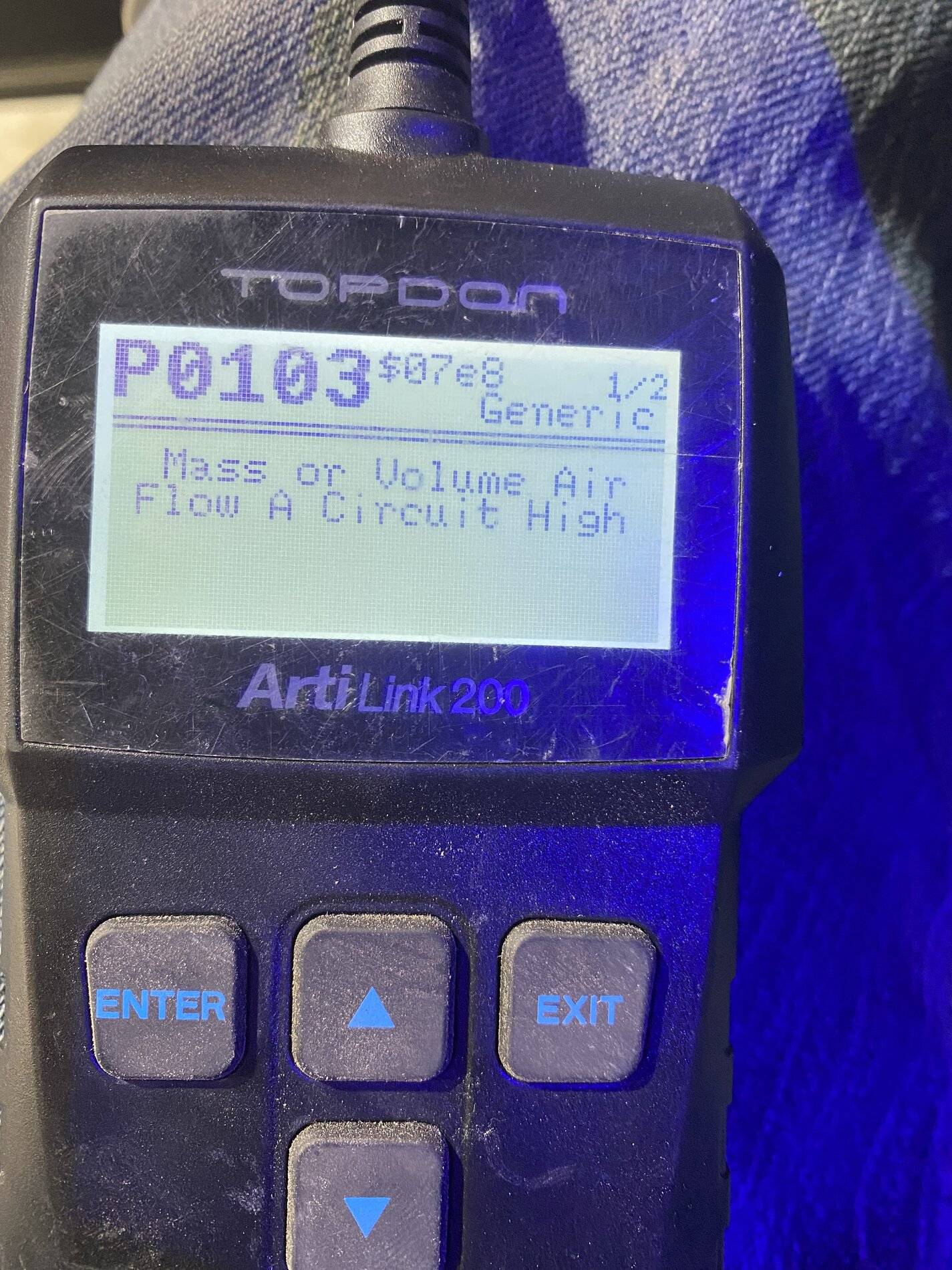

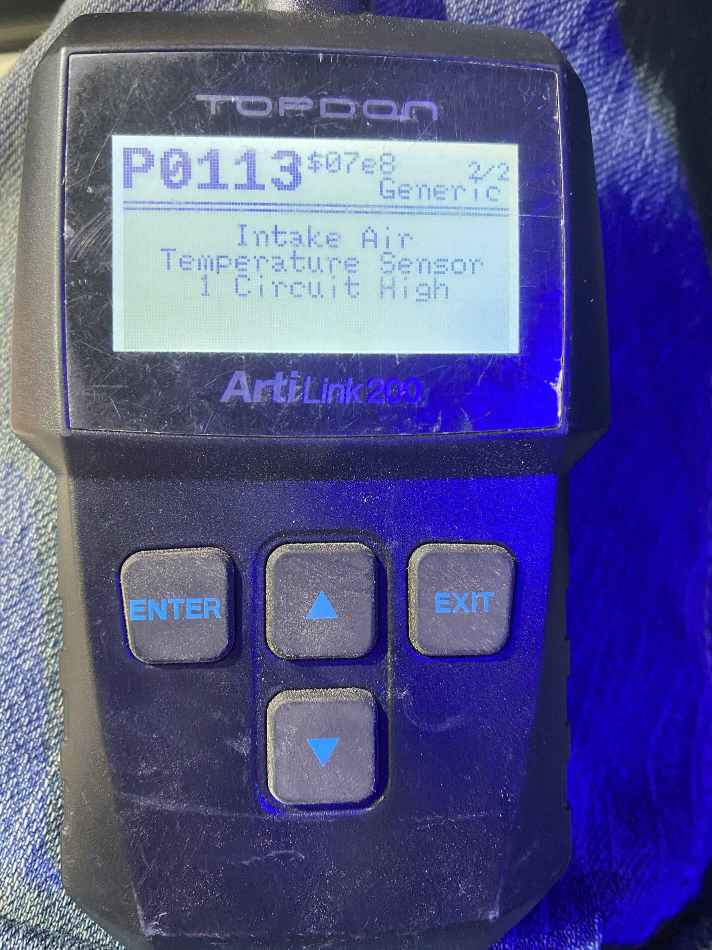

Leaving the battery disconnected didn’t work. Borrowed a obd reader and had two codes, P0113 and P0103. I cleared them with a scan tool and all is well.
