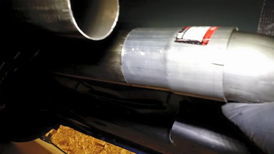

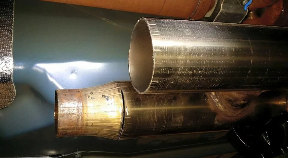

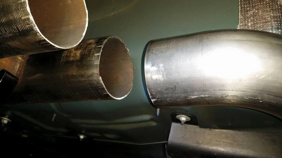

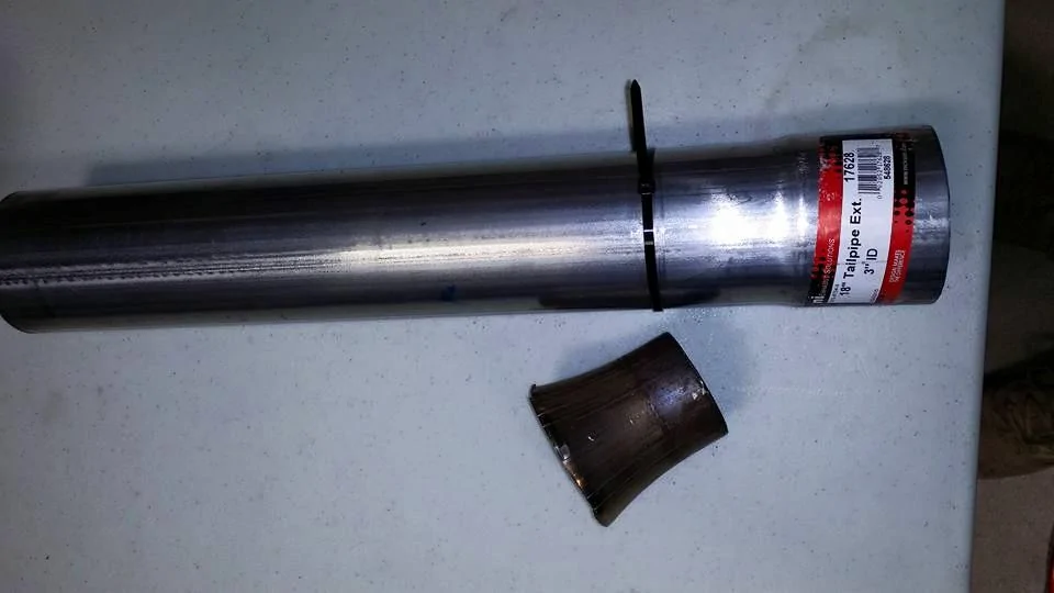

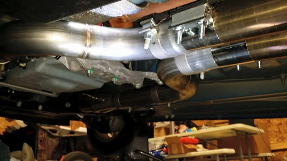

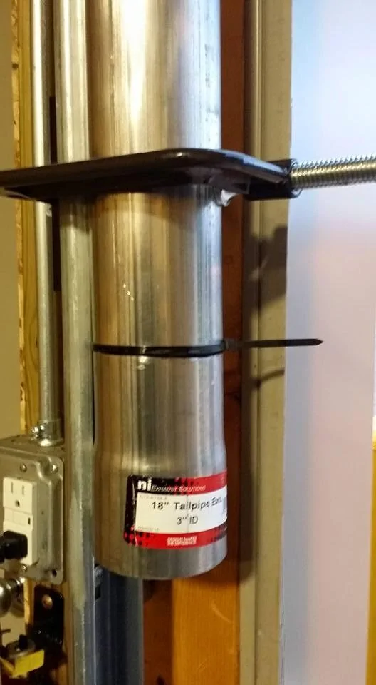

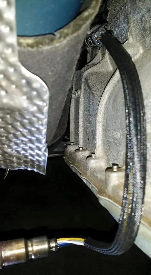

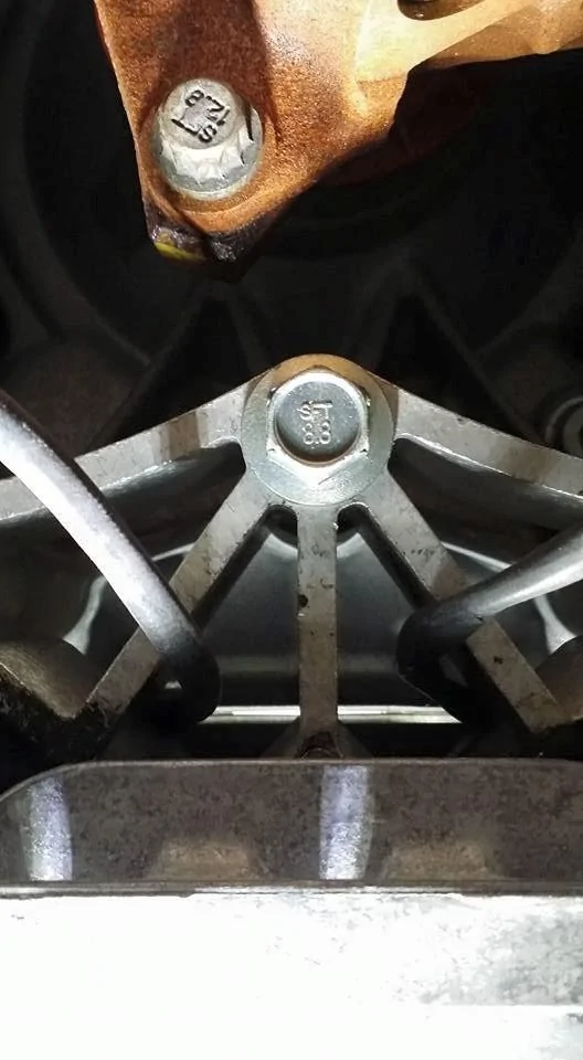

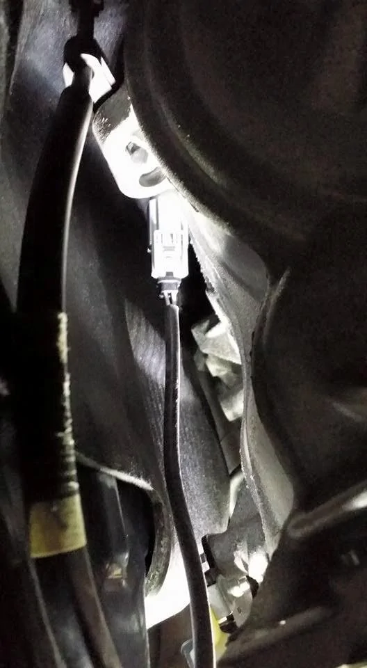

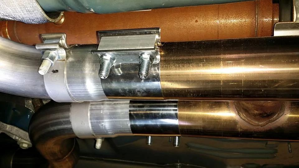

Okay my leads came in...BIG shout out to TEAM BEEFCAKE thanks! So time to get this thing done. You'll see where I cut off the reduced portion of my MBRP cat-back system, then mock up the lead with cat eliminator, at this point you can see we're ever so close, this is where the extra piece of pipe comes in. I hold the pipe to be cut up to the gap and mark where to cut, I use a tie wrap as a guide when cutting, I'm 1,400 miles from my shop so equipment is limited, I use a C clamp and garage door track as a pipe vise for cutting. Remember to put relief cuts into the expanded portion of the pipe (if it doesn't have any), this is what lets the exhaust clamp tighten down the pipe to the other pipe. I will finish up tomorrow, and then a trip to the track. The track I usually run at 131 MSP in Martin Michigan is not available this weekend, so I'll be running at Osceola in Indiana. Once I get back home I'll do some welding so that there's not so many clamps.

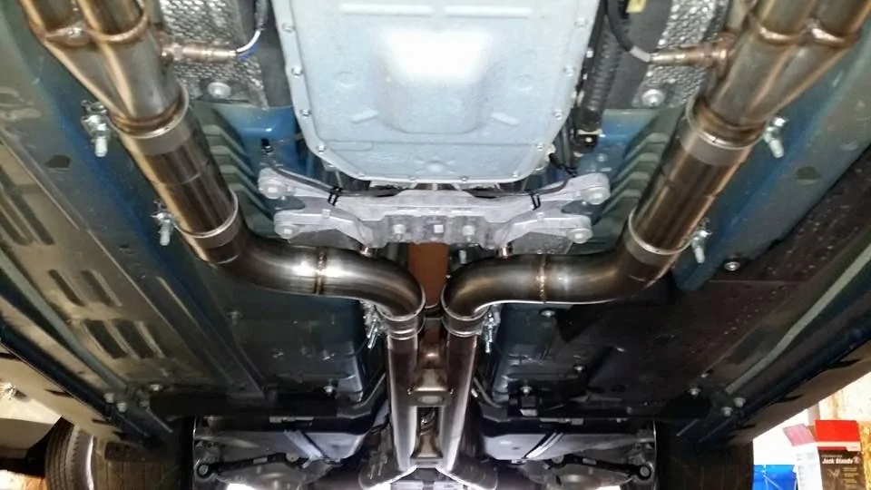

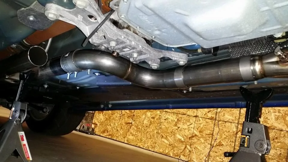

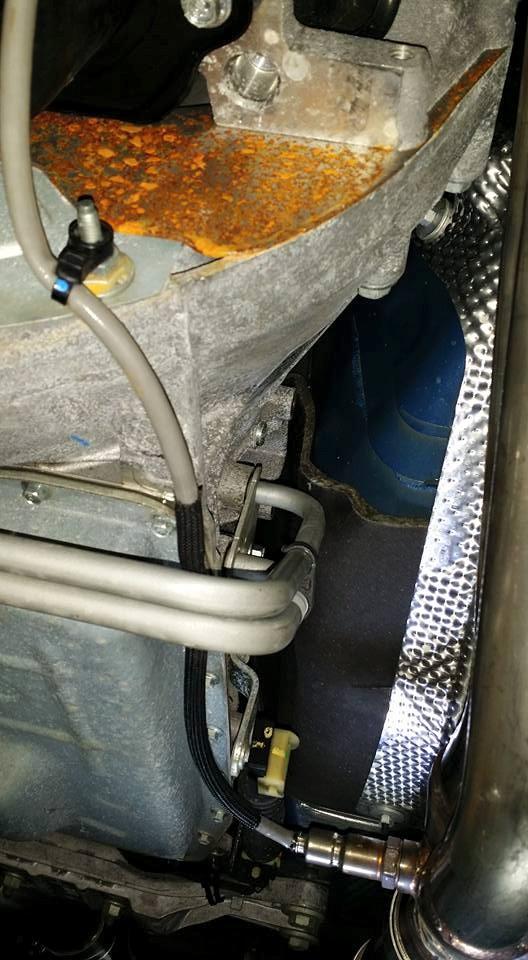

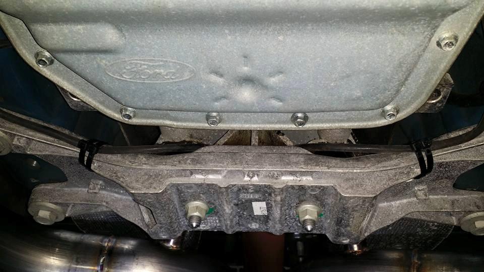

Ready to Rock

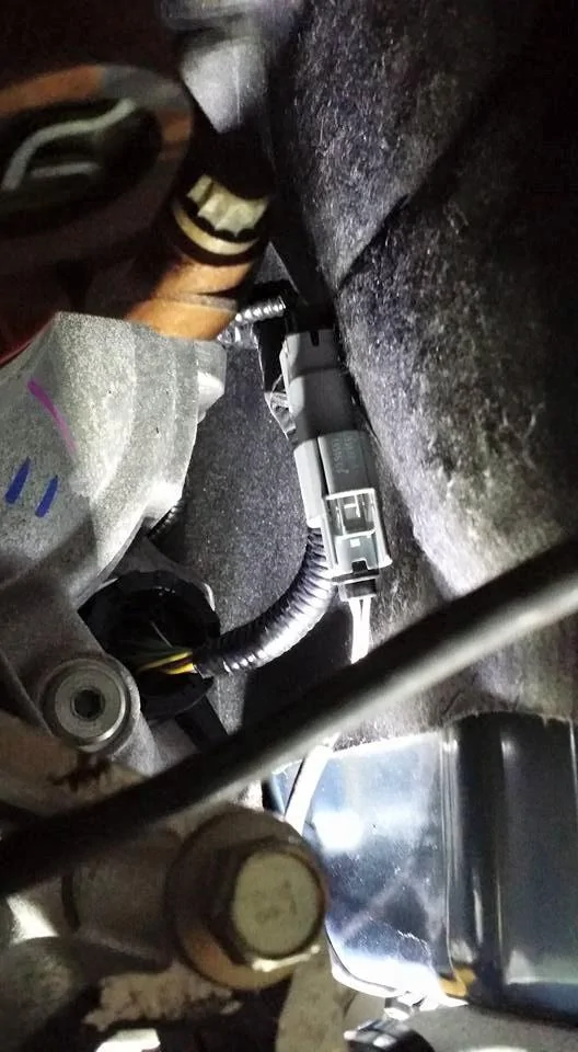

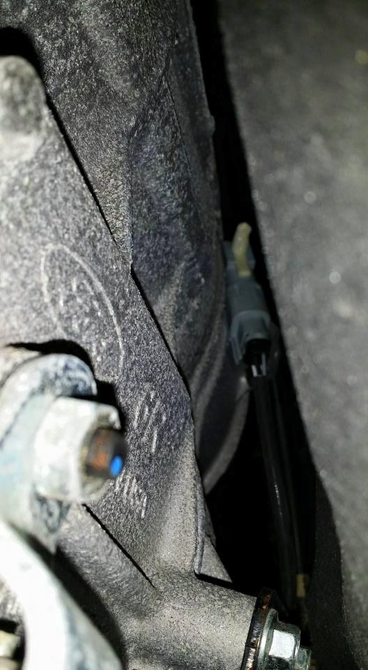

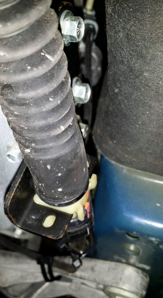

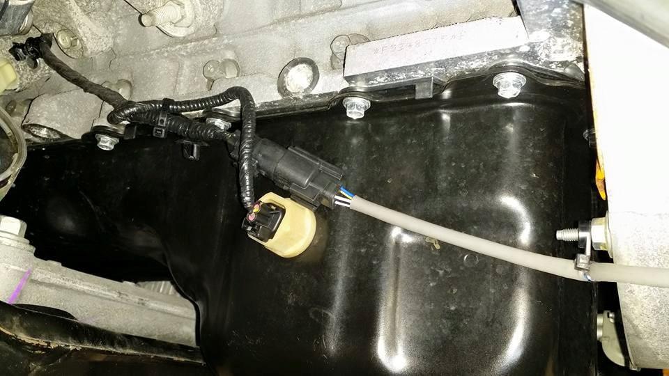

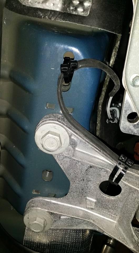

3" all the way...done! I also posted some wire routing pics. And earlier I listed the wrong size Torx for the steering column, the correct size is a T40. BIG THANKS to Team Beefcake for great customer service, and Stainless Works for a quality product and to both for working with me on getting the right parts for this somewhat custom job. :headbang: Now if the weather to holds out I can give you guys the results in the 1/4 mile. BTW I ordered a Schumacher battery maintainer, because Schumacher supports Drag Racing. Very important to have plenty of juice when down or uploading tunes....and remember don't touch the plug going to the OBD port, as you will wipe your cars processor clean....not good.
