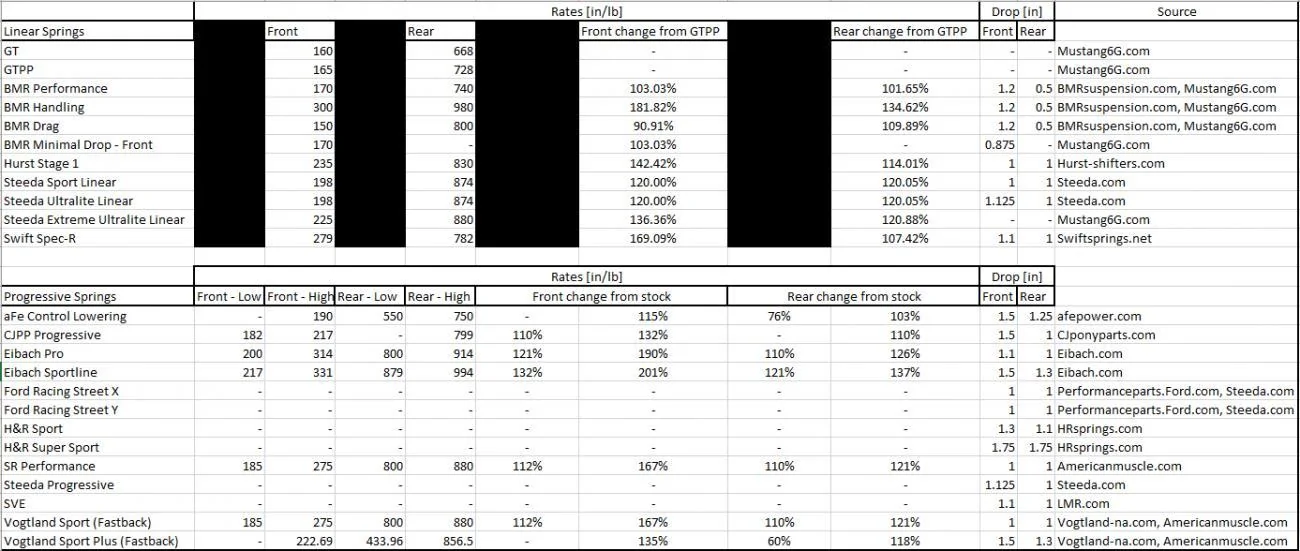

I decided to put everything into a spreadsheet regarding springs rates and drops. The spreadsheet divides springs into linear and progressive and shows the spring rate change as a percentage of the stock GTPP springs. I only included springs for the GT Fastback - no convertibles, EB, or V6. There's a column for the source of information as well. When multiple sources had conflicting info for rates or drops, I went with the manufacturer's info by default.
If you guys find any other springs out there that are available for our Mustangs feel free to let me know and I can update the spreadsheet. There's also some values that I just couldn't find on websites, so if anyone has concrete info on these that would be cool.

Curious to know the numbers on gt350r springs. Thanks for the sheet! Didn't realize the stock springs were linear, good to know. Probably read it and forgot.

This thread is awesome. Not only should it be sticky'd but it's completely changed my mind on the springs I was planning.
Thanks for the work @ Gibbo205 & dsp4848
[MENTION=11119]dsp4848[/MENTION] , Can you post the spreadsheet online somewhere? Not would it be available conveniently to forum members, but it would always be the latest version each time you update it.

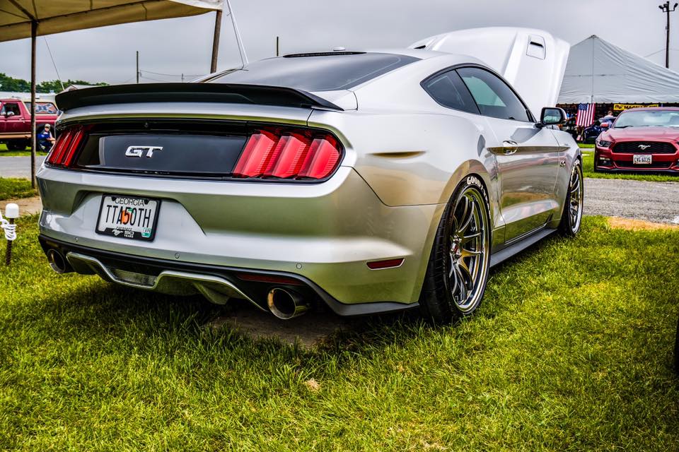

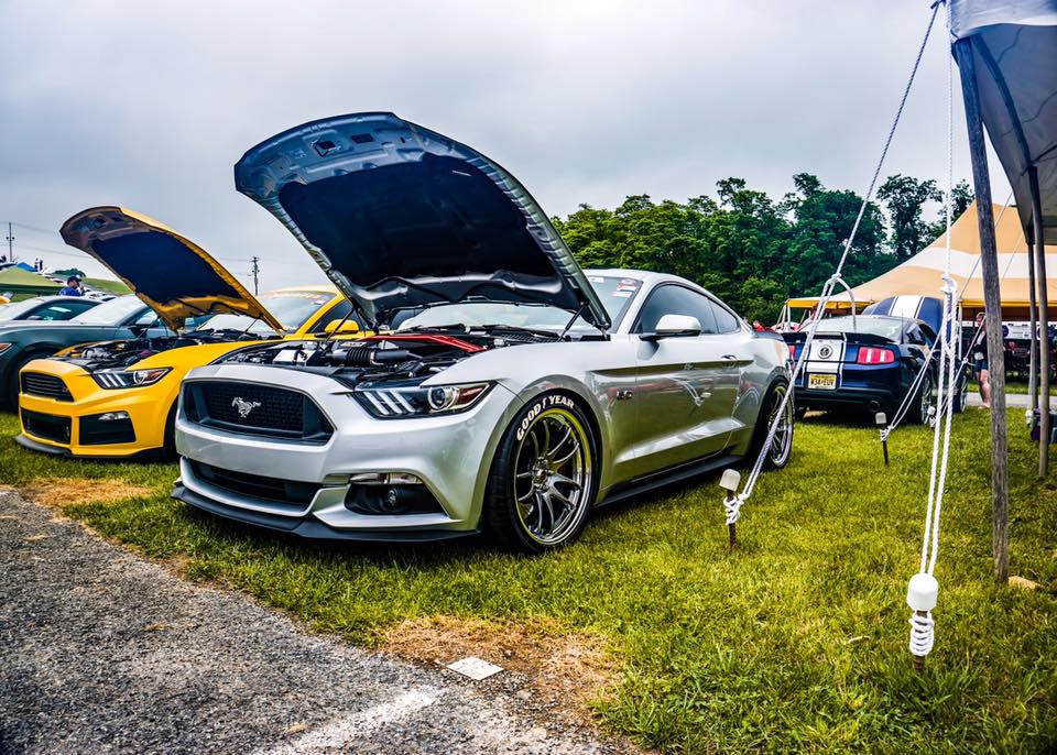

My car with 20's sets 1/8-1/4" higher in the rear. I just measured the height on my garage floor that is perfectly level. The rear is 27 5/8" and the front is 27.5"
Here are pictures of my car showing the level ride height. These springs with the koni's are the perfect match. So much adjustability with the Koni which make them perfect for long trips, aggressive mountain runs or track day/autoX events.
